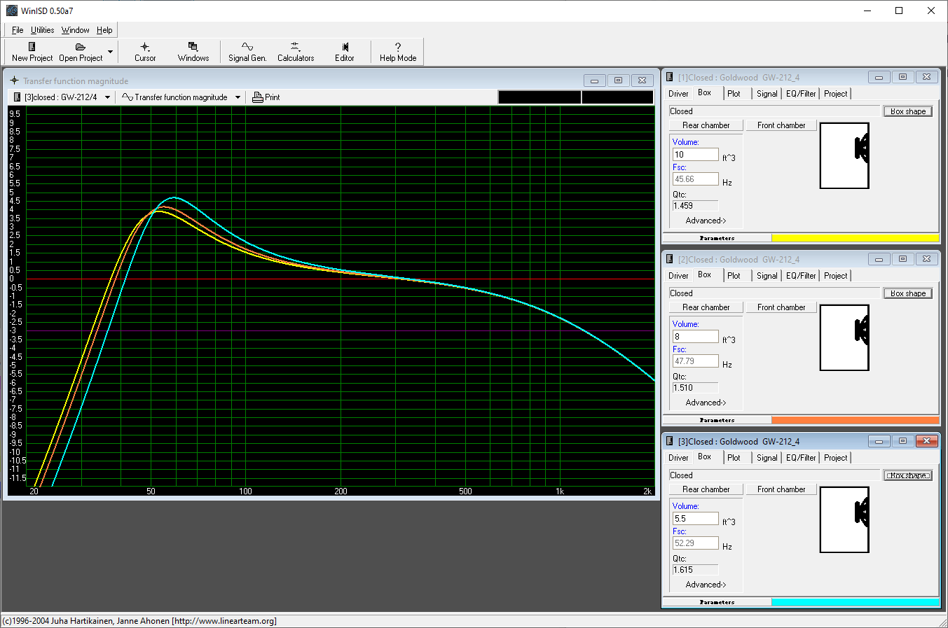

High Qts
So open baffle is a option.
helps with what would be a very large box.
Real trick is very wide baffle for better bass.
For sealed in a enclosure.
Take a big guess the PE sim is silly.
2 cubic feet would be seem like very
high Qtc. To get somewhere flat
assume 3 to 5 cubic feet.
But why guess, can do a quick breakdown
in sim. with what im guessing 1 to 1.5 Qtc
being feasible with large box.
Great thing about high Qts low cost.
Everyone will peeve and poo pee doo.
about them.
Find a decent trade off and run them
LOL.
far as i remember, data sheet says
280 to 300 liters was what it was tested
at. about all yah get.

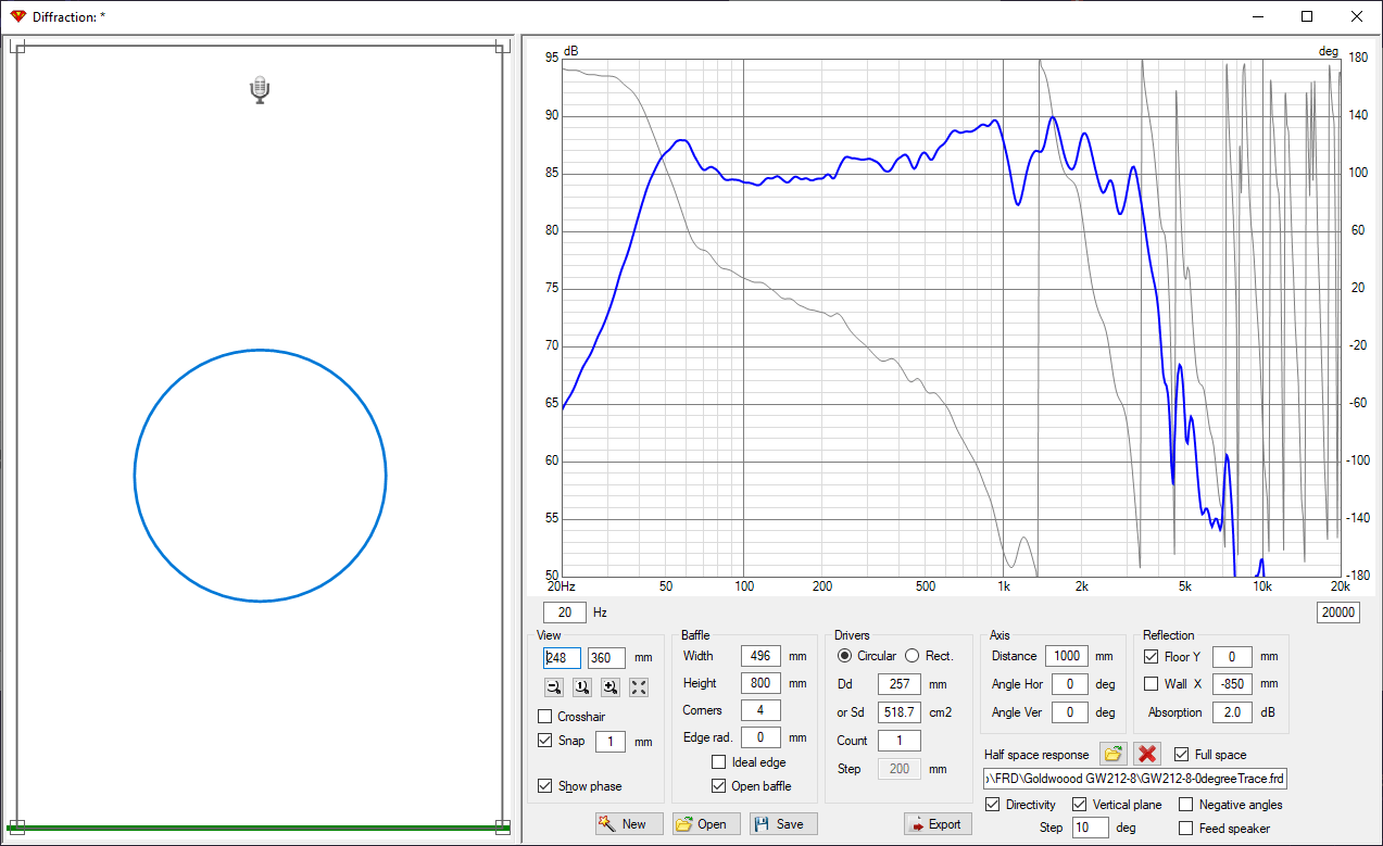

open baffle very feasible.

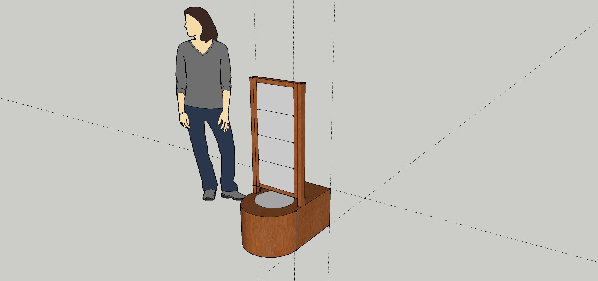

I appreciate the frank comments and help. My wife is not super into hifi. She wants bass to supplement the DMLs I built her, but doesn't want to take up a large space in her room. She doesn't really know any more than the DML panels are not adequate bass.
I don't want to waste time trying to force a square peg into a round hole, so I may just abandon these GRS woofers. What would you all do for this case?
Dont know the size of your panels.What would you all do for this case?
Rough idea incorporated as a base
But would do sealed, low to the floor
pointed straight up.
5.5 to 6 cubic feet.
Sounds large, footprint really
aint that bad actually.
Stay low plenty of space.
Or open baffle shown in previous sim.

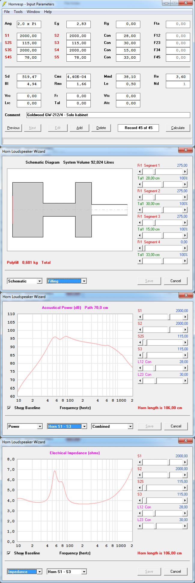

Iam working on a FAST/WAW project. Funds are limited, so plan is to use affordable driver with high Qts. So I found a solution based on Visaton Solo 50 cabinet which allows fairly small box with such drivers. Two chambers tuned and damped in such a way that unwanted peak is reduced and distributed over wider range.
This is Hornresp sim with Goldwood driver in question, box net volume is around 90 Liters (3,2 cuft). Sim shows in following order: general data, schematics and damping, response, impedance. Impedance peak of only 7 ohms clearly shows aperiodic nature of the system.
If we take 92dB as a reference, there is 3dB gain between 50-120Hz, F3 is 39Hz with 2nd order rolloff like closed box. F10 is around 27Hz.
If you wish to try this, tomorrow I can post some quick drawings and details of possible box construction.
