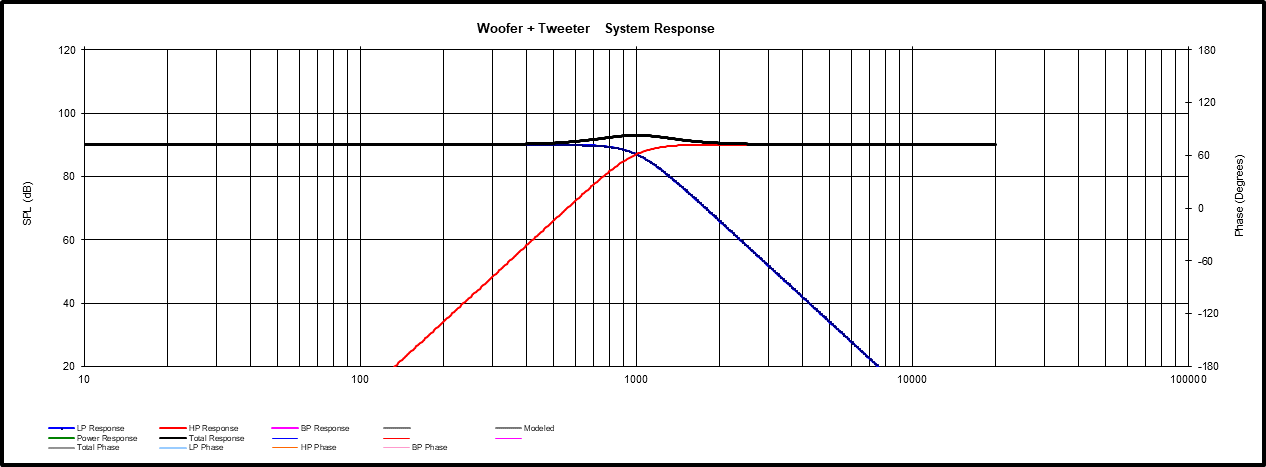

One of the funniest comedic techniques is to have two people arguing while discussing entirely different topics. A classic example is the famous Abbott and Costello skit about "Who's on First?" I'm discussing an electrical crossover and its characteristics, while you're talking about acoustical power.
Mr. Scottmoose keeps claiming that it's easy to create a Butterworth filter with constant impedance, but he hasn't provided an example to demonstrate this.

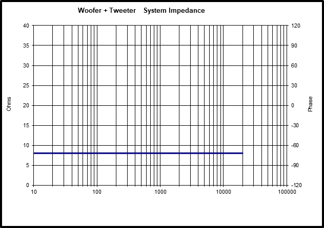

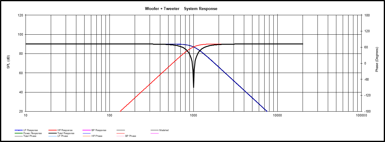

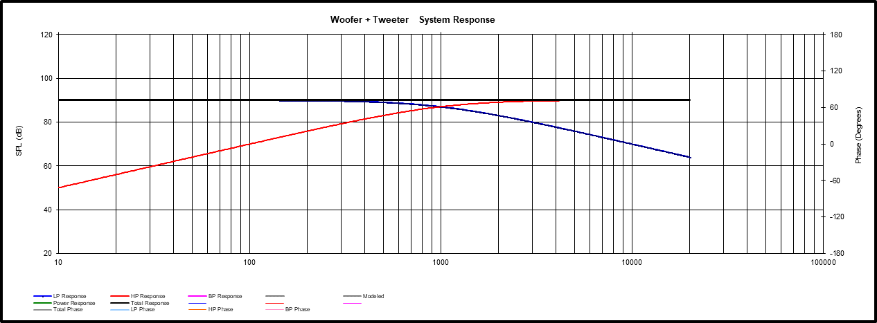

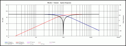

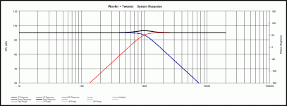

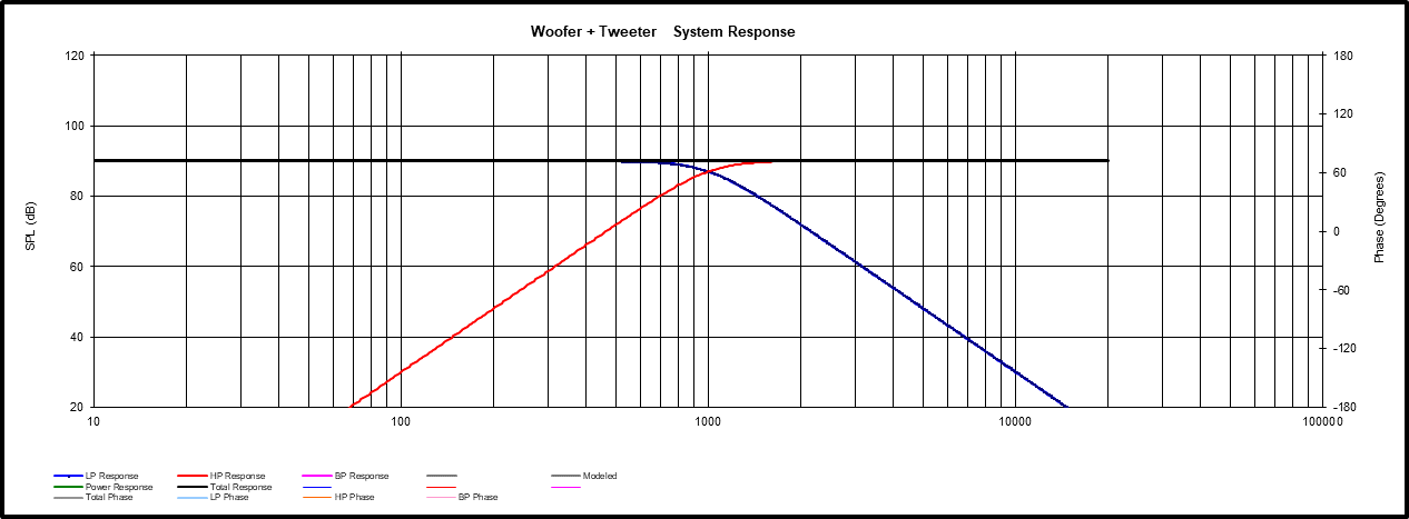

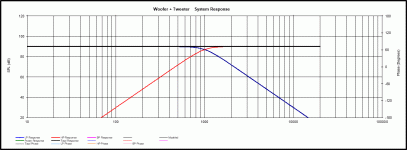

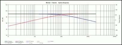

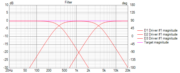

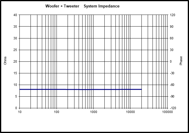

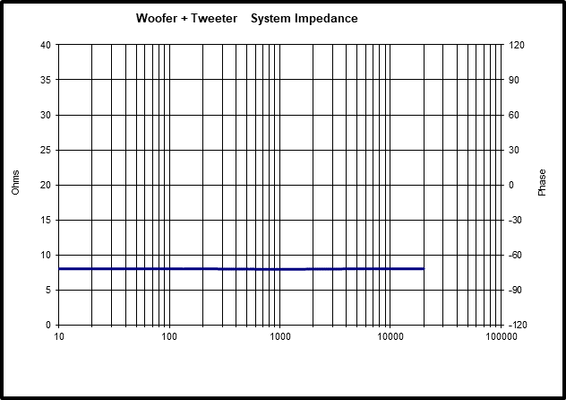

Er -a well-known and unremarkable trait of Butterworth filters with symmetrical corner frequencies is the fact that they sum to a flat impedance. I don't need to prove a thing: you're the one who is not only claiming something contrary to very basic electrical filter design, but also trying to pass off those self-same standard 2nd order electrical Butterworth filters as something different (while also claiming copyright).
For the benefit of any poor souls reading this and buying into the OP's twaddle however: FR (both polarities) and impedance of electrical 1st, 2nd, 3rd & 4th order Butterworth filters with a 1KHz corner into a resistive 8ohm load. Yes -astonishing revelation: a symmetric Butterworth filter electrically speaking sums to a flat impedance (and FR, whichever polarity). Be still my heart. 🙄
I eagerly look forward to seeing which way the OP will now try to claim these are somehow 'invalid'. It'll be interesting, no doubt. 🤣

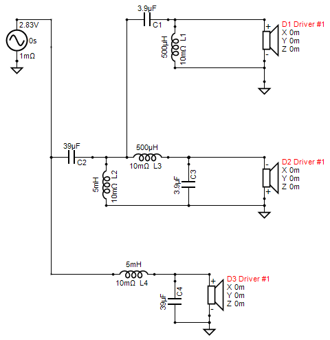

Just to underline the point here:
In post 01, the OP states symmetrical corner frequencies of 350Hz and 3.5KHz. He doesn't specify the impedance other than it is static resistive, and it doesn't exactly take much working out that it's a nominal 8ohm. The filter values for this 'copyrighted', very definitely not basic, symmetric 2nd order electrical Butterworth filter values provided are:
L1 = 5.0 mH C1 = 39 uF
L2 = 5.0 mH C2 = 39 uF
L3 = 0.5 mH C3 = 3.9 uF
L4 = 0.5 mH C4 = 3.9 uF
Now, I wonder what the 2nd order Butterworth values for those might be, into a static 8ohm resistive load?
LP: 5.14mH, 40.19uF. Or, rounded to nearest commonly available standard component values, 5.0mH & 39uF.
BP: 40.19uF, 5.14mH & 0.51mH, 4.02uF. Or, rounded to nearest commonly available standard component values, 39uF, 5.0mH & 0.5mH, 3.9uF.
HP: 4.02uF & 0.51mH. aka 3.9uF and 0.5mH.

Is it possible that the OP's posts are (wholly or largely) AI generated, and this is all a bad joke?
Human troll, I would guess, unless AI has started on that game, in which case we're in for a merry time. 😉

So you think a symmetrical 2nd order 3 way filter topology using standard Butterworth values is ‘original’. That’s a novel argument. I don’t think anybody’s tried that one before 😂🤣
Original circuit?! ORIGINAL?!?!?! Are you serious?!?!?! Try to read some basic books for beginners...I create an original circuit and then copyright it.
And you copyrighted it?! You are hilarious!

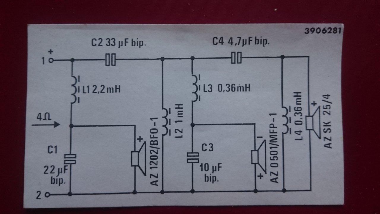

Here is the crossover from HSR140 loudspeaker which was popular in my country 50 years ago!!! 50 years ago!!!
Enjoy:
Your cruelty to animals (beating a dead horse) is unheard of!
Here is your "original" crossover (from post #1):
Optimum Crossover
I have developed what I believe is an exceptional audio crossover.
Schematic “Best Possible Passive Crossover”
(3-way 2nd order)
Copyright 2024
Robert Stanton
You copyrighted crossover 50 years old?! 🤣🤣🤣

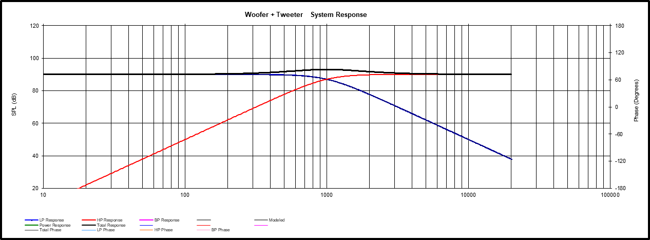

I noticed the adjustments you made to the crossover's component values to align them more closely with theoretical expectations. The changes are quite minor, and the most effective way to observe their impact on impedance is to analyze the S parameters of the crossover. I conducted a sweep of S11 and S21 from -20 Hz to 20 kHz. The worst return loss recorded was 51 dB at 3600 kHz. After that, I replaced the components with your suggested values and performed another S11 sweep. The return loss at 3600 kHz dropped to 45 dB. This indicates that the impedance shifted from 8.019 -j 0.39 with my values to 7.930 -j 0.56 with your suggested values. This crossover is already optimized, and any further modifications are likely to degrade its performance.
If you don't believe this is correct, would you care to show how?

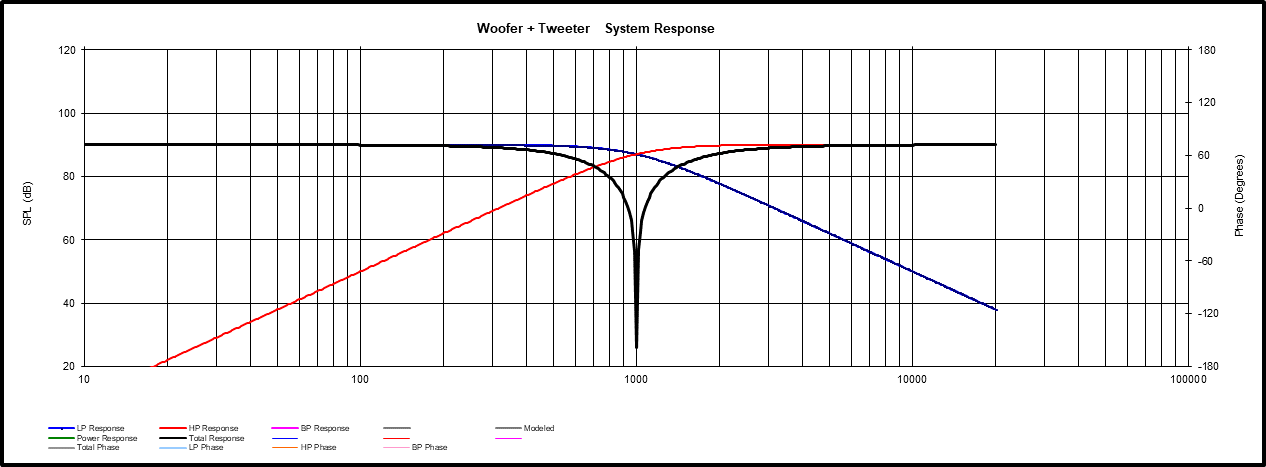

I knew what you meant.. it's shown clearly in the simulations. Thanks for the clarification.One minor edit re 63 above (lest the OP attempt to use it as a deflection): when I wrote 'and FR, whatever polarity' it is in reference to odd, not even order Butterworth filters. The time for editing expired before I could tweak that part, although if a mod could, well & good.

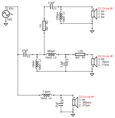

You made the small mistake (I assume) of moving the woofer and midrange voicecoil towards the mic / listener.Just for fun I put your design into VituixCAD and your filter is what you describe, however even with perfect 8 ohm concentric drivers the response isn't close to what you described.
positive Z is further away in VCad.
