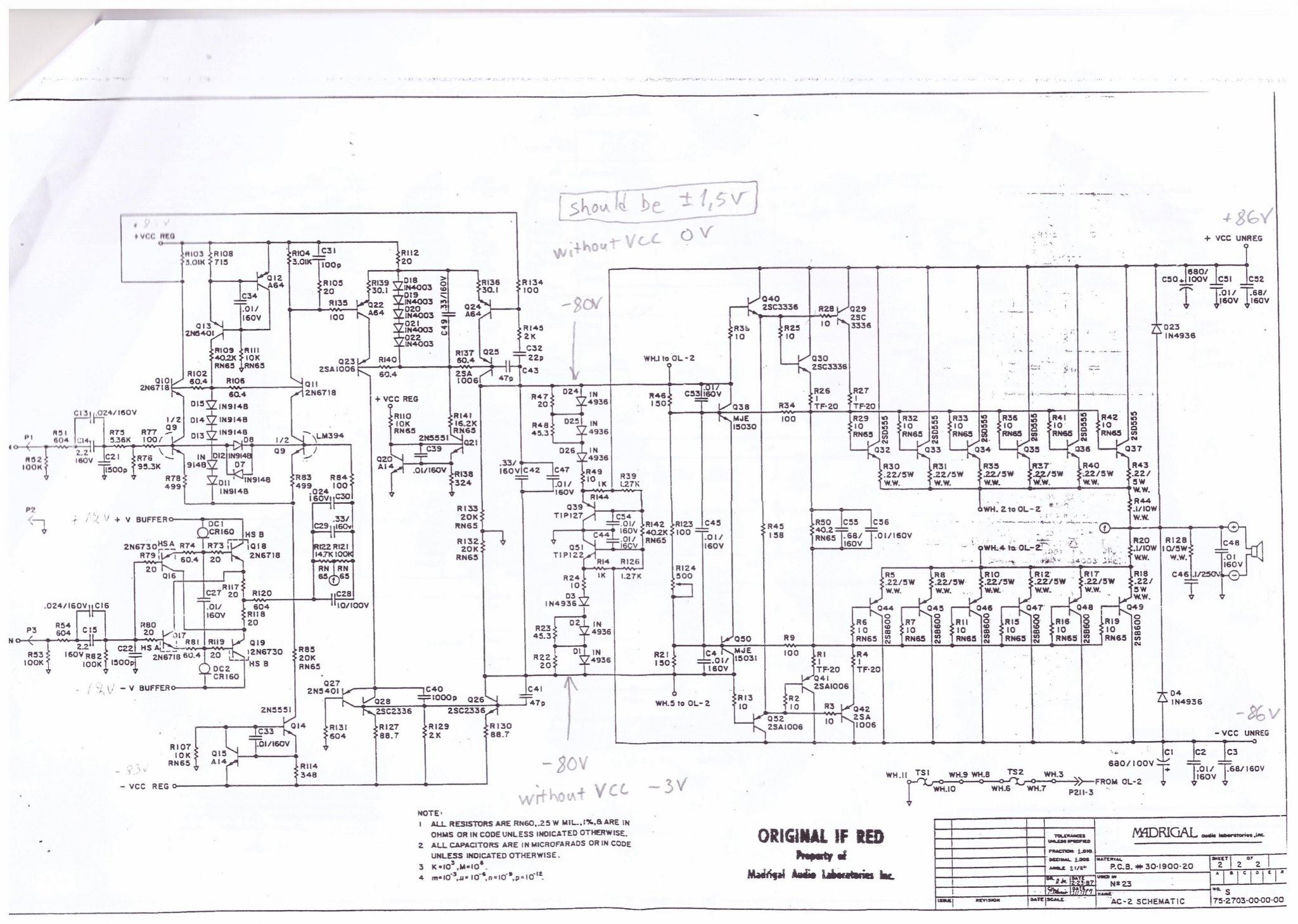

How works this Vbe multiplier from the circuit in the attachment from Mark Levinson/Madrigal ?

thank you very much for this information - I ask this question because a friend of me is owner of a damaged device with shorted output power transistors of this model from Mark Levinson.
Before ordering new devices I want to put this power amp into operation without the power output stage (i. e. only the front-end with Vbe multiplier drives the speakers - naturally in this kind I have a current control output with some mW power output).
This is the main step in my own troubleshooting procedure wich provide me a good protect to get additional shorted output transistors.
According the circuit description in post #57 follow prepare is necessary for getting this mode after removing the output (triplet follower) buffer:
1) node from R122/R121 together with speaker output terminals are to connect with C, Q25 resp. C, Q38
2) de-solder R49 and R24
If now DC conditions and idle currents in all stages from the front-end conclusive resp. according the showed values in schematic I will check the voltage range (bias) for the idle current in the output stage between C, Q25 and C, Q26 (must be between 3x0V45 and max 3x 0V75 for each half - i. e. between 1V35 and 2V25).
If this values are long time stable I connect speakers for sound check (extremely low level).
Let's see if I can do this and find the reason for the shorted power BjT's in the output buffer stage.
