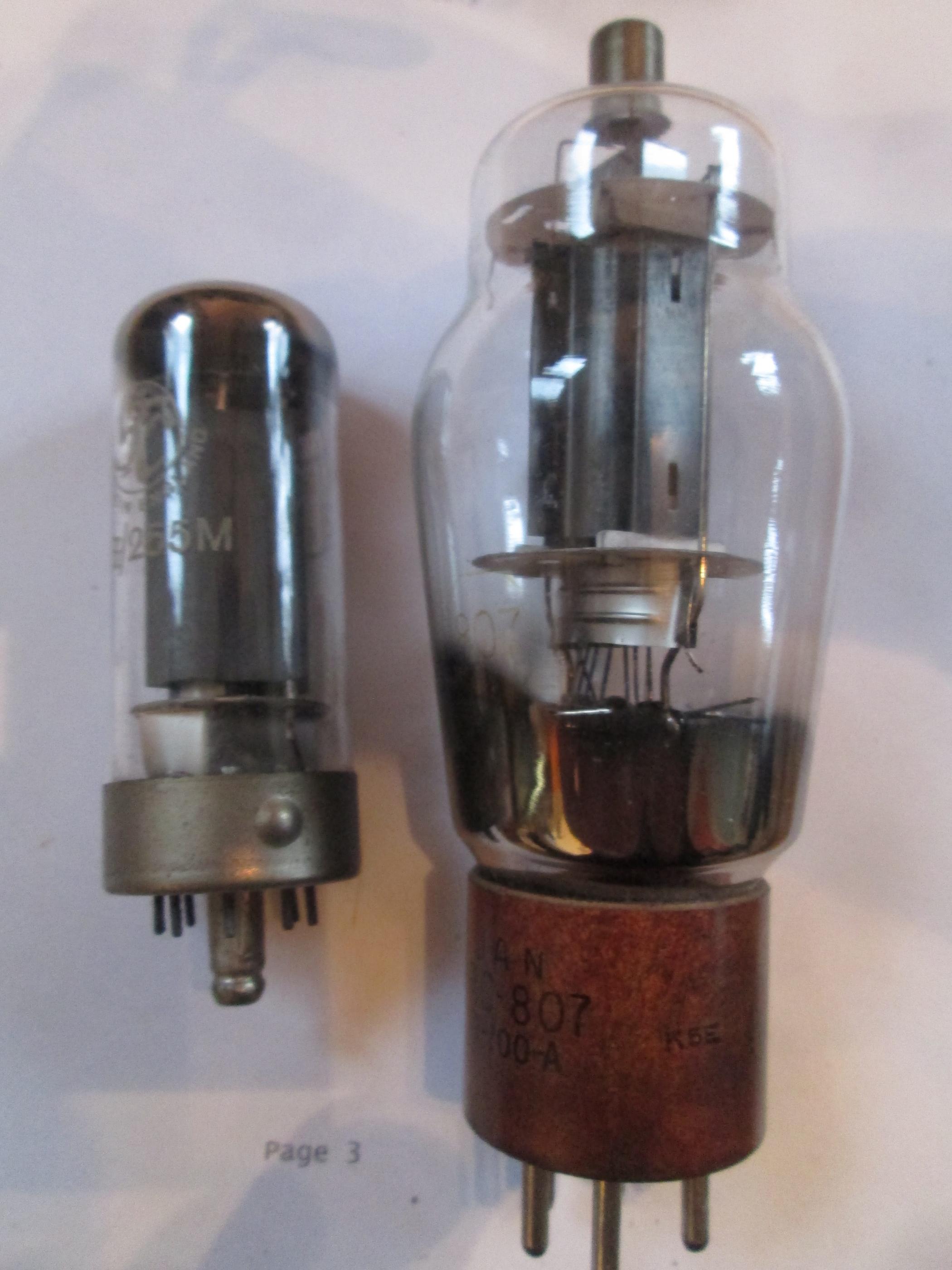

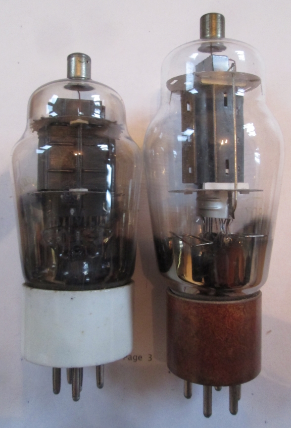

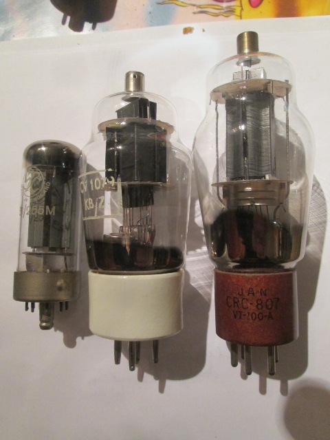

Then it's NOT damned well identical, is it!
Are you trying to be "smart"?
When was the last time you took one to bits??
You can see here they are identical to whichever flavour of 6L6 you fancy on that day.
Grey plates, black plates, or 6L6GC innards stuffed inside.
The 255M on the left without the TC, is a high voltage 6L6 with a loctal base.
You can run it at 800V, which I doubt you can manage with a 6L6GA or GC.
On the bottom right is a broken 807, one of the less common ones with 6L6GC guts compared with the normal one on the left of it. (that one had an internal short), the GC version on the right had the TC come off in my fingers.
The only thing that is not the same is the KT8, cos basically it's a high voltage KT66.
See the typical stumpy fat KT66 anode?
Happy now? 🙁
