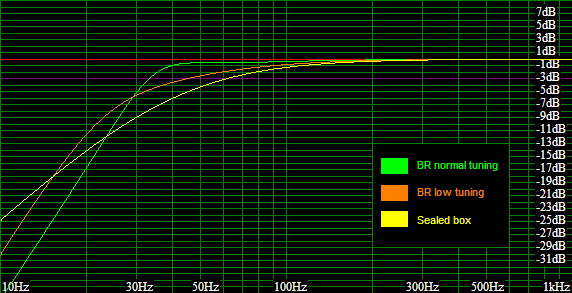

Earl, would a very low tuning on the mains, for a slow rollof starting at 100Hz, also be a solution, to gain a little bit of efficiency?
If the mains are sealed then there is a natural 12dB/oct hipass anyway. The bas are rolled off and need reinforcement to get to (or slightly above per Earl Geddes' recommendation) "unity".
A low Q closed box ("low tuning") is generally what I do, but I'm unclear by what you mean about "gain ... efficiency". The box design does not impact the passband efficiency, and a low Q has lower efficiency at resonance. SO I am not sure what you mean.
I mean a BR box bith an unusually low tuning, and a "banana" curve.
The efficiency gain I am talking about is in the LF.
Here is an example (the orange curve, same box size for all curves).
What is the drawback of such a box compared to a closed box?
The idea would be to include the mains into the mix a little bit more than with a closed box (something like 3 more dB in the LF). Bad idea?
No not a "bad" idea at all. BUT, if you look at the RMS cone displacement for a random signal (going well below cutoff) and compare it between the "low tuned" ported and the closed, you will likely find that the ported is something like twice as large. Yes, you get more output, but you also get more excursion - they go hand in hand - always. When operating a woofer over as large a bandwidth as I do, its a good idea to keep the excursion down. If you feel that you have "excursion to burn", then go for it! But if you can see the cone move then I suspect that the excursion is too high.

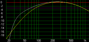

I was thinking of using a HP just under that low tuning frequency to prevent overexcursion.
In that case the excursion always remains lower than the sealed box.
Here is an example : magnitude and then excursion at 300W
