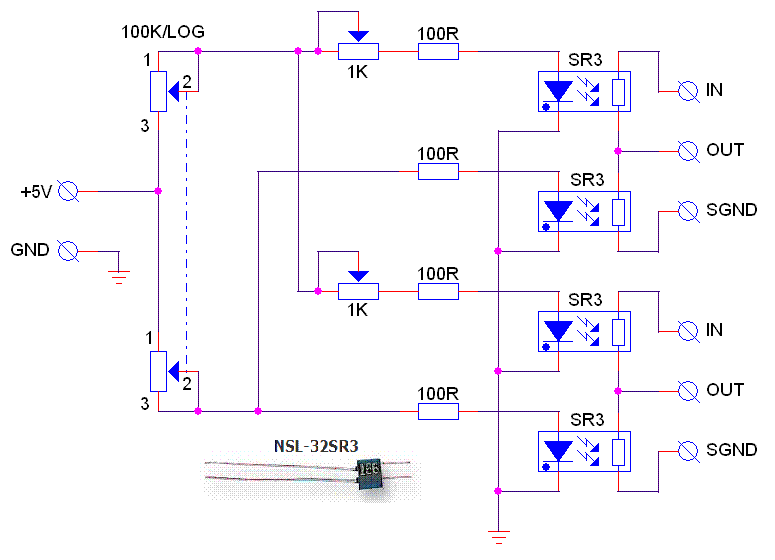

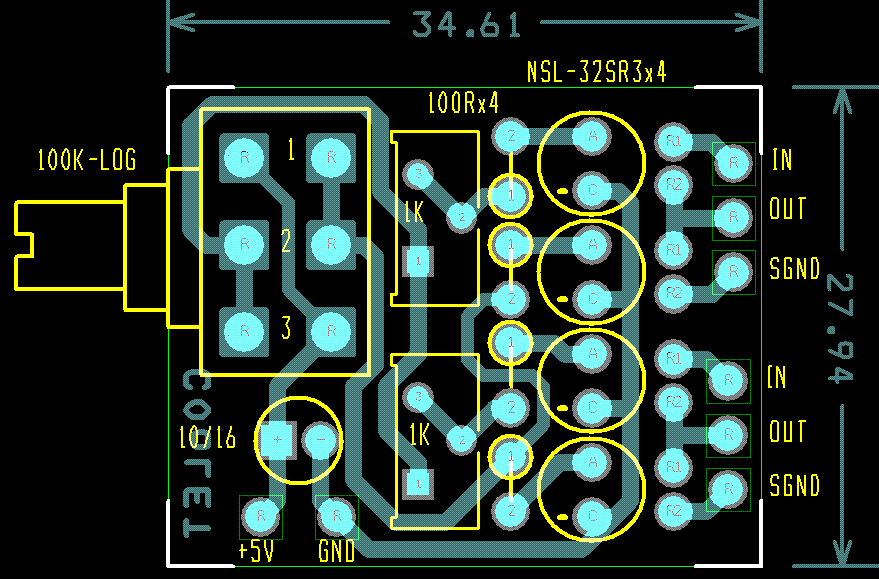

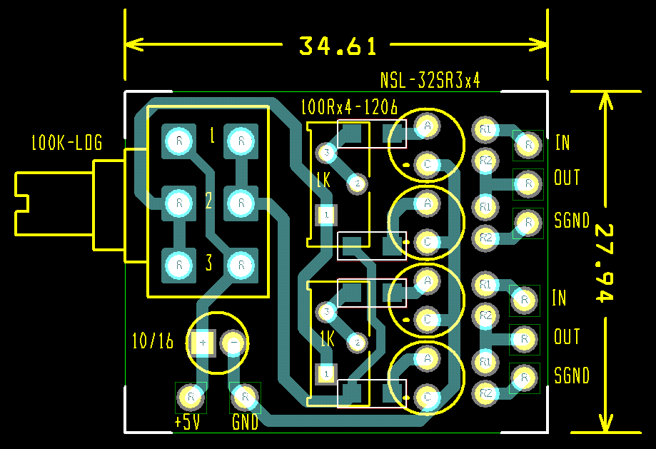

Just received my NSL-32SR3 and i want to share my layout. this was discuss somewhere here in the forum. 😉
