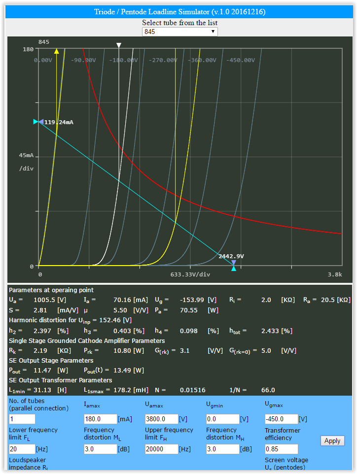

Since I purchased SE cad and don't know how to use it just put some data in it and got these result. At 15K software warns too high of plate impedance . Attached comparison data for you all experts to review. Can some one help me with the parameter Vin. What will be a nominal input voltage for 845 tube or how do you get it?
Looks like the Vin is the peak input voltage. The max input voltage you can apply in Class A1 (i.e. without entering the region where the grid becomes positive respect to the cathode) is the bias voltage.
However this comparsion is not representative of the actual amplifier because the Rdc and the nominal primary impedance don't tell much about the final performance. That's just the average tube distortion into a resistive load. Might be representative for midrange only.
Even so if you reduce the input voltage for the 7.5K load to match 7.5W ouput of the 15K load, distortion will decrease. Then if you adjust the quiscent condition for the 7.5K to a more convenient 900V/90V the difference will be even less and max output power still more than 15K case. Then, being dominant 2nd order, you can cancel it out with the driver 2nd order and get even better results!
In real amplifiers such differences will be pretty much irrelevant if the speakers are right. For example, those differences in STATIC (or small signal) damping factors are too small to make any real difference. If the speaker is right they will all be ok if the speaker is wrong none of them will be appropriate. The are pretty much the same from a practical point of view.
Valve amplifiers need dedicated speakers so that the bass alignment is correct (i.e. it takes into account actual output impedance) and speaker impedance should be as close as possible to a flat resistive value.
The reason why commercial manifacturers went with ultralow output impedance a long time ago and insist about its magic powers is that this way speakers and amplifiers can be designed separately making life easier and things cheaper with more income.....
They are equivalent. The 845 is low mu with lower plate impedance. These tubes, unlike most, display low distortion working on relatively low loads until they approach cutt off. For this reason load impedance makes less difference. The 211 has 2-2.5 times higher plate impedance and so typically will require higher primary load to get similar results.

Why you all insist in comparing very different primary loads with same plate voltage and same anode current? If it is optimal for one it will not be for the other....or compormised for both....
Anyway I can see that with 9K you get over 18W (loss included, I guess) and in the other case it doesn't do more than 11.5. You should also show what happens when the ouput power is the same at 11.5W.
Lundahl datasheets also show that the 9K transformer has 75H and the 20K has 70H! At low frequency there is no question that 9K will be far better....

Not so different from 10K. There is no written limit, it's more a matter of balance of all aspects.
Also exaggerating with the primary load plate efficiency becomes really low.
What if I go down to plate voltage of 800V?
What is the maximum power I can get from 845 tube?
In class A1, at 800V/90mA into 5K around 17-18W. As usual, depends on the quality of the tubes, transformer losses etc. If you buy Chinese 845's only premium tubes will get you there.
It has to be 5K. 45, can you please educate as how to calculate these values?
Get the datasheet, take the curves and draw the loadline. This will give an estimate at medium frequencies.
To get the loadline you need two points. The line equation is V=-RLoadI+V0.
You already have one point (i.e. anode current and voltage in quiscent conditions) so you only need another point which you can calculate from the equation above. Calculate V0 in the equation above: V0=RLoadIa+Va where Ia and Va are the anode and plate voltage you want to use.
Now that you know V0 you can use as second point the intercept with the voltage axis. Set I=0 in the original equation and this is precisely V0!
In summary you need two points (Va;Ia) and (V0;0). Once you have them draw the line across the full plane.
Then you apply a symmetric voltage swing respect to the quiescent point and see where the loadline intercepts the tube curves with the applied grid voltage. For example, you have -100V bias. Then you apply +/-100V. You need to find where the line intersecs the tube curves correponding to grid voltages equal to 0 and -200V. These two new points will give max and min voltage and max and min current. The RMS power is Pout=[(Vmax-Vmin)*(Imax-Imin)]/8000
The factor 8000 comes from the fact that voltage is in volts and currents are in mA (so you need to turn the current into A) and are using peak-to-peak values for both voltage and current (the need to be converted in RMS). The factor 8 is indeed two times 2*SQRT(2).
