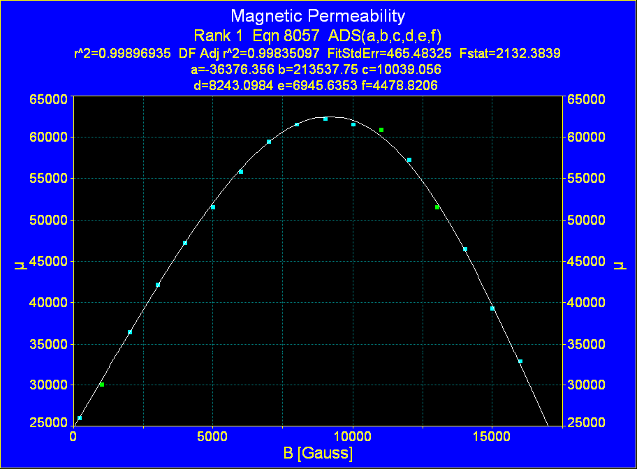

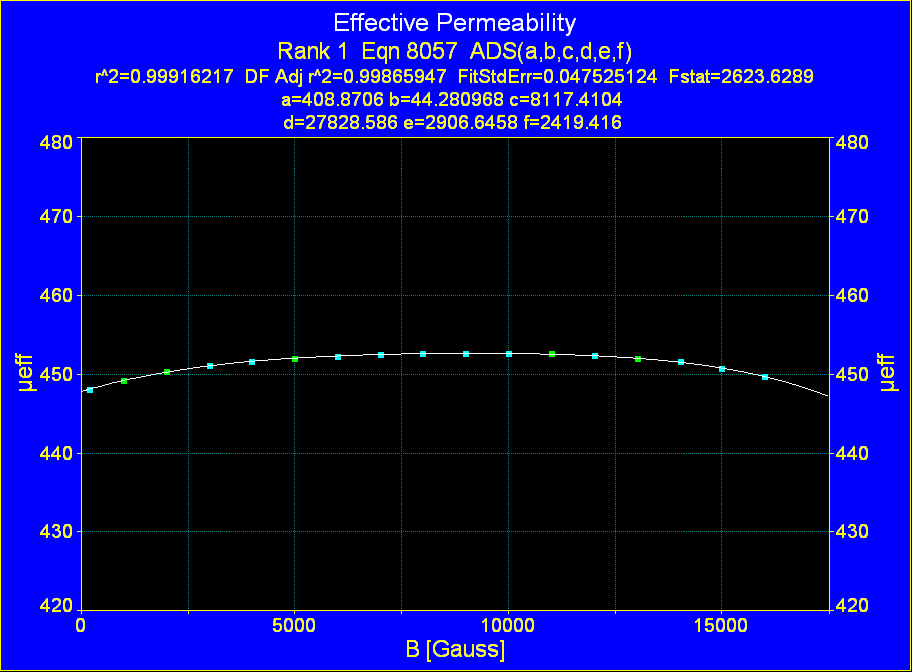

In a well designed and properly wound SE transformer this is not strictly true.

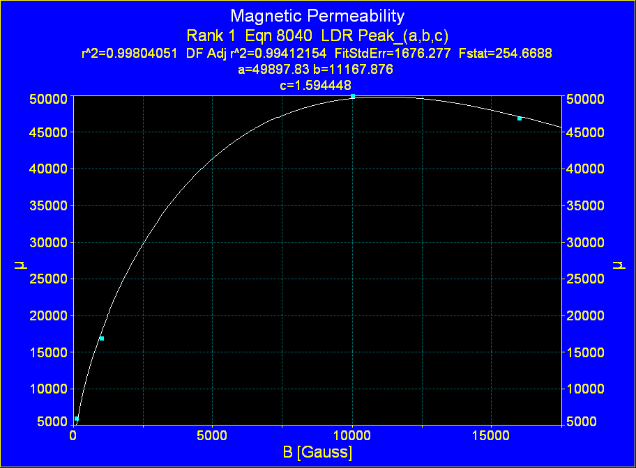

Primary inductance is given by
Lp = (4 π μeff S Np²) / (9 l x 10⁸)
And
μeff = lm μ / (lm + lgap μ)
The most common lamination used here is called EI155, its magnetic circuit length is
lm = 22.8 cm
For an air gap of 0.25 mm
lgap = 0.05 cm
For a standard M6 lamination, sorry only 4 points in EDCOR web page
For a super duper Japanese low loss lamination, sorry I do not remember its code name, just google Nippon Steel & Sumitomo Metal.

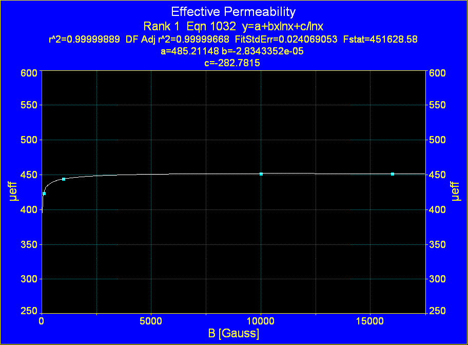

Doing calculations, for the core with standard M6 lamination
Doing calculations for the core with Japanese lamination
Having into account the DC magnetic field, say about BDC=5000 Gauss, in the range of 5000 Gauss up to 12500 Gauss, for standard M6 core is
μeff ≈ 452
For the core with Japanese lamination
μeff ≈ 452
Surprise surprise, magnetic permeability and hence primary inductance is almost the same, regardless core "quality" 😉

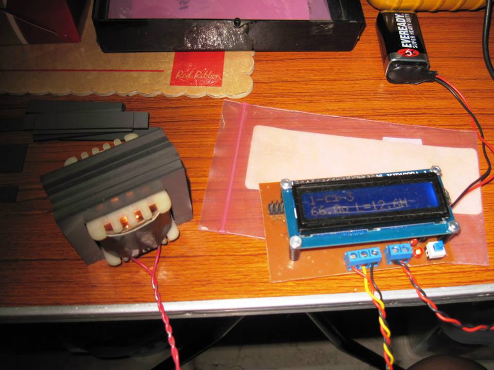

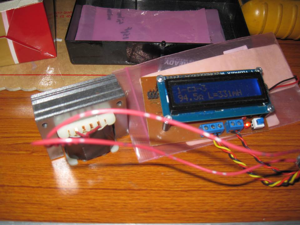

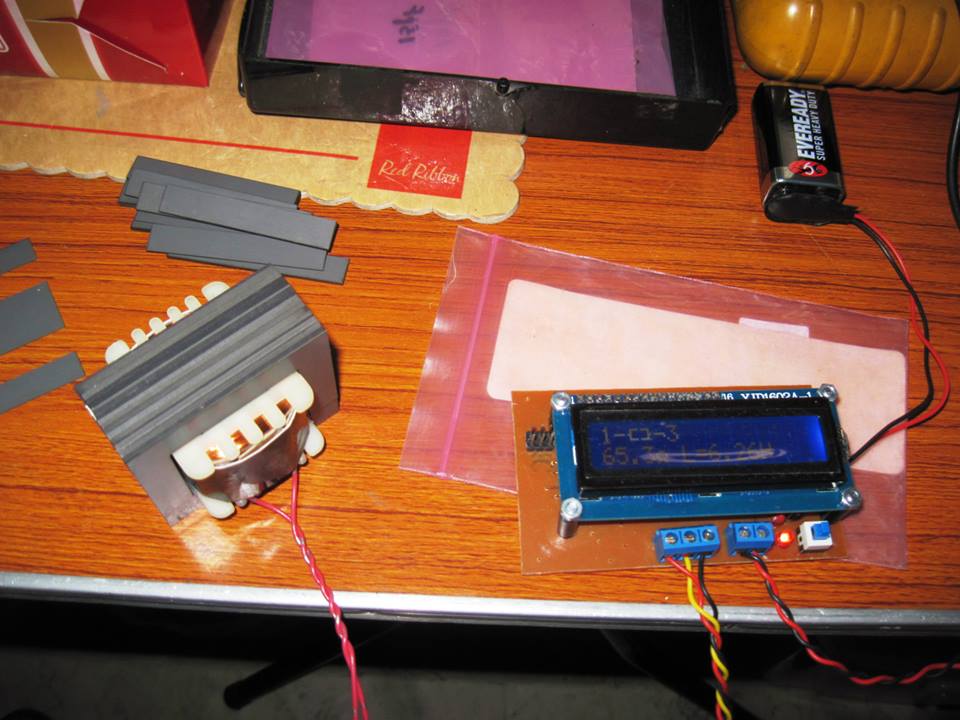

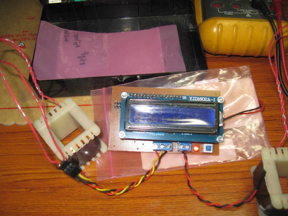

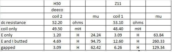

this is an actual comparative testing i did comparing M6/z11 tp h50 irons...
quality of the core matters, all else being equal....
i) We are talking about SE transformers, not chokes, so a proper measurement wil be done with...er...a SE transformer.
ii) Primary inductance must be measured with both DC and low frequency AC flow, at transformer specs.
If you are measuring inductance with an LCR meter at high frequency, without the DC component, the AC magnetic field will be too low because
Bac = (Uac x 10⁸) / (√2 π f S Np)
Frequency is in the denominator, so if it is high, the magnetic field will be too low.
In the numerator you has the primary voltage, usually in the order of hundreds volts, but I just can see a 9V battery, then the magnetic field will be even lower.
At such lower magnetic field you are measuring into a region with huge differences in magnetic permeability, and the air gap does not equalizing it anymore.
Conclusion: You are comparing apples with oranges, and with all due respect your measurements are very poorly made, even it can be seen a photo with the value L=331mH which is not tabulated.
Hint: Do a proper measurement, with a SE transformer, at say Bac=Bdc=5000Gauss, with a lower frequency (50Hz/60Hz is fine) and the rated primary voltage, then you would compare apples with apples. 🙄
i was comparing a low quality iron with a good quality iron,
no matter how flawed my method was, it showed a difference...
and that is all that mattered to me....

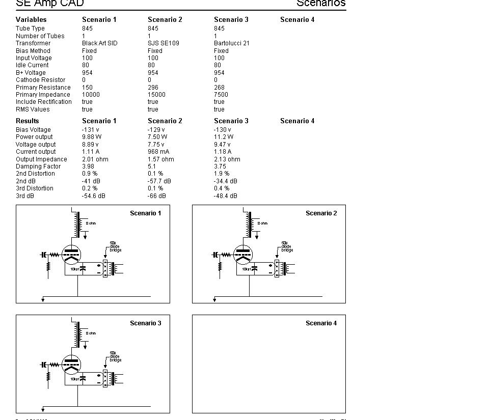

some data
Since I purchased SE cad and don't know how to use it just put some data in it and got these result. At 15K software warns too high of plate impedance . Attached comparison data for you all experts to review. Can some one help me with the parameter Vin. What will be a nominal input voltage for 845 tube or how do you get it?
