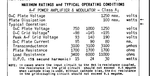

Generally, you would begin by drawing some probable load lines on the plate curves to make sure you're in a linear area of the curves and operating at a safe dissipation. Then, you'd make a judgement call about speaker damping needed.
For all triodes, linearity and speaker damping increase with higher load impedance and (above an impractical lower level) distortion decreases. Type 845 is typically operated at about 1000 VDC and 80mA idle. A 10,000 Ohm reflected load means a speaker damping ratio of about 6 and a decent combination of maximum output (about +13dBW) and linearity.

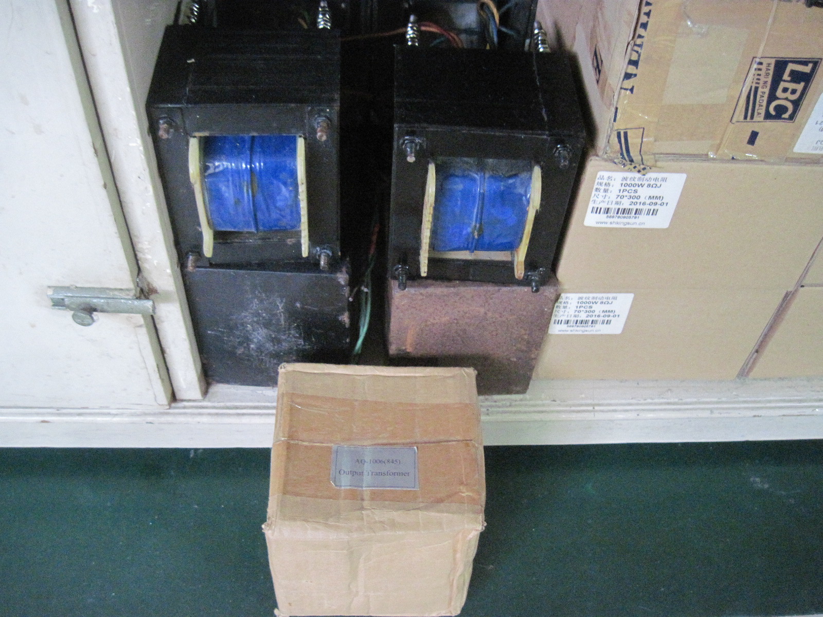

btw, i have a pair of ASL 1006 845 OPT's, dc resistance is at 450 ohms,
two vertical sections.....

if i were making these, i would probably design it to be an 8k to 4ohm traffo.
or even a 4k to 2 ohm traffo....

It's written in the datasheet if you think more about it.
For the 2A3 you have the tube running at 250V/60mA to get 3.5-4W with the 845 you have the tube running at 1250V/80mA only to get 30W. Hence you need quite higher impedance otherwise the current won't be enough. You could use 5K (i.e. abour 3x plate resistance) but would not get 30W output power. Obviously if want to use 5K, 1250V plate voltage is not the best choice. 900V is about the right choice to get about 20W in class A1.
