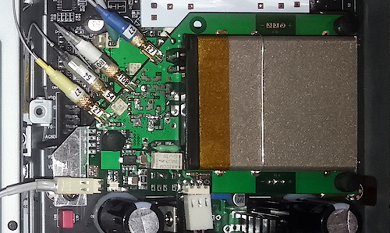

My final clocking approach for 105D model: One master oscillator 108Mhz, which it directly clock the DAC, then the further divided frequencies to 54Mhz and 27Mhz for the rest of the chips...
The divider is mounted here on the down side of the clock board, for fine adjustments reasons in this case.
Nicely working...

Looks great! Kind of wish I got a 105 instead, but with the new Oppo coming soon and their DAC, the 103 seemed the safer investment.
There are no 27 or 54mhz SAWs available commercially, right? They have to be special ordered?
I'm also thinking of swapping the TPS7A4700 supplies for a ADM7151 from diyinhk (they're inexpensive and I need more power supplies for another project). Any potential benefit there?
SAW type oscillator it can not be produced under 50Mhz. My 54Mhz one it is a customised produced oscillator, not available commercial...
However, my approach is not using independent oscillators for each chip, but one master clock, and then obtain the necessary frequencies by dividing it accordingly. Fortunately this concept it fit well for 105D model, but not for 105 which it need a 20Mhz oscillator for HDMI chip...

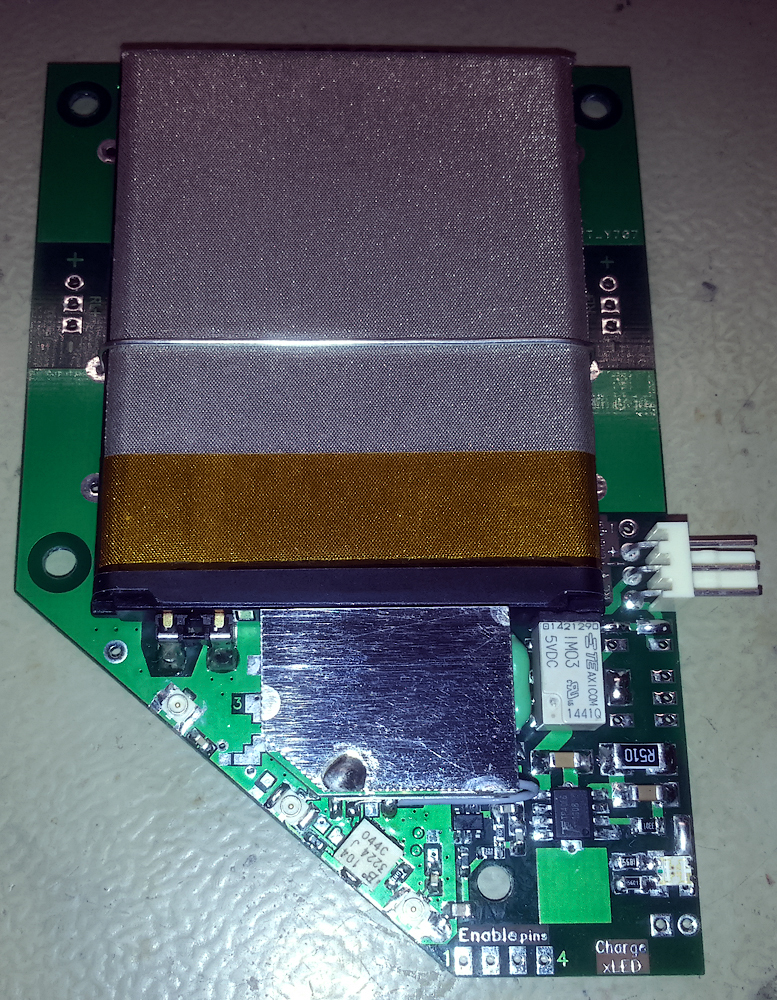

Here is the last version of the clock board...
Some improvements, as UFL connectors instead of MMCX, shielded oscillator/divider on both sides, as the internal routing (4 layers) design.
Here is pictured the 105D version (2x 27Mhz, 1x54Mhz, 1x108Mhz). Epson SAW 108Mhz is the main and only oscillator for the whole device...
The UFL connectors are very small and maybe not so easy to handle with, but there is a much better and safe contact, However, there is not recommended to many connect/disconnect cycles for these UFL.
