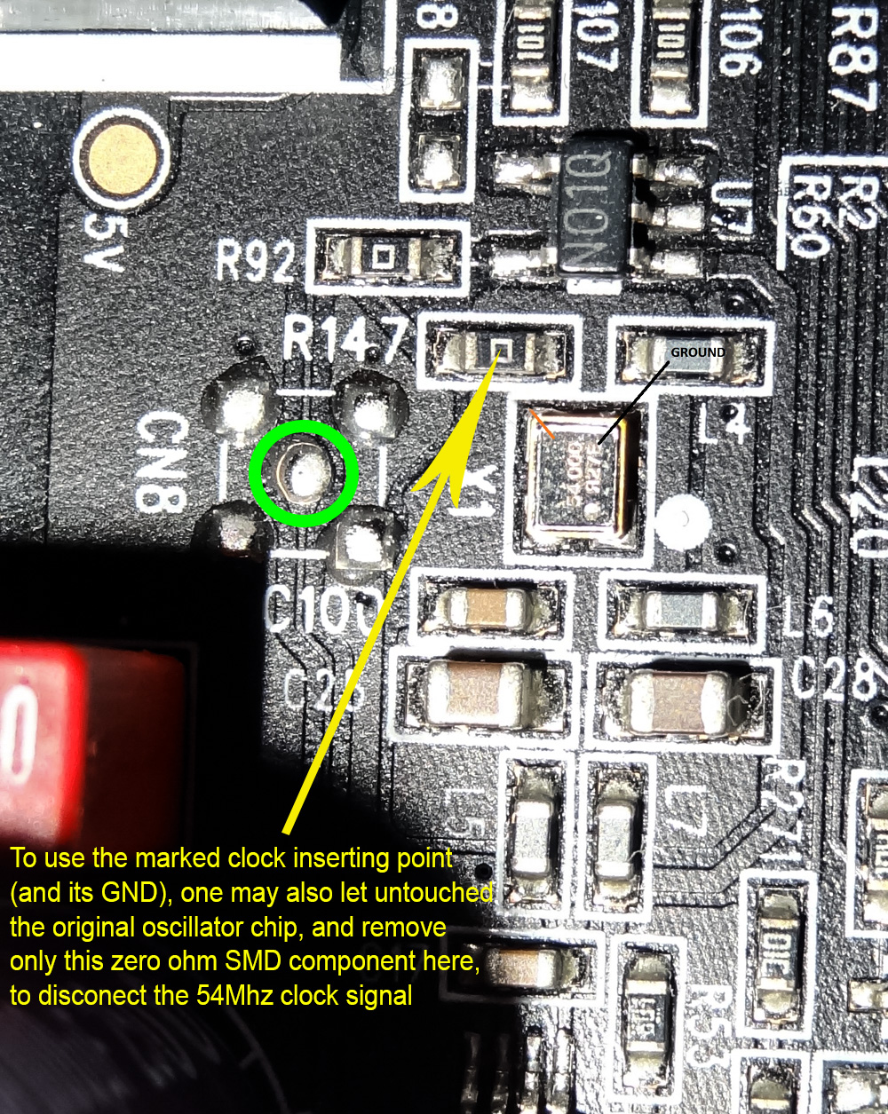

A revision (correction) of my previous post, for the insertion point of DACs clock signal (when using a external clock device/board).

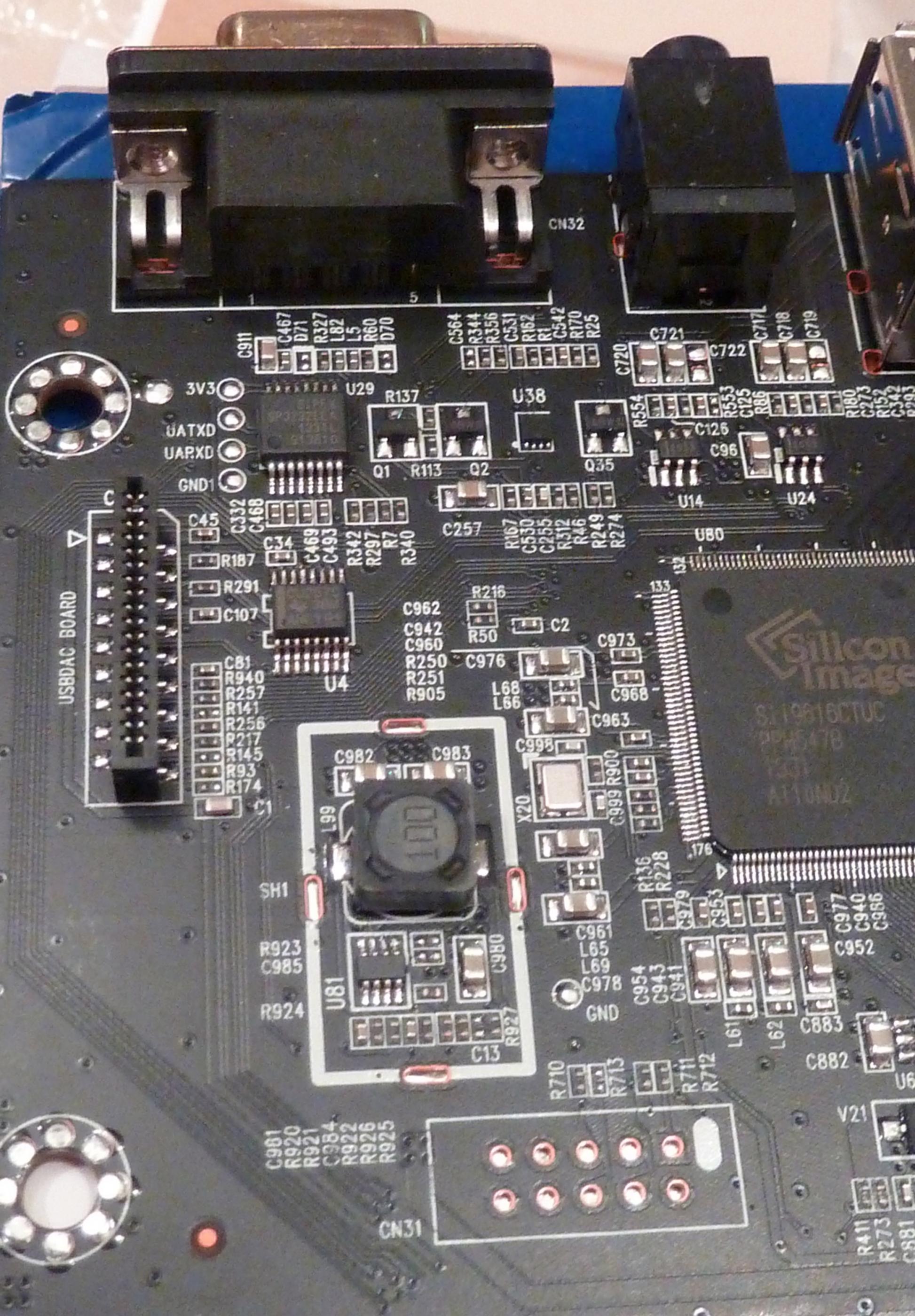

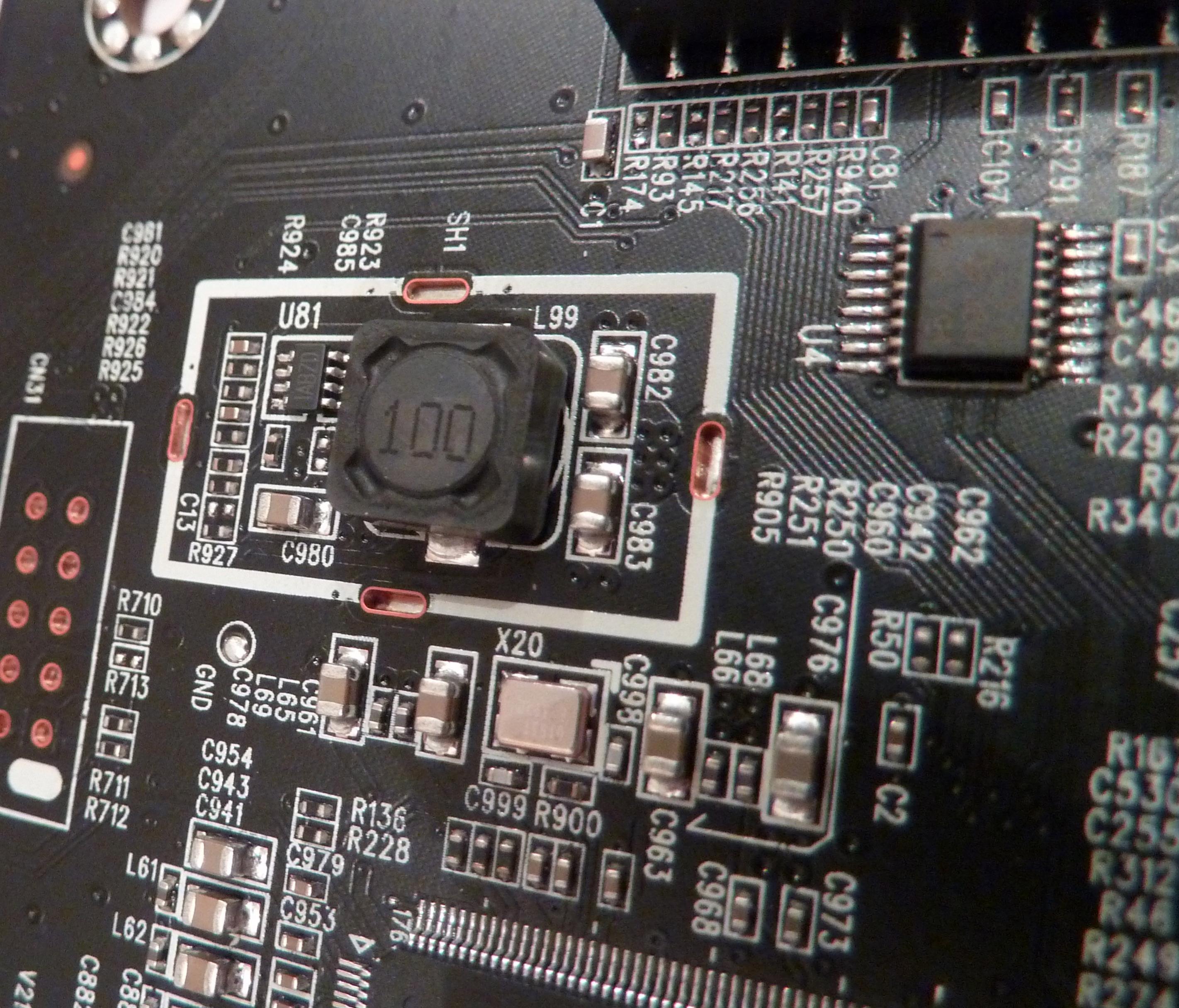

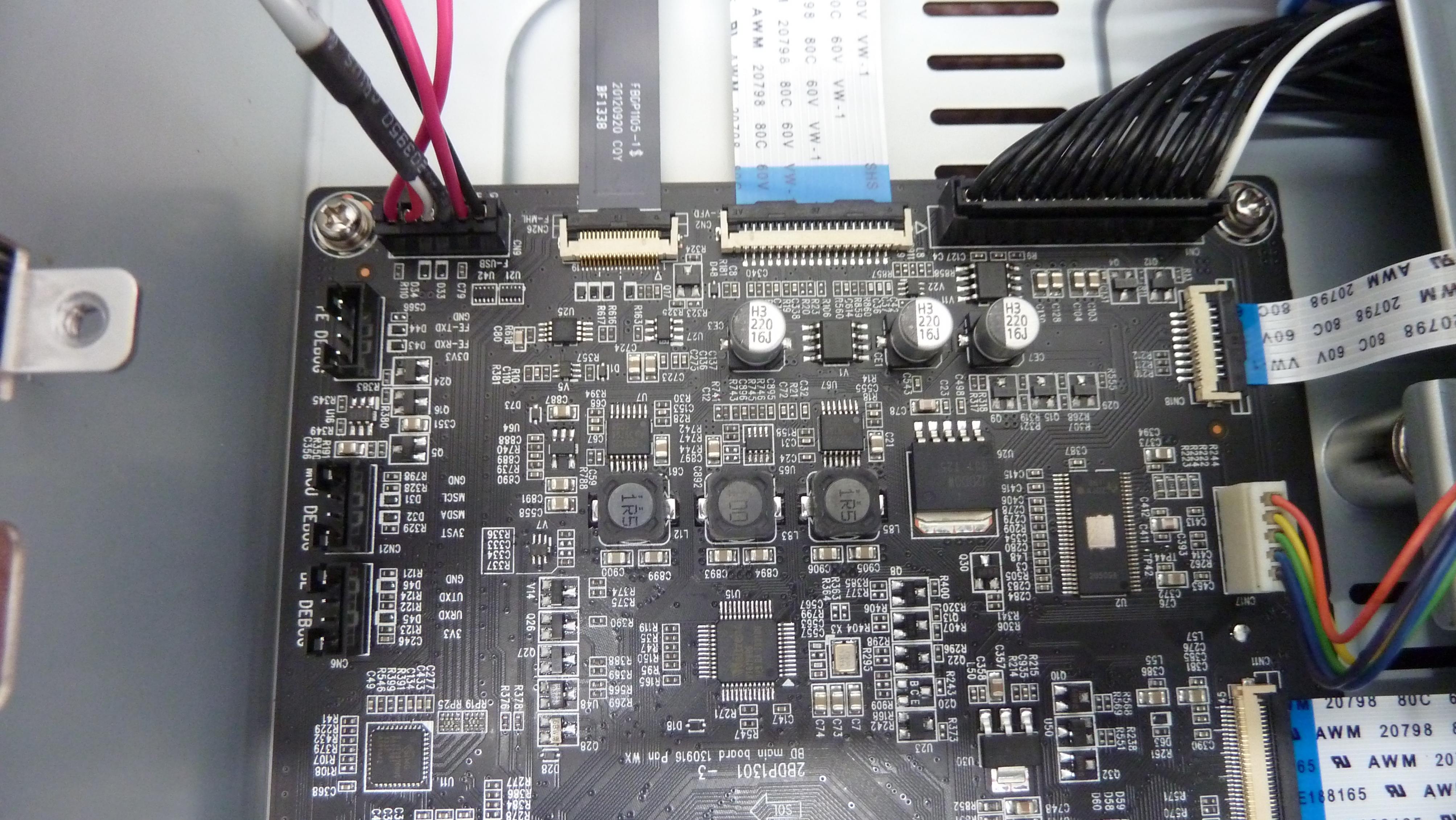

Hello Everybody, I hear from Coris, than the 105D model is not really common here.
So I post some pictures of the motherboard and particularly the clock on it. (27Mhz for HDMI)
For the CPU, same as 105/103, under the heatsink
Also a picture on the DC/DC converter, quite different as the MB of 103/105
Wish it can useful. 😀

Thanks Asterix007 for your pictures.
BTW, I personally appreciate that we can very well use this thread for the last 105D Oppo model and upcoming ones, and not spread the discussions over threads dedicated to each specific model in this same family.
So, we can conclude now (about the 105D clock system) that are:
- one 27Mhz clock for HDMI/DARBEE chip,
- one 27Mhz clock for the main processor,
- one 54Mhz clock for DACs.
I`m glad for this choice of the designers, because this clock configuration it fit very well, and it simplify even more the implementation of my clock divider solution.
My comments so far, after I have seen these pictures:
I just do not understand what the Oppo designers had in their minds, but using two different oscillators chips with the same frequency is quite strange (to use a more elegant word...).
Why not take a trace from the processor oscillator, to feed with the same frequency clock the HDMI chip not so far away? I can not see any problems to have a clock trace inside the PCB, or place the processor oscillator somewhere in between the chips which need this clock. Or any of many other reasonable solution to avoid using two oscillator chips with the same frequency...
It can be an explanation for the reasons it were used different clock chips here, if these chips are resonators, but not oscillators. But a decision to use two resonators with the same frequency instead of only one oscillator chip for both targeted devices, it is however a bad decision (taken maybe by some financial "specialists"...).
I can see in a picture a very well defined switching power supply circuit area. The designers have thought (very right this time) to shield this very noisy kind of circuit, planted right in between some sensitive devices, and very near to the HDMI oscillator.
It were designed all what is needed to place a shield cover over this PSU. Then this idea it were abandoned, for sure for a "lower production price" reason... I feel the need to use a non elegant word here, but I will not do it right now...
So, my first recommendation to the modders out there, is to find a way to cover/shield this PSU on this motherboard pictured here, before proceed to an improvement of the oscillator/clock right beside this noisy small SMPS.
In my opinion, injecting a clock signal through a coax connection to clock the HDMI chip it will minimise quite much the impact of noisy circuit beside in this area. However it is a very good idea to have this small SMPS shielded, as the silk printed on the PCB shows, and Oppo financial specialists decided not to do it...
I will want to chose a smaller diameter coax anyway... I think 2mm thick coax is quite much, and is enough rigid to be used in tight places...
The 0,8 mm one I have now it do for me a very good job (it will be provided with my kit), is very flexible, but a little bit difficult when to fit it into connectors. Just for solder it in place is all right.
Else one may well use a more easy to handle 1-1,5 mm type coax.
For shielding that SMPS unit, I will suggest at least some steel based material/thin plate, or much better, some special made EMI shielding material. Take out the marked (silk) dimensions, design it on a paper that box, cut it and bend it accordingly, then find the right metal material and copy the paper model on it. Solder it in place. Done it! Watch for the results on your display...

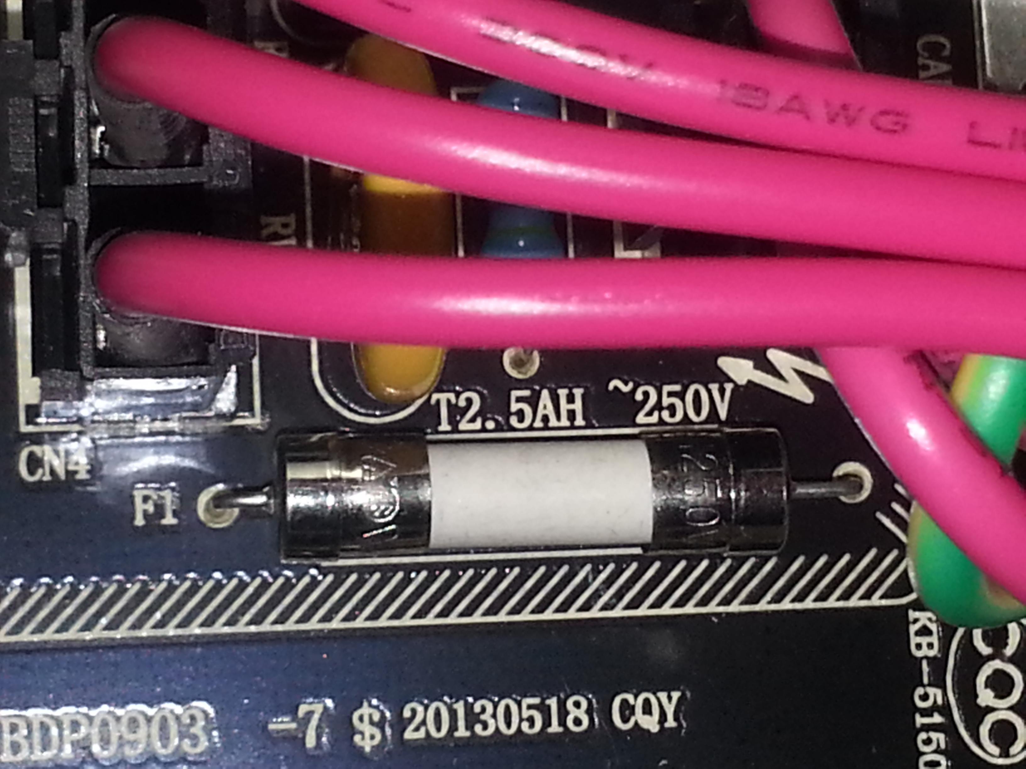

Update
Two updates on my mods

2. The main PS fuse is a 250v 5A fuse.
I will try upgrading to an audio grade fuse... I have had good luck with this in my preamp.
Any recommendations for a fuse holder in this position?

I have a comment about this (legendary) fuse (replacing with "audio grade").
I guess in your preamp it is about another type PSU (linear). In such case the construction of a fuse placed on a DC line it may have impact for the noises levels in the system.
When about this player, here we have a SMPS protected in its very first input stage by this fuse. This SMPS is a switching device, very noisy right before its the last filtering caps. The impact of this fuse, placed on an AC isolated circuit, for the noisy device it protect is pure and simple, nothing. If this fuse it should be placed on the DC lines, then we may want to think at a "audio grade" one. But in this case is really not to think about.
In my opinion, you may direct your efforts and investments in other directions, but not thinking at all at this fuse.
