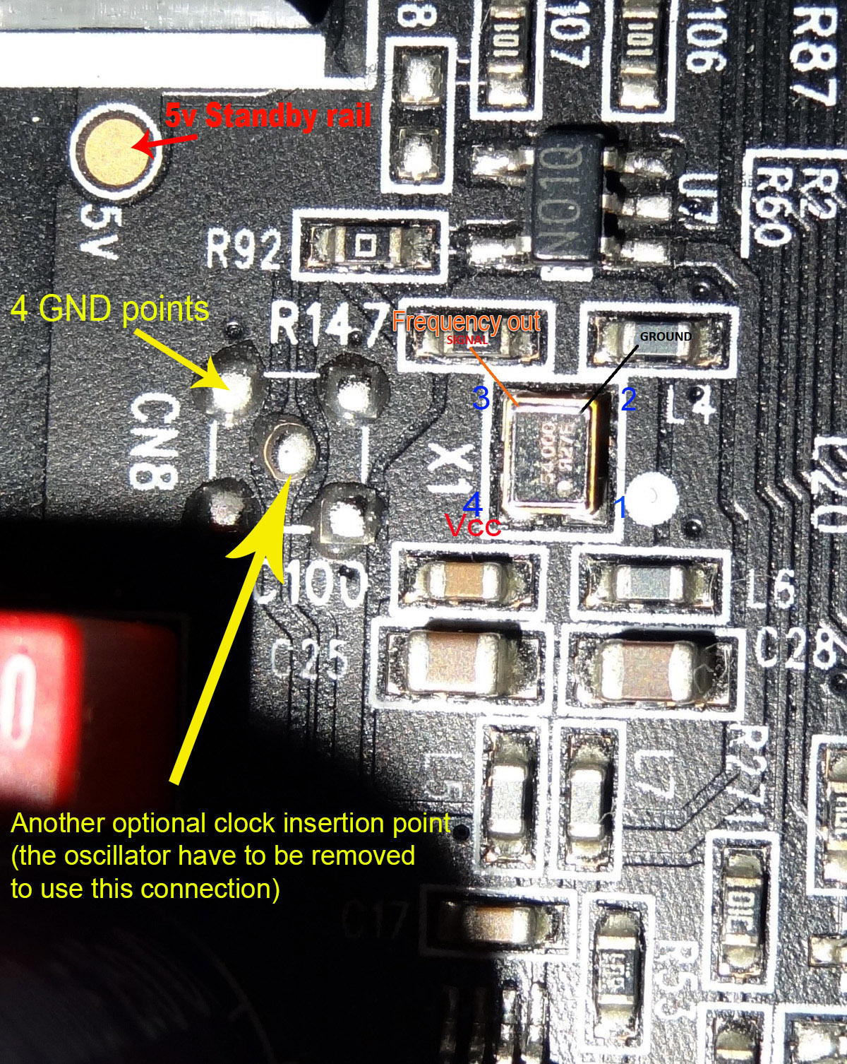

It seems that Oppo use now in the last models (D) 27Mhz clocks and 54Mhz. So the 20Mhz clock seems to be gone...
Can someone please confirm (or not) this?
I can confirm, just a single 27MHz Xtal is attached to the MediaTek chip.
Thanks Joe for the confirmation.
But what about the other clocks? It have to be one for DACs and I suppose one for HDMI output chip (Darbie or QDEO)?
Are you so kind to list the oscillators and their frequencies in the new player model?
As far as I can tell, the MediaTek chip PLL's/synthesises all the necessary frequencies from that single 27MHz Master Clock. This is what MediaTek did in the past and it seems they have gone back to that arrangement. Unless somebody knows different, that seems to be the case. But I see no other clock in near proximity to MT/OP8581 either above or under the board.
Cheers, Joe

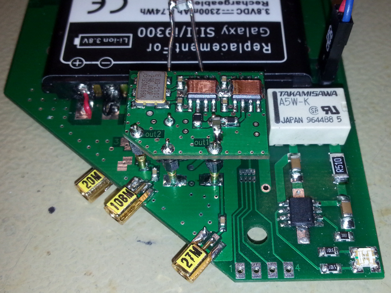

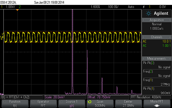

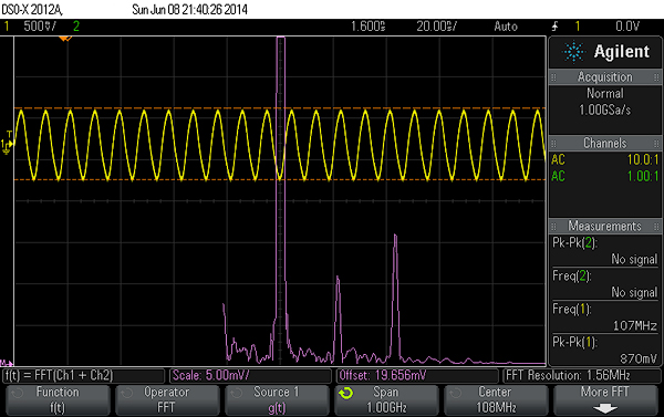

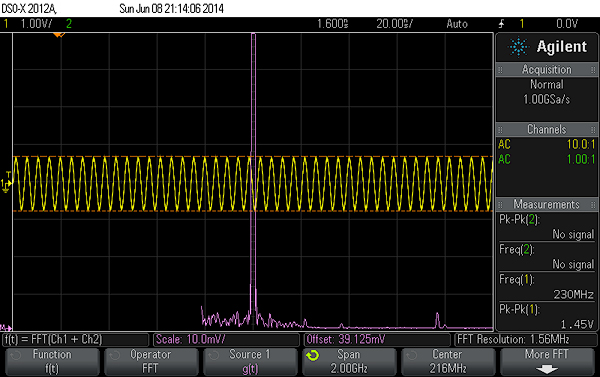

My clock divider is now up and running.
216Mhz SAW main clock, divided to 108Mhz for DAC and to 27Mhz for processor.
Here is the test bench, but finally this kit it will look better, with shorter connection pins, and soldered on the main battery board.
It need a little bit more fine tuning, but how is now it looks like in the attached scope pics.
Quite excited to "hear" the result...

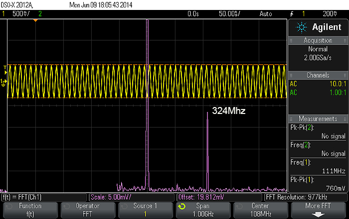

Improved 108Mhz clock signal, after some adjustments of divider circuits.
It will be for sure a second version of the divider PCB, as I found necessary with some other design improvements...
