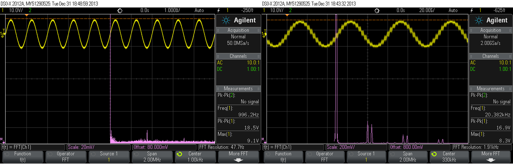

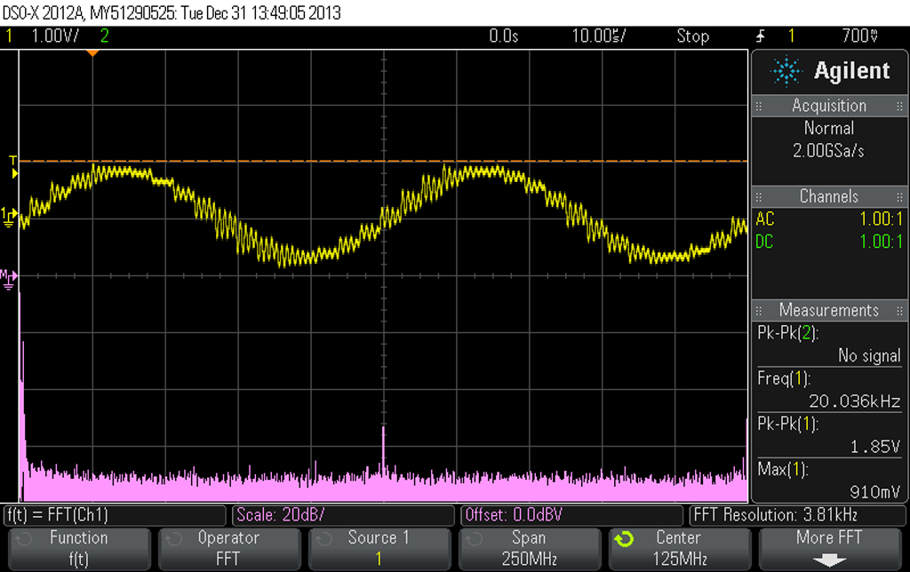

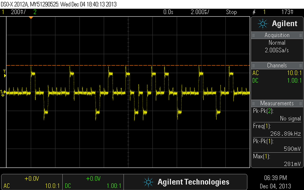

I was a little bit sceptic to publish some snap shots of my preliminary measurements (not very detailed or accurate), because it were taken using a 1792 chip. While we are here in a thread which is about something else...
But anyway, for the subject in discussion now it will be acceptable I suppose...
So, first (double picture) shows a well working set up. I used a cap value which it just were working, but not fine tuned for the best result.
There is to be seen on 20Khz a quite special quality of the sine signal, due to the remaining HF noises on a non filtering precessing. Even though, and very surprising for my self too, the audio output is only amazing.
There is another picture which shows a very nice square HF noise out of the (amplified - RCA) 1792 DAC outputs. The setup for the I/V and final it were tuned for the best and largest bandwidth. This very nice noise is not acceptable for an audio processor, so it have to be degraded, attenuated in one way, to minimize its negative impact for the audio/sound.
The third picture shows the worse case scenario, where a capacity (between DAC`s phases), over the critical value is used in a well working analogue post DAC processing set up. Everything become very bad...The degradation of the audio signal is obvious.
