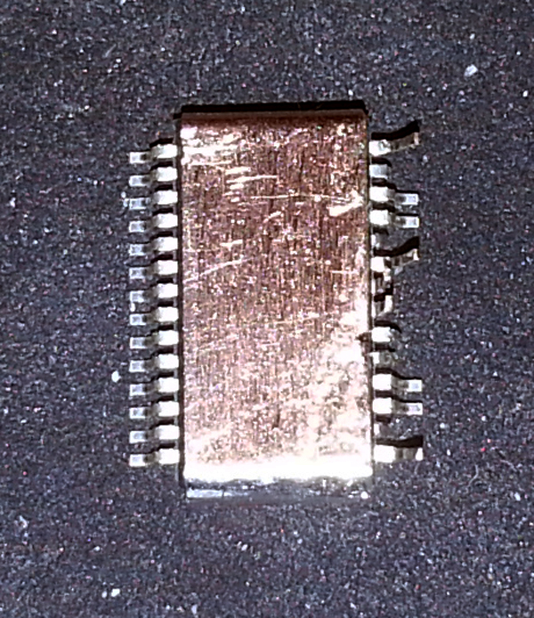

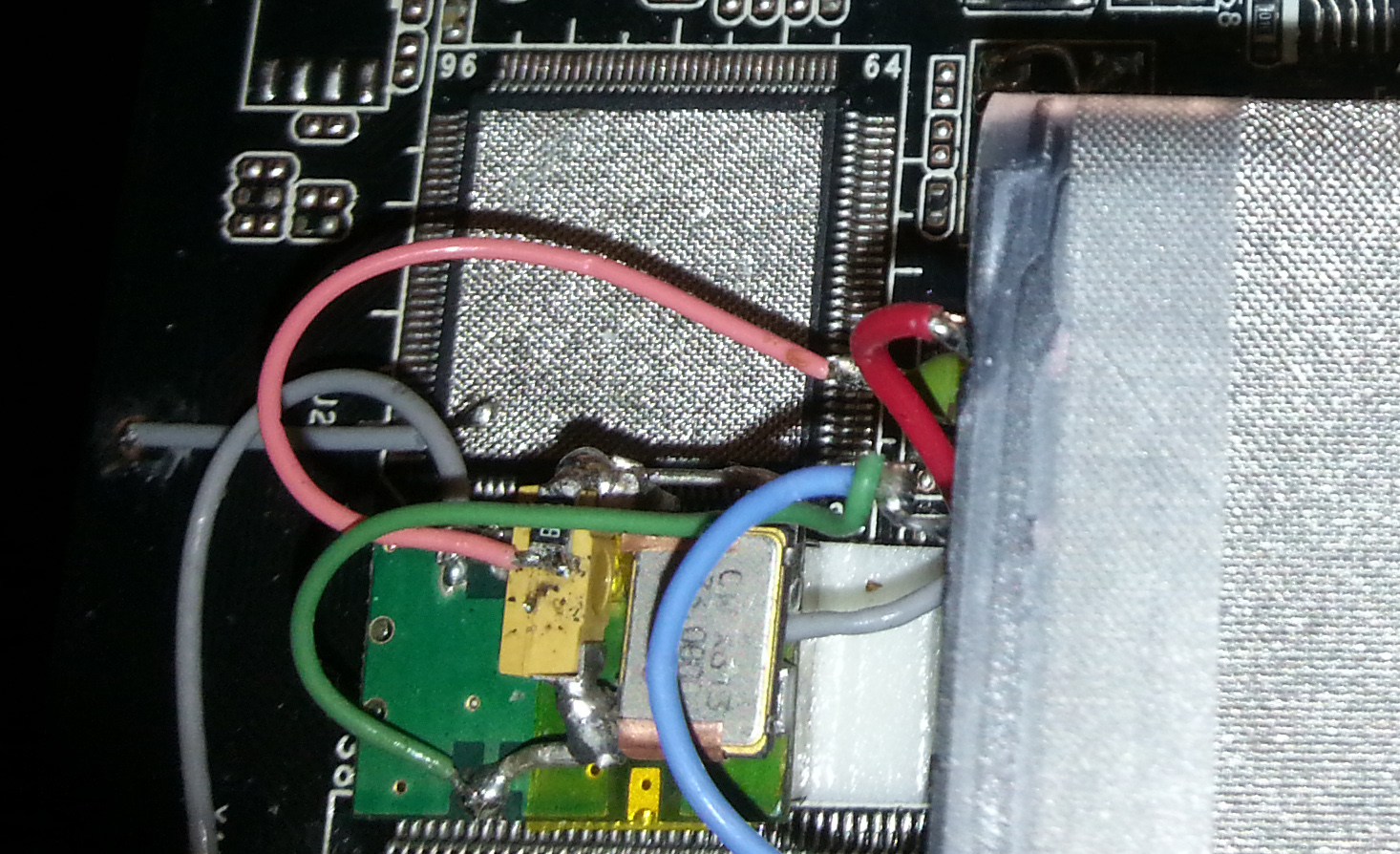

There is beneficial and in my opinion, the DAC chip, as some other components of a DAC system it have to be shielded...
One may use expensive or cheaper materials (as a copper foil), but one may shield these components in one way...
Yes, certainly there is a long history of using copper foil as a Faraday cage. This is very effective. However it needs to be grounded, and this often makes it somewhat tedious to install.
And here I'm thinking about retrofit applications as well…
These it may be examples of chip shielding (with grounding)...
In one picture is shown a way to shield an already soldered chip. The another picture it shows (a better) shielding of a chip which is going to be (custom) soldered... The second way of shielding it is not at all a production way to do it...😉
