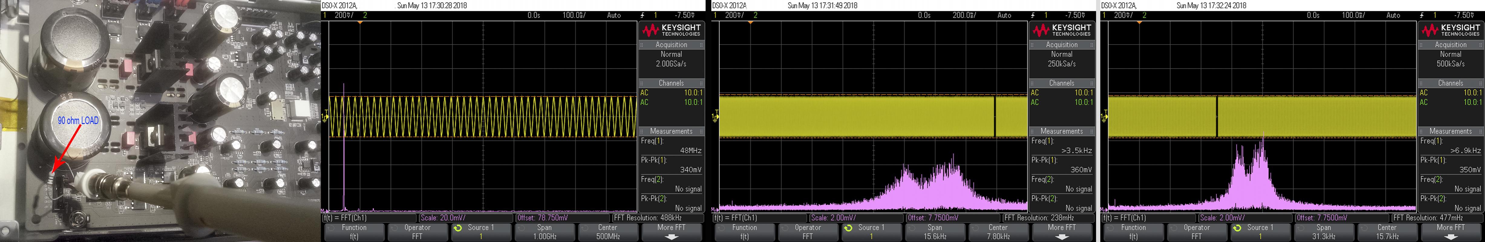

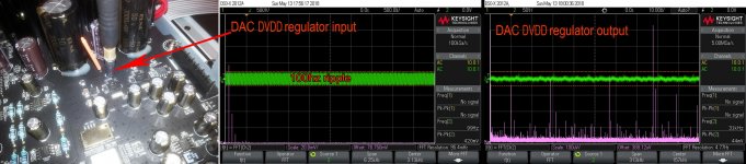

Stereo Board power section ripple
I did some detailed measurements on an original 205 stereo board (analogue power stage)...
Hey Coris
Am I reading this correctly - that ripple at opamp from+12V Regulated supply is 48mV?
Is that the level between the 2 orange dashed lines or should we be looking at the main green ripple itself?
I think I cannot see clearly from the image resolution - looks like there are just a few spikes which shoot up, but most of the ripple is 1/3 of the 48mV. Is that correct?
Den
Joined 2009
I think you should download the pictures, to get a better resolution. Here on site it are compressed, I suppose.
The orange pin on my probe is actually the ground. The another one is the active one...
I have measured the ripple at the positive regulator output, and there is just huge. Definitely at the regulator output, the ripple level it should not look like you can see in picture. That is not a normal functional mode for a linear regulator...
Then I have measured on the same rail at the opamp power pin (the positive one). The ripple is quite non existent there. I am not very clear about how it is disappeared... However, the + rail it looks like in the screenshot at the opamp power pin. The spikes to be seen, are digital noises which it come somehow into the analogue power system...
What it is in green on the display center is the normal signal, while the purple one at the display bottom, is the FFT (volt) calculations (illustration) of that signal.
Joined 2009
Yes, it is right. My main AC is 50hz.
44mVpp is an overall level of the noise spectre (Vpp). Please look at the purple (FFT) part of the screen. The settings are on 100µVpp per division. The highest frequency pick in this pictured frequency range is of 700µVpp.
A DC rail covered by such large spectre noises it looks enough bad indeed. We may not forget that here is about a DC power rail connected to (powering) a digital circuit/stage (inside the chip). The noisy digital circuit it will however negatively affect the "cleanness" of a DC power source. So, what is to be seen here, is not very far from normal.
My concern is about the enormous ripple level at the regulator input. A certain ripple level at an linear regulator input is normal as well, but not at such level. This is an indication of a wrong tailored power system. They bet on the regulator capability to filter out the ripple, but in my opinion, such design approach is only wrong. It works, but it not provide quality... Well, average...

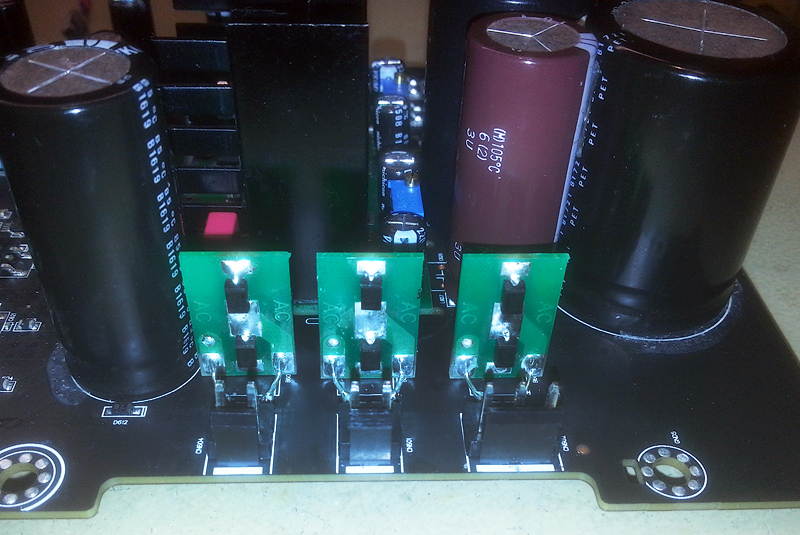

This (bellow picture) is how I am doing right now...

Thanks Coris for your advice re Schottky. I agree lower VF forward voltage drop (and low IR reverse leakage current) are important to get lower ripple and good efficiency. The original DF02S bridge is only rated for 1.5A, but high 1.1VF.
For the +/-12V rails, I would go for discrete diodes (as I am thinking of using 4-pole Jensen audio caps as resevoir). A quick search in Digikey for 40V, up to 5A gave me 2 Schottky choices:
497-6588-1-ND. $0.73. VF= 500mV. IR 200µA. STMicro.
SB540-E3/54GICT-ND $0.64. VF= 480mV. IR 500µA. Vishay.
The STMicro diode has lower IR reverse leakage current thus lower heat, but at 12V, we are talking about a tiny .0024W of heat.
The Vishay has slightly better VF – about 20mV less voltage drop.
There’s no need to go for a lower current diode as I have not found ones with better VF and VR. So I suppose either diodes would do.
For the 5V rails, I would go for smd mount Schottky bridge. Found this:
CBRSDSH2-40TR13-CT-ND. 40V. 2A. $1.25 VF= 450mV. IR= 70µA. This bridge has roughly same footprint as the original DF02S bridge.
Above Schottkys all give ultrafast and soft recovery, thus lower noise and faster response as current demands swing with the music. Hopefully the 0.6V increased voltage supplied to the regulators will not cause worrying stress.
All comments welcome :)
Joined 2009
Your chosen diodes are very good for this application. You can very well use these components for bridges on all the power rails.
The heat dissipation parameter for the diodes it is really not important here, as the currents which goes through it are quite small (comparing with their ratings). For these power rails the diodes get never even warm.... The diodes thermal dissipation it become important at many ampere currents.
In case of this Oppo device, a larger current is on 6v power rails, and less on +/-12v ones. _The +12v rail it use a little bit more current, than -12v one, as it power the AVCC lines for DAC, and the relays as well.
