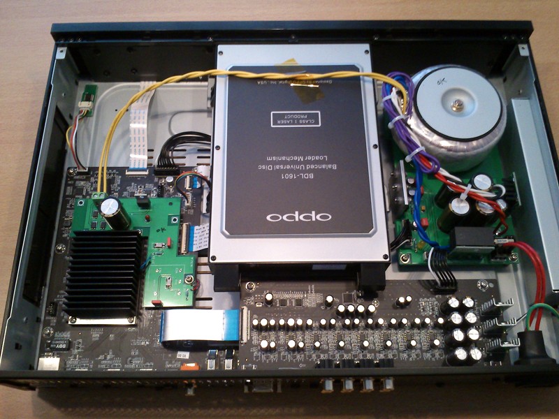

I have found picture the clock in bottom right corner

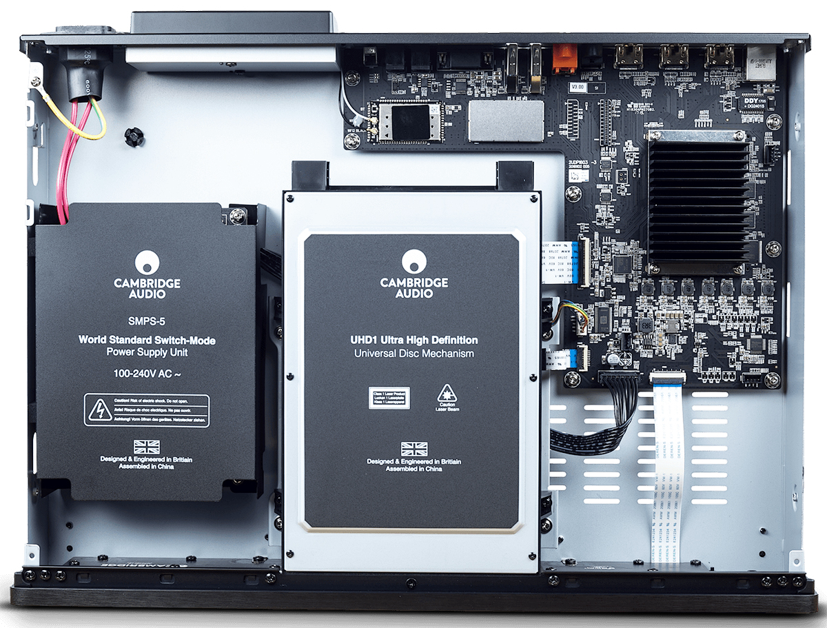

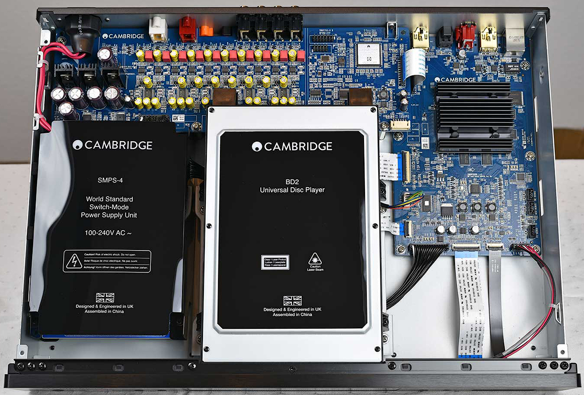

Who copied who?
There was and is quite known that these two producers it had/have very similar design and buildings for their (UHD) players.
I think we may not be so disappointed about Oppo getting out of the competition in this field.
The experienced Oppo modders may easily switch on Cambridge devices. Lot of interesting things to be done there as well. Particularly for their chosen same SMPS solution.
I presume opening a dedicated Cambridge thread very soon... CXU-10 is indeed an interesting device (I guess quite good after improvements)...;)
However, Oppo UDP 205 (as 105 model as well) still remain in my opinion, quite unique, as a very high quality potent hardware...

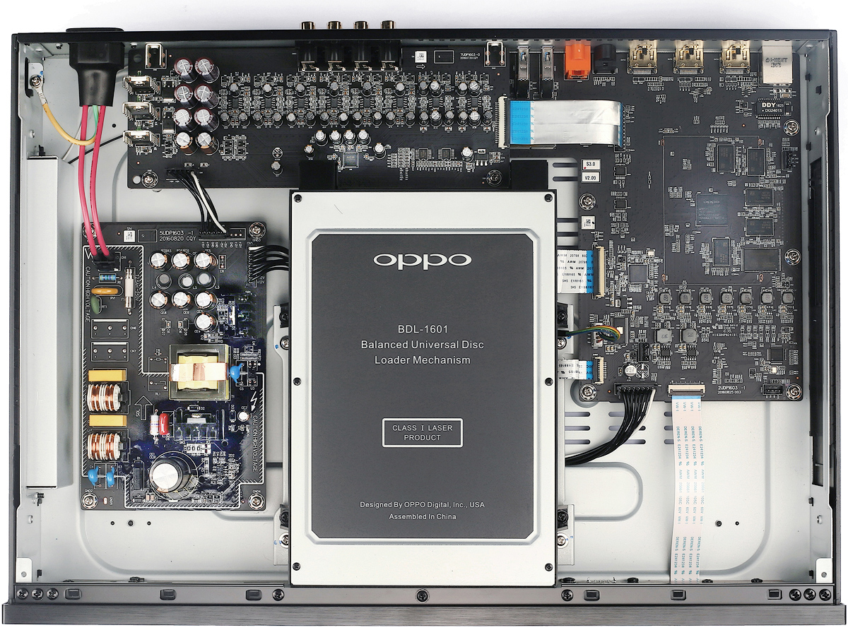

I believe that the Cambridge Audio CXUHD is based on the OPPO 203. The transport and main board are identical. When OPPO stop making universal disk players, companies like Cambridge Audio and PS Audio will have to find an alternative base unit to use as a transport. OPPO sales quantities will be far greater than the number of transport kits sold to OEM manufacturers like Cambridge Audio, so to continue manufacturing for OEMs would not be cost effective.

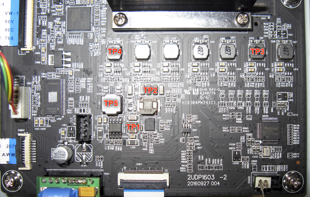

I just found out a new improvement for all Oppo devices: providing linear power to a part of the inside digital stage (optical drive processor, SAW oscillator for HDMI audio dedicated output, as some other circuits on digital board). Preliminary results for discs playback (video) is just amazing.
The ideal for an unbelievable quality result it may be a full linear power for all digital chips/components (on digital board). Well, this is not possible, because a lot of heat dissipation. However, it is possible a partial analogue powering, as LPS at the digital board main power input, instead of the original SMPS, and now linear power for one of the 3,3v rails, for an important section of the the digital stage. I only have to find a solution to lower the heat dissipation.
The big problem when eventually replacing all the small DC/DC converters (SMPS), with linear regulators on the digital board, is the power management necessary for power up/down sequences. However, I found a way to use analogue power for a part of the digital system, without disturbing the power management. I have not yet tested the audio, but the picture is only impressive, with this power rail improvement.

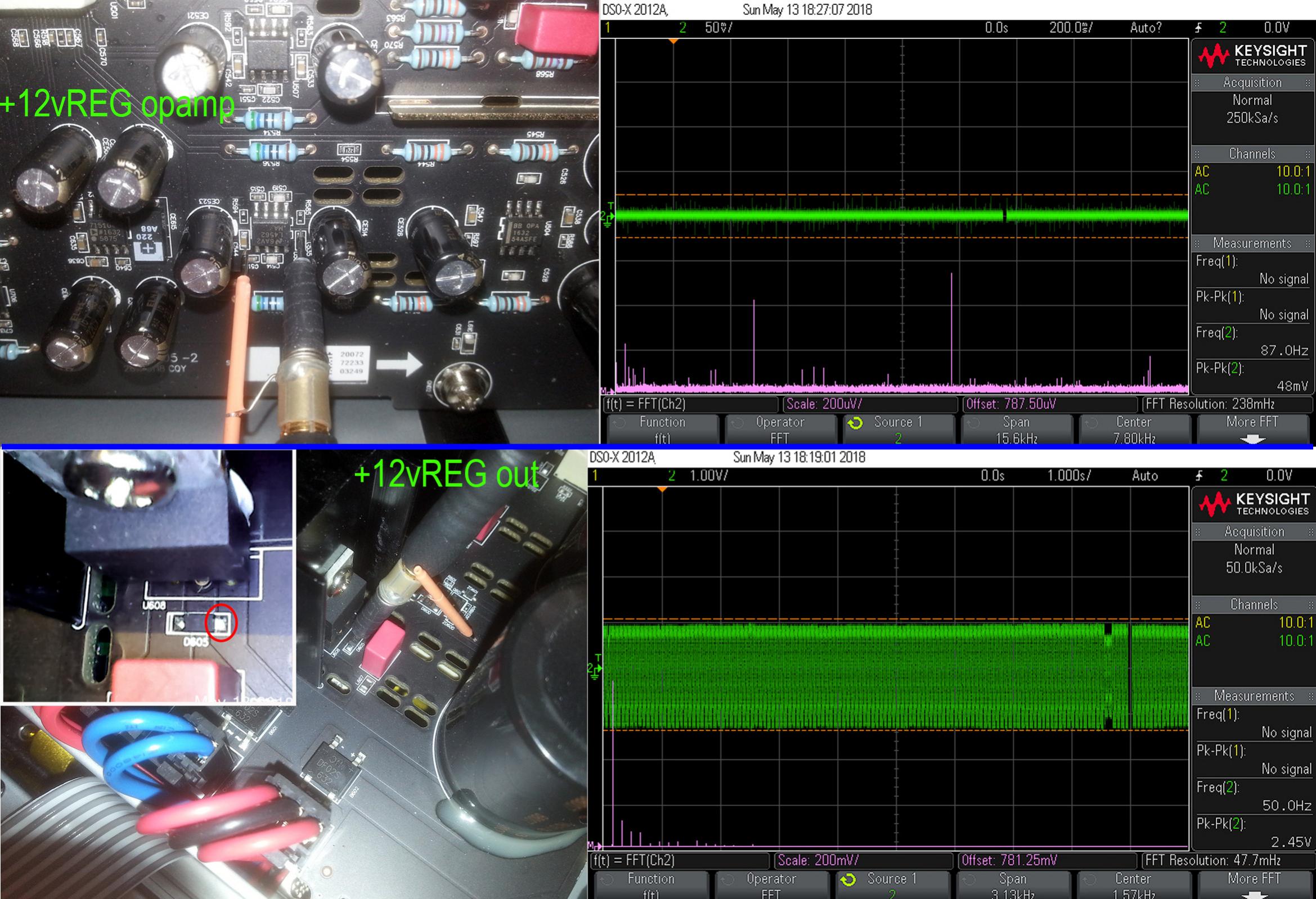

I did some detailed measurements on an original 205 stereo board (analogue power stage). It will come here the results. This is the first episode, of the serial...;). To be continued (quite interesting things).
I will improve this board, and I will do again the same measurements. We shall see what happen...
By the way (a bad news), the headphone output it oscillate in Mhz range. I measured it first on my modified board, and I thought it was something wrong with my way of doing, improving this stage. However, I was not very sure about this explanation, as I found the oscillations right at the TPA6120 chip output. I wanted a confirmation, before going out with this information. As I have done the measurement on a new original board, I can confirm now this statement.
It happen only with this last model, as the 105 had not such problems. This is a PCB design fault. It is known that a such fault it can produce HF oscillations out of this chip. I will publish shortly the screenshots.
However, on a stock device, this HP output it provide best listening quality (in my opinion). I used it connected to the amp.

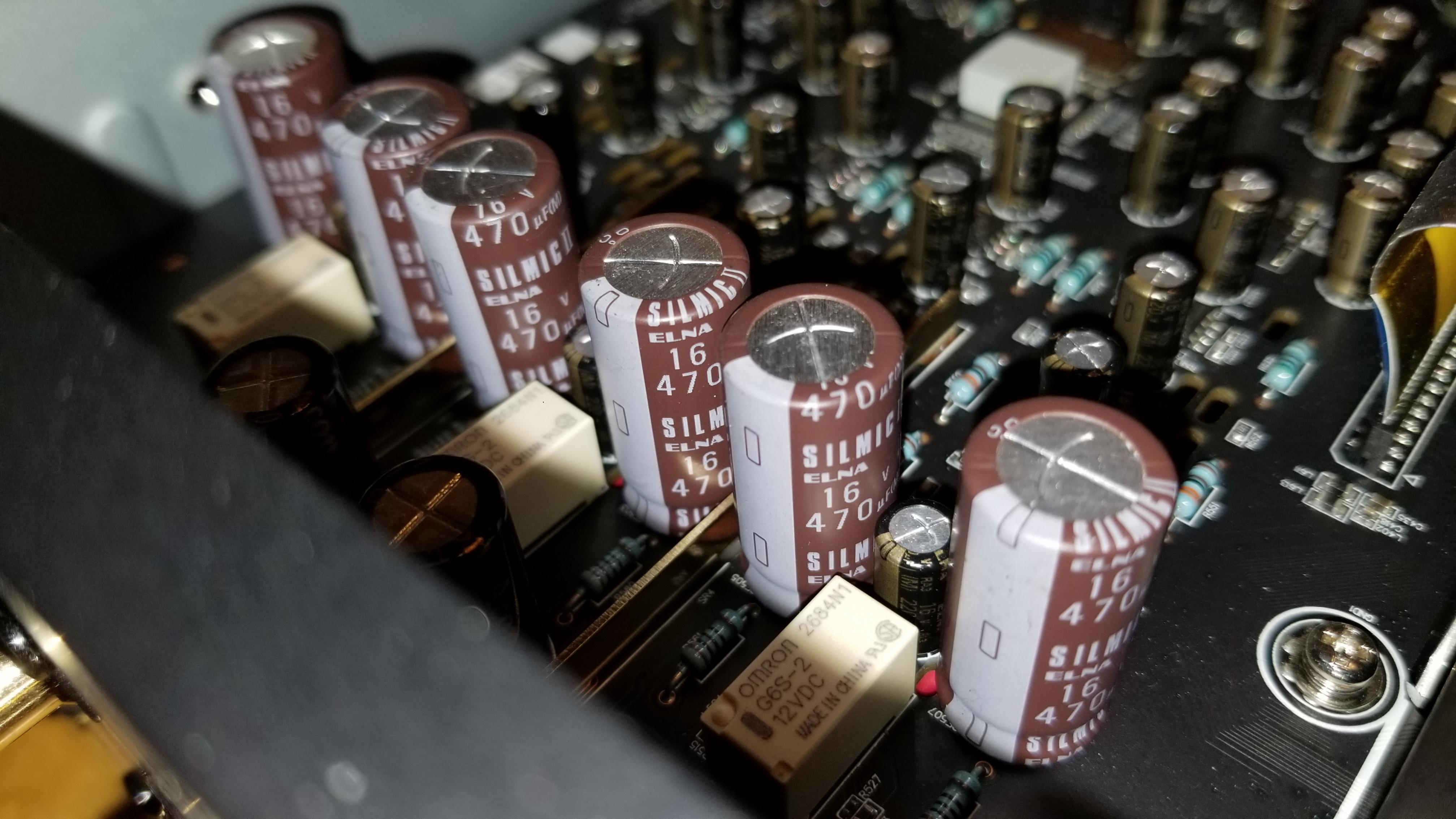

Updated bypas Caps from Wima to Cornell.
I originally replaced the output caps of the 205 Stereo board with Silmic II 16v 470 uf, and bypass with Wima MKS2 1uF/63V. Well I removed the Wima's and replaced them with Cornell-Dublier 940C .01uF/3000V polypropylene film Caps.
Have not come to any conclusion as to changes in sound quality yet, need to give them some burn in.
Mark
