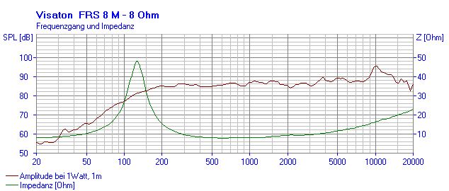

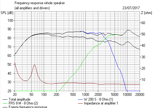

Zvu, I quite like a cone tweeter myself. I looked at the 3" Visaton FRS 8 M, which is conveniently more efficient than your FRS 8.
But what I run into is that a 3" driver just naturally breaks up at 10 kHz. It's how it works. Just like a 6" driver breaks up at 5kHz. Some severe problems at 10 kHz anyway. Maybe a supertweeter should kick in a bit lower. It would help dispersion too. A traditional weakness of cones. All, in speakers is compromise.
