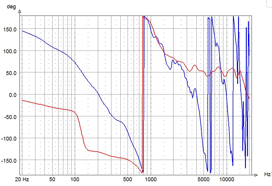

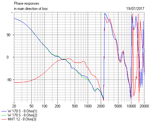

But whatever I do, I seem to find an awful resonance in the phase plot. Even with a planar tweeter like the Visaton MHT-12.
It's most evident on the phase plot, and FWIW, group delay or stored energy is related to the rate of change of phase, and doubtless the more direct waterfall of stored energy.
Here's a 6 inch bass with its inevitable 6kHz cone/surround resonance. And 6kHz is about 3cm half-wavelength. But even the planar tweeter is getting a distinct kink in phase. That's breakup on the woofer AND the tweeter.
We need more rigid materials.

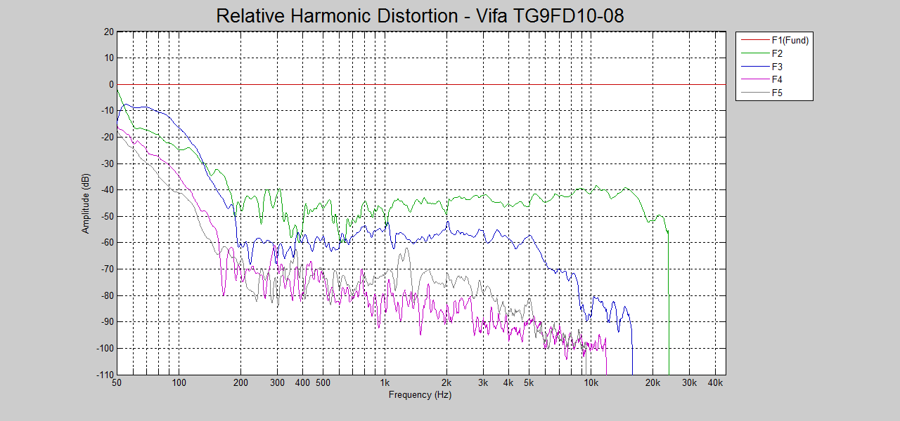

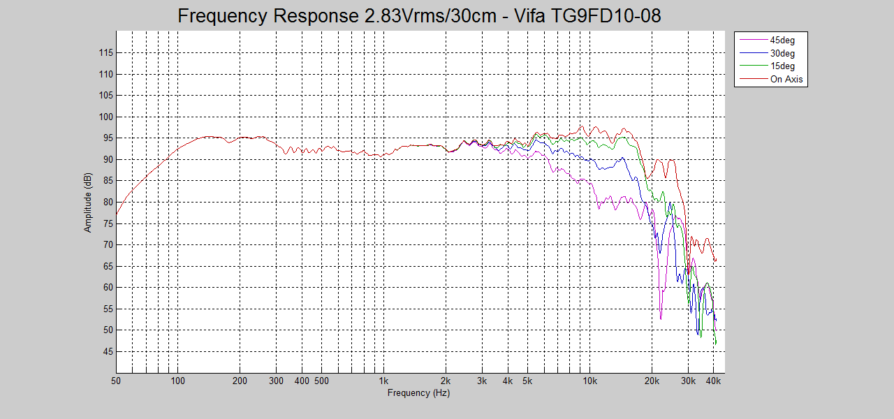

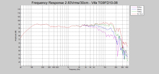

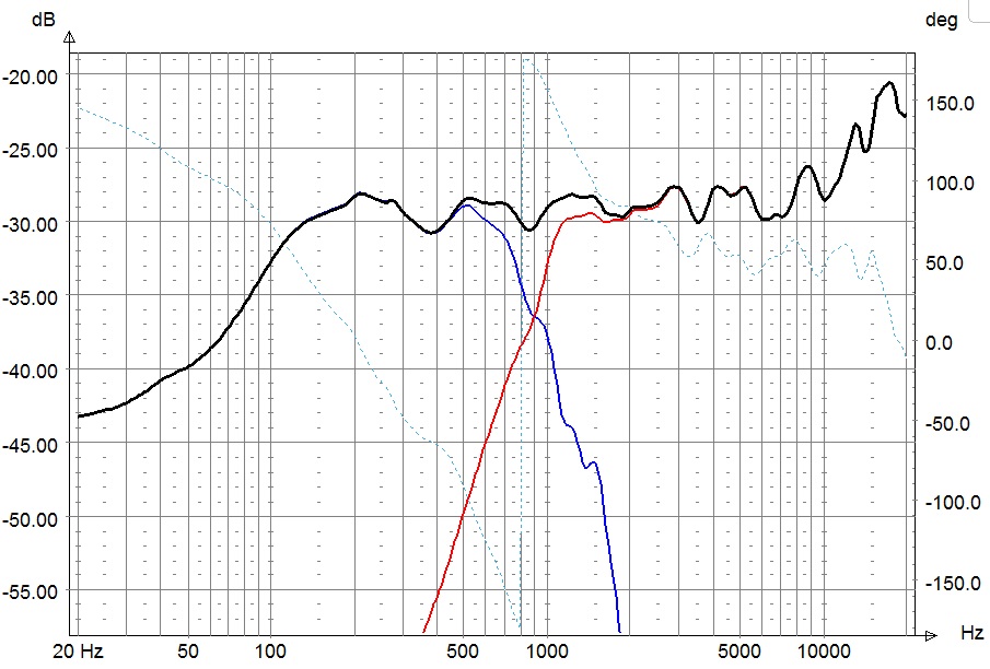

I attached data on the 3.5" TG9 driver that I mentioned as a comparison. Not high sensitivity, but makes a fine tweeter that can be crossed as low as 300 Hz (with some input power limitations) or closer to 750Hz as a low-cross tweeter.

Zvu - what crossover point / slope did you use there?

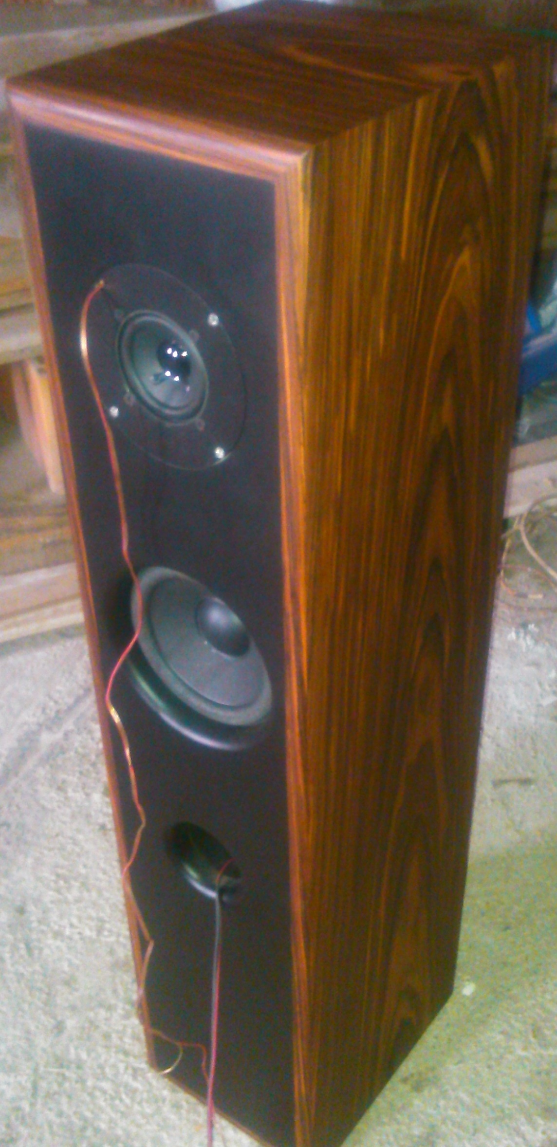

Here it is. I gave him the schematic with mods to cope with rising response of Visaton FRS8 but i told him to listen it first of axis for some time and see how it sounds in his room. If there is too much high frequency energy, he should do the mods. If room absorbs it, then he can listen it off axis and enjoy.
