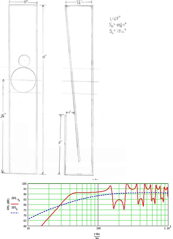

Nebelk,
I promised to post a new plot for the before mentioned L-pad in front of your tweeter.
It didn’t improve the filter so I will hereby withdraw my promised picture, as it’s worse than the one I have shown earlier.
But, I simulated your ‘vifa.jpg’ today, just of curiosity and draw the conclusions that your TL simulation is in my opinion severely misaligned.
There is nearly no cone control at all and the tuning is far to low in my opinion, about 18 Hz.
At 5 W input you will hit x-max for 30 Hz at a low 88dB SPL.
If using a 50 Litre box, So=2.5 and SL=1 and L=80”, input power capability doubles when tuned to 30 Hz/ at 93dB SPL.

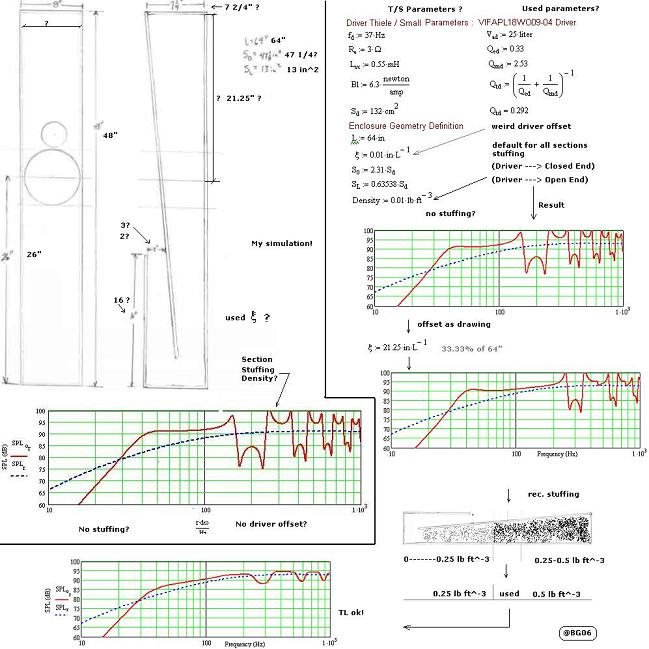

Vbro,
Nebelk’s TL have a line length about 2.5 m and is tapered.
The quarter wavelength for the driver of fs = 37 Hz is 2.32 m.
A straight 2.32 m non-tapered tube without any ‘padding’ would be sufficient to restrict excessive cone motion at the fs.
Nebelk’s TL which is tapered has a quarter-wave resonance below 25 Hz without any ‘padding’.
By the way, Nebelk’s TL might use a baffle step compensation too of 1.2 mH paralleled with 3 Ohm.

What do you think of the intial design MJK?
I really can't comment on the drivers or crossover since I have not looked closely at them or used them in any projects. But the plotted SPL response for the TL, in one of the earlier posts, does not look all that impressive. I would not expect too much bass from this design and would probably recommend a redesign.
thanks for the replies everyone
my initial design was based more on aesthetics than on knowledge of how a TL should be properly designed, so I figured some change would be necessary, perhaps a complete redesign.

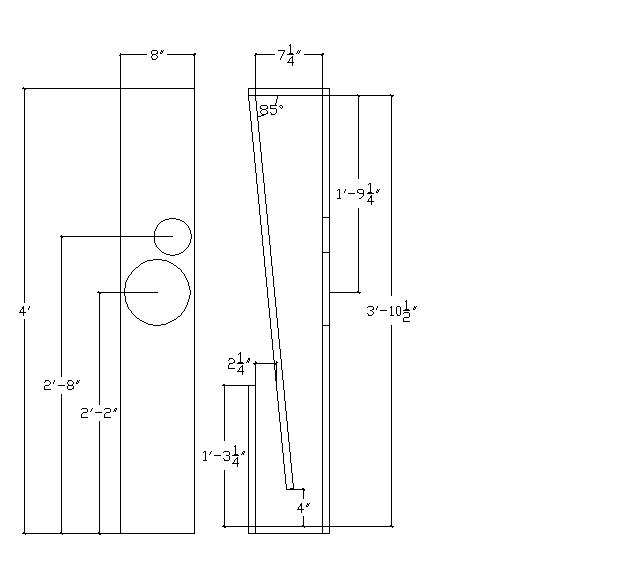

Hi Nebelk,
The TL length is about right now but:
Please make your drawing more readable and fill in all the question marks.
Your simulation must be backed up with ..all… data used when simulating your speaker, otherwise it’s impossible to help you further.

bjorno, sorry for the lack of clarity and information in my last sketch.
I have redrawn it in autocad so hopefully it is a bit more clear.
I am unsure what exactly the offset should be in MJK's sims, I thought it was the ratio of drvier offset from top of line / line length, but it should be the length from the driver center to the top of the line, correct? I think this may be why my sims are off.
for example, in the attached drawing, driver offset = 21.25" and not 21.25"/L.
In the sim I posted there was no stuffing, I was going to address that later.
as for T/S parameters, I used what is shown on madisound
I am a little uncertain what the total line length of the attached drawing is, do you think you could help me out here as well.....
any other suggestions are greatly appreciated, and thank you for your help and continued interest.
Actual line length appears to be 61.76".

Hi Nebelk,
Your TL driver is placed about a 1/3rd down and will suppress or cancel the first overtone (the 3rd harmonic).
The total line length can be calculated as MJK shows or the simple average way I show in my picture, both methods will work.
You have to consider the wall thickness and to cross brace the internals of your speaker, at least 30” (forming three sections?) from the top and down; the pressure build-up can be substantial behind the driver.
Crossbraceing’s will hold the stuffing materials in place.
For a speaker built with MDF I would use minimum 5/8 “of thickness throughout besides the baffle which I would make at least ¼” thicker and also recess the woofer with the tweeter flush mounted on the baffle.
I would not use sheep wool, any synthetic intended for stuffing loudspeakers will do fine and I also use 3/8" to 5/8" thickness of dens wool felt to line (spray glued) the areas around the driver, in your case the first tapered section to the box bottom.(about 46" of the tapered lenght)
