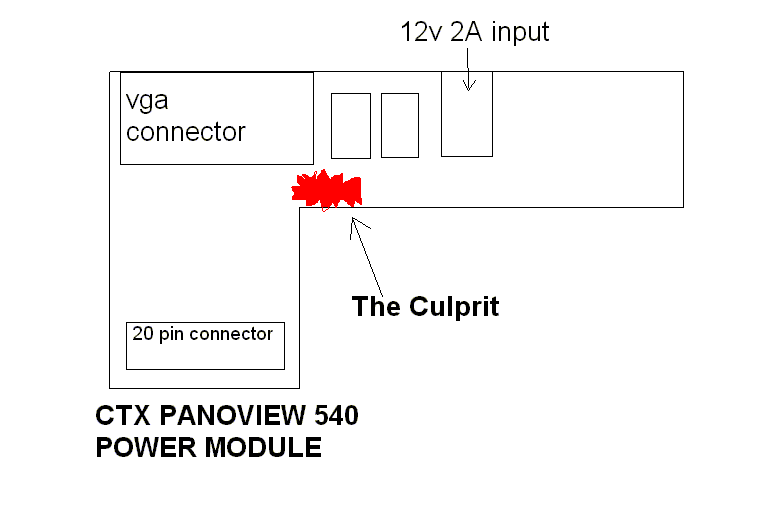

i've had a little accident, i mistakenly connected a 15v supply to the monitor instead of the 12v supply specified & burnt out a little component on the power module board. would you mind if I picked your brains on how to remedy the problem or identify the component so as I can fix it. I have attached a "picture" of the board & the component where-abouts.
ManY thanks & sorry for being a pain
Beemer

ace... remember when i did it and it blew the transistor... you where the one that told me it was because i had disconnected the ballast it overloaded the board.... you can try cutting the ower to it if you like but if it does blow you will know why.
Yess but you dont go cutting tracks on the pcb, i took a single resistior out of mine to turn mine off on just the main power rail only to the inverter, you need to trace the circut and know which way the power travels on the circut, grounds, what the power is going too ect. You told me you blew a diode. If you dont know what your doing, dont do it, its that simple.
Trev🙂
