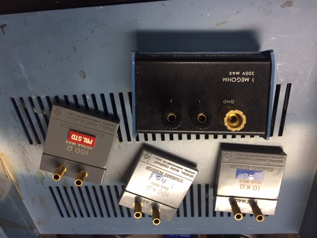

You can borrow these if you promise to send them back -- Genrad and SRI resistance:

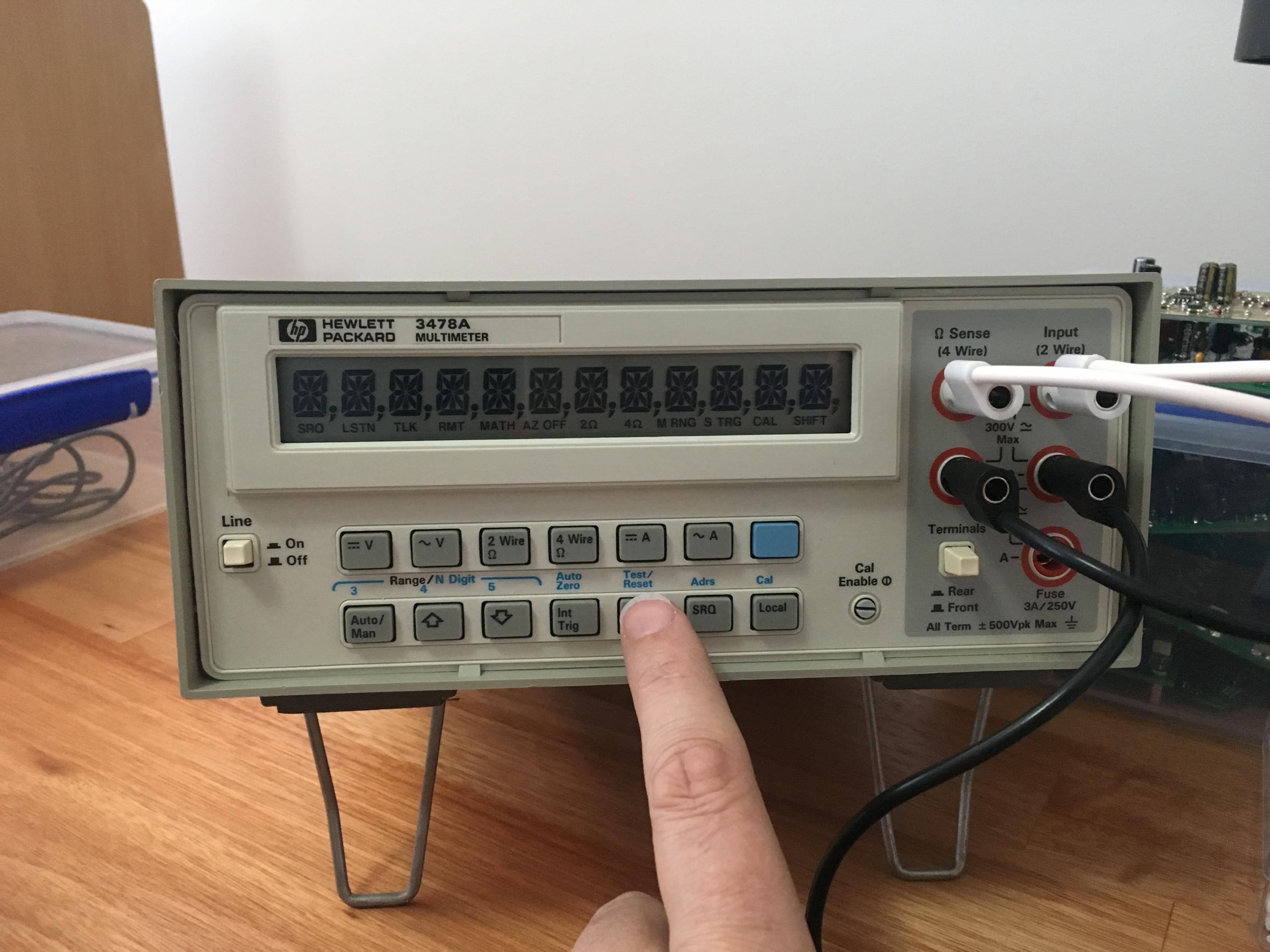

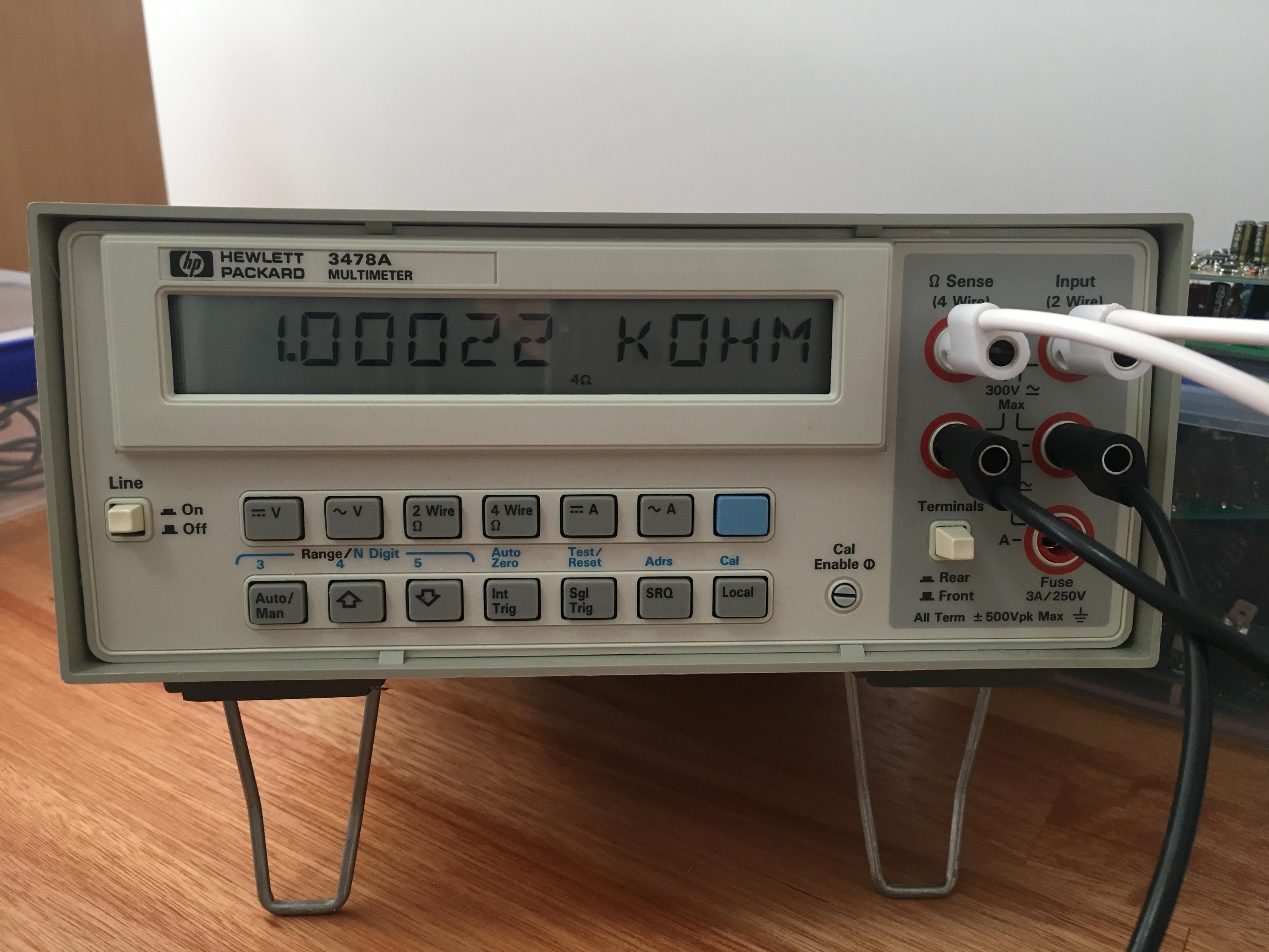

The slightly dim, flickering LCD on my 3478A was bugging me a little, so I fixed it.
First I disassembled the meter. It's not obvious how it comes apart, but once you slide the case off backwards, you remove the screws holding the transformer, regulator, and a couple of grounds. Then disconnect the rear panel connectors (2 x BNC, GPIB, and four rear banana jacks).
Then there are four little tabs on the front that pry up, and the inner part of the front pushes out of the bezel along with the whole PCB. Once that's done remove the display from the rear of the front panel, pop the plastic clips holding the display glass to the PCB, remove the zebra strips, clean everything with cotton buds and isopropyl alcohol and reassemble. Take note of the orientation of the display glass, as it goes back in upside down just as easily as right way up.
While I was in there I gave the plastic cover in front of the display a bit of a polish (light blue polishing compound with a calico mop), as it had a bit of a mark that hadn't been able to clean off.
I'm very happy with the result. The display is much more legible now. Actually the whole instrument is looking quite nice.

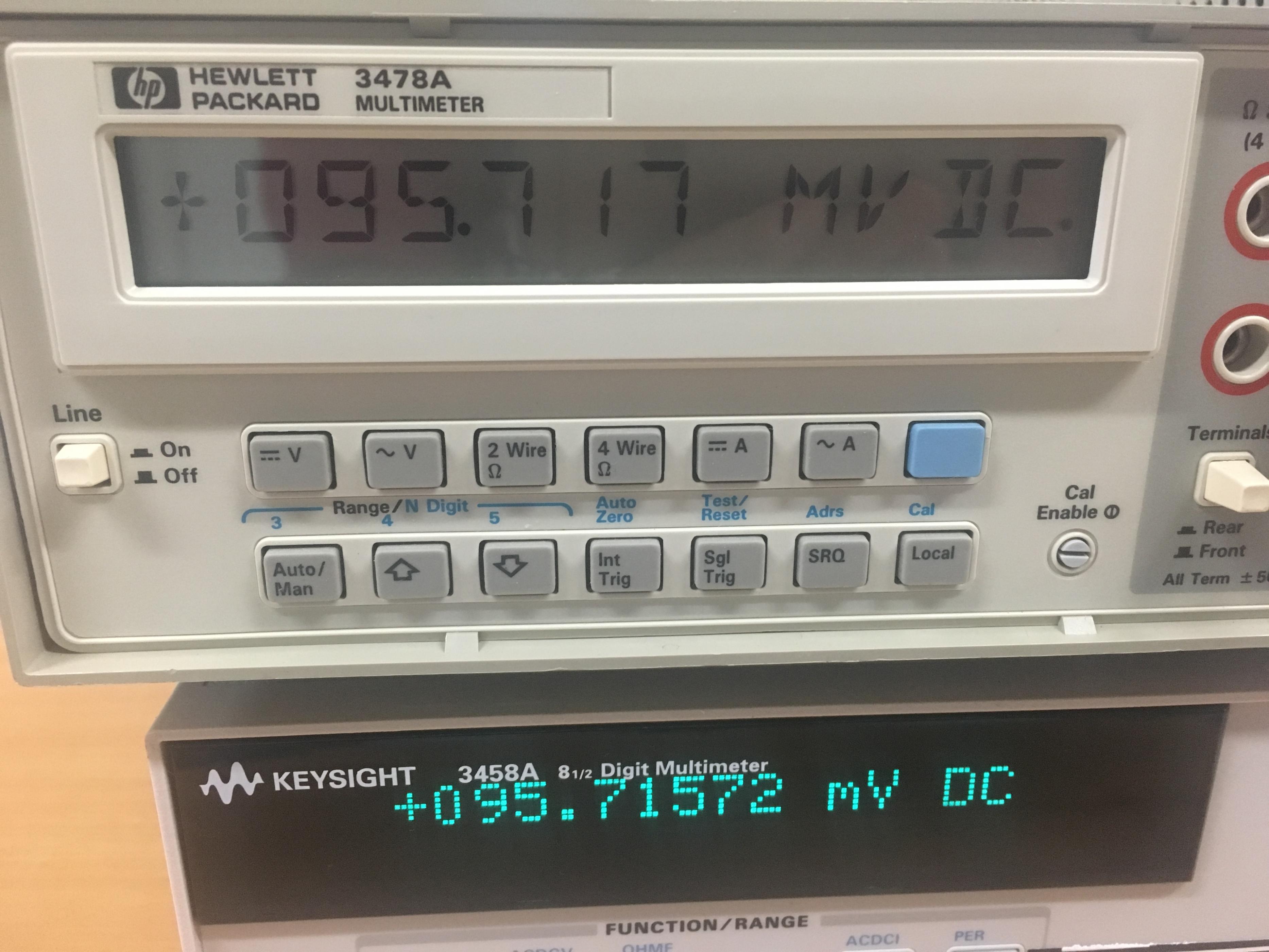

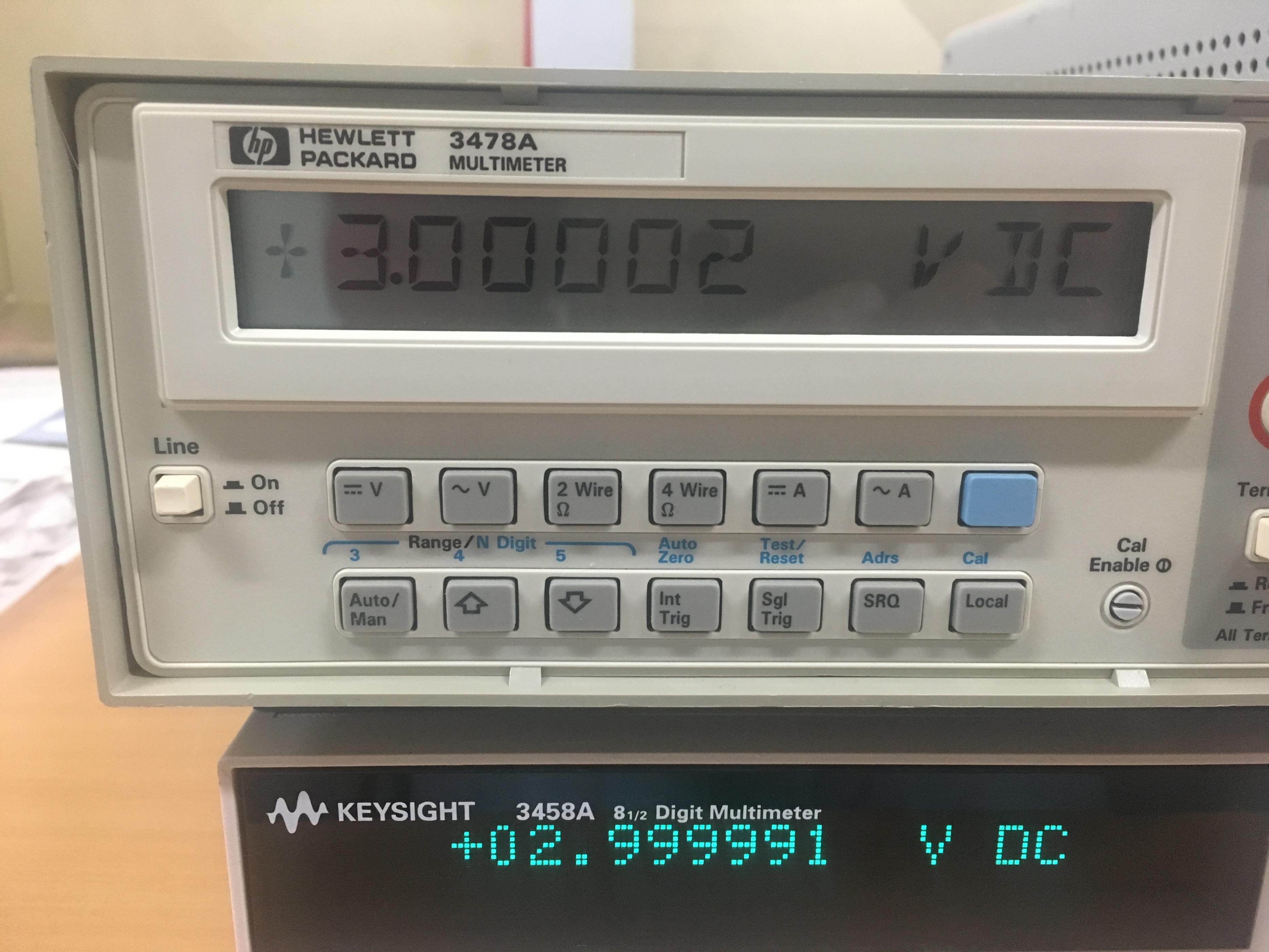

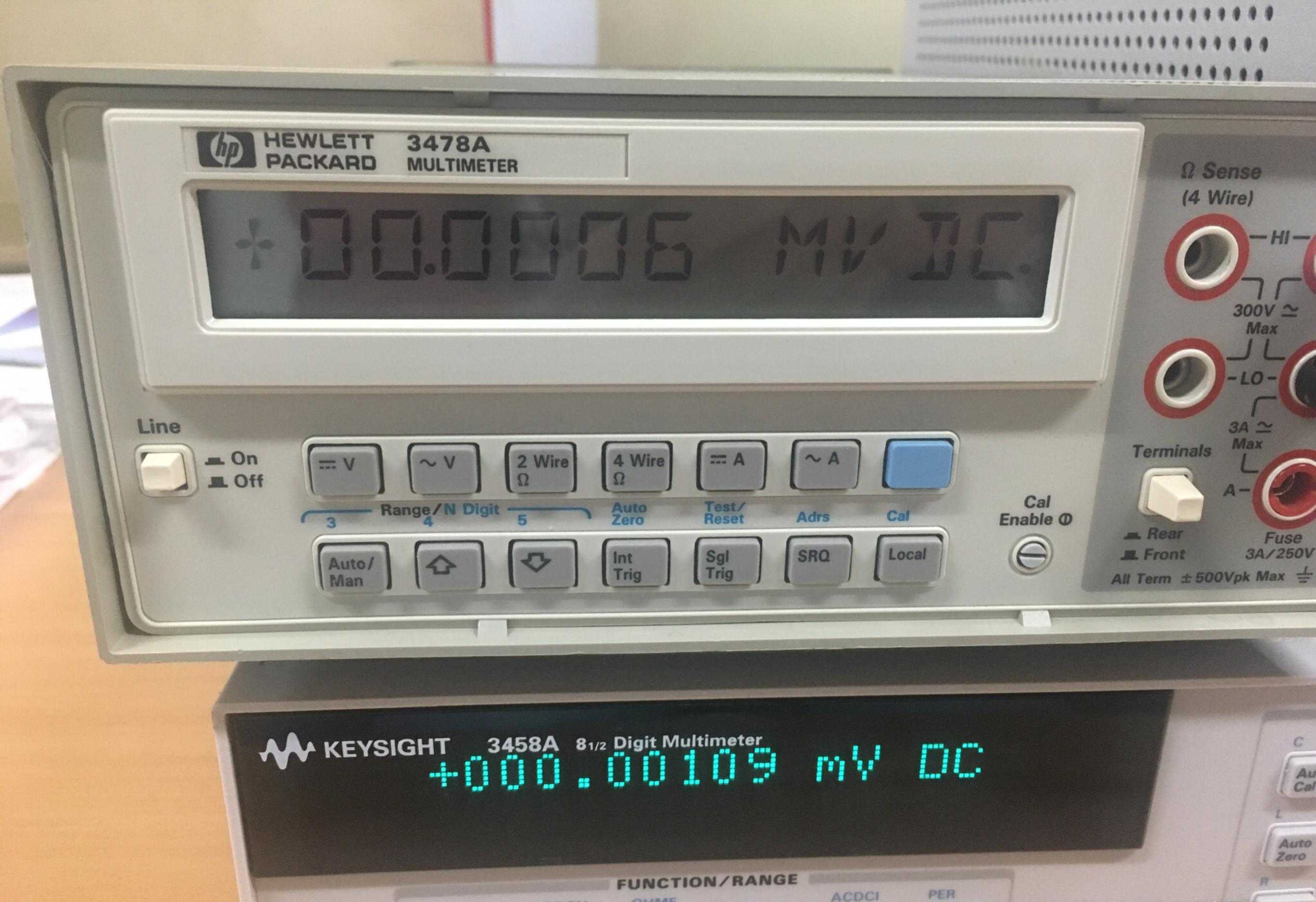

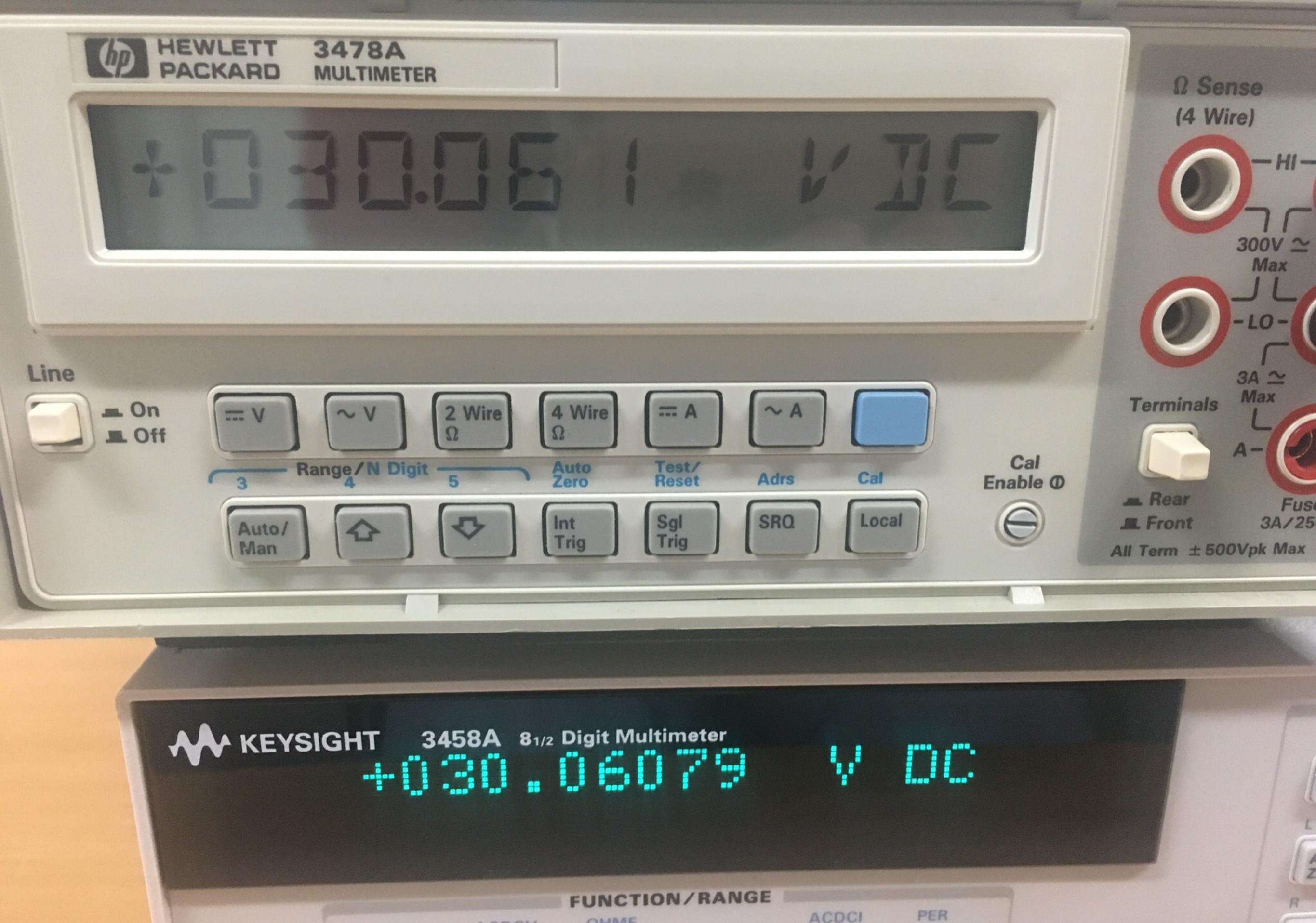

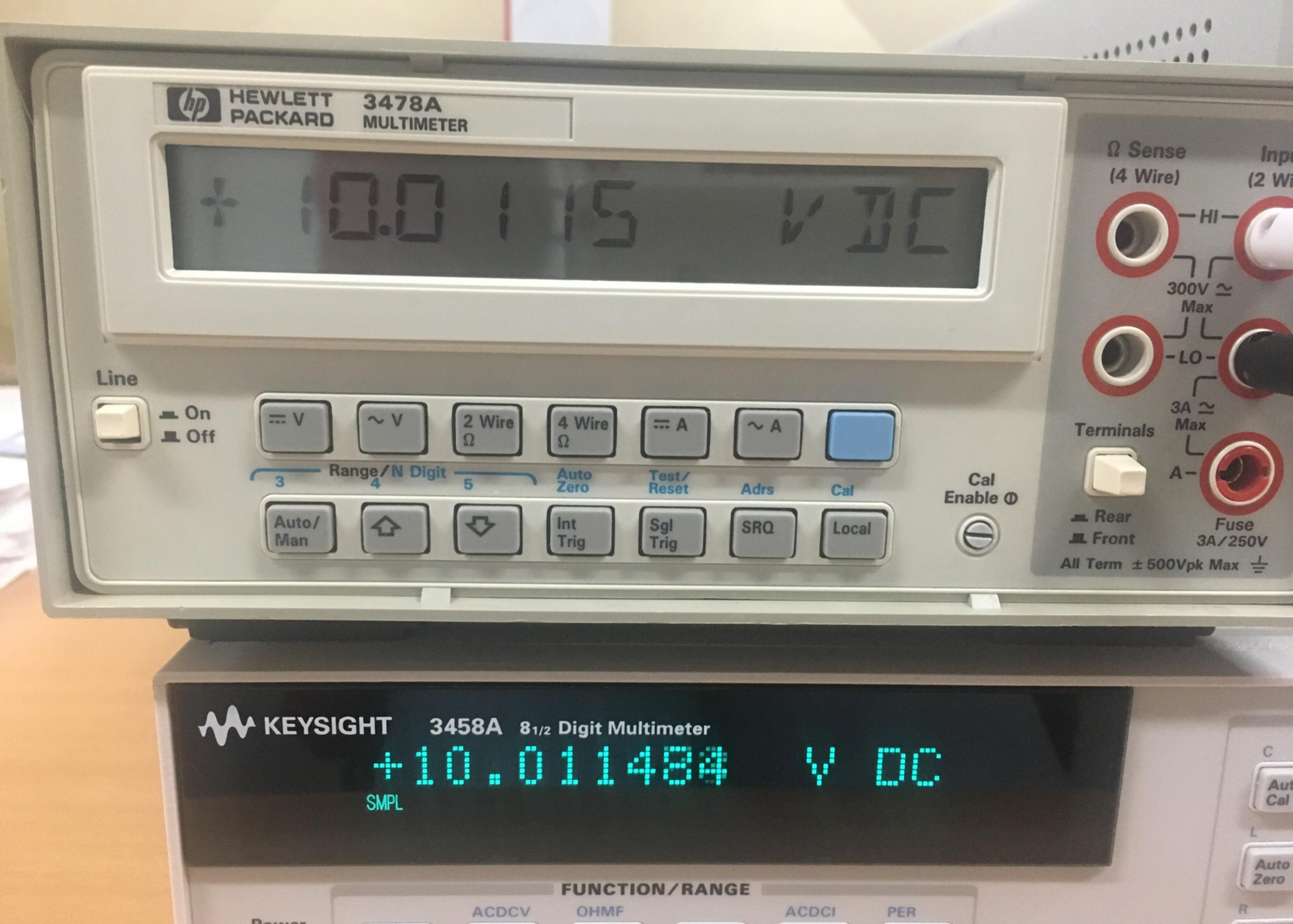

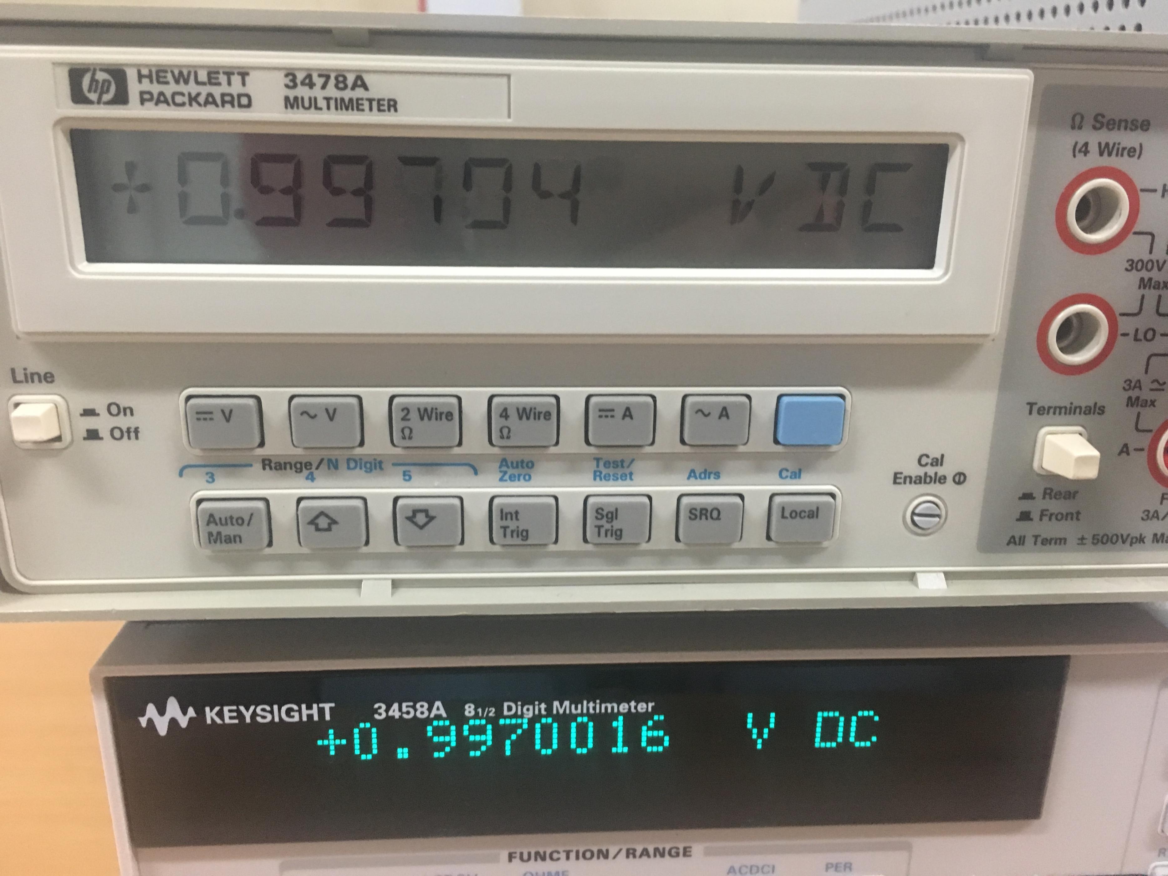

Connected to a lab supply, with the 3458 also connected to compare the cal. The display on the 3458 updates quite quickly, but my phone camera freezes it nicely.
Not too shabby for a 30 year old calibration.
The only downside of putting it next to a new meter is that it makes it really obvious how yellowed it is.
