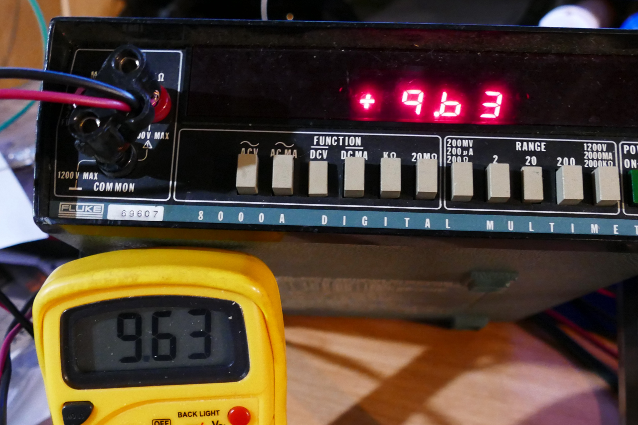

WOOF, WOOF.....This old dog still barks out the right numbers......and it IS an 8000 from the stone age. I did sell my Simpson 260 and Eico VTVM just because someone offered me too much money for them.
The old fluke and the cheapie meter both read 9.63 when connected across a new 9 volt alkaline battery. The 3478 (on a different bench) reads 9.6265 or 9.6266 when connected to the same battery. The $5 Harbor freight meters all read 9.62 or 9.63 on the same battery.
This gives me 100% confidence to believe that the battery is between 9.6 and 9.65 volts, which is good enough for anything I'm doing.......
Beware, most of the cheapie meters are way off in readings if the low battery icon is on. Use fresh batteries, or at least compare all of your meters to a standard (the HP3478) before taking measurements that matter.

I learned a rather shocking lesson about those plain banana plugs like the one stuck in my Fluke 8000 in post #23. Trim the leads flush and put a piece of heat shrink over the plastic part. The ends of the leads stick through and are connected directly to whatever you have it plugged into.
In my case it was a HP6448B turned up all the way. I tweaked some of the adjustments inside so that it makes 650 volts at 1.7 amps. Yanking a plug out when a circuit blew up will leave burn marks on your fingers and cause loss of vocabulary control.

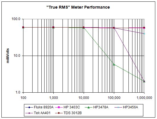

And here's the chart for an article I wrote in AX on Linear Tech's LTC1966, LTC1967 and LTC1968. (Sadly the LT1088 is obsolete!).

Thanks! I’m separately building a Frex RMS-DC board, which is based on the LT1968. Will be fun to compare that to the AD536 in the HP3478A, vs of course the HP3458A benchmark.
