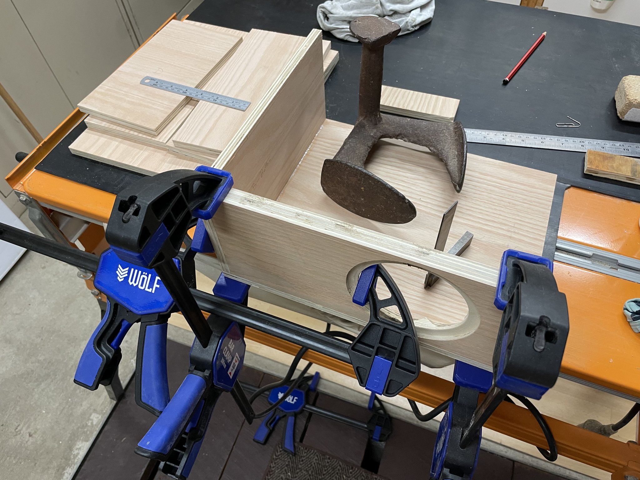

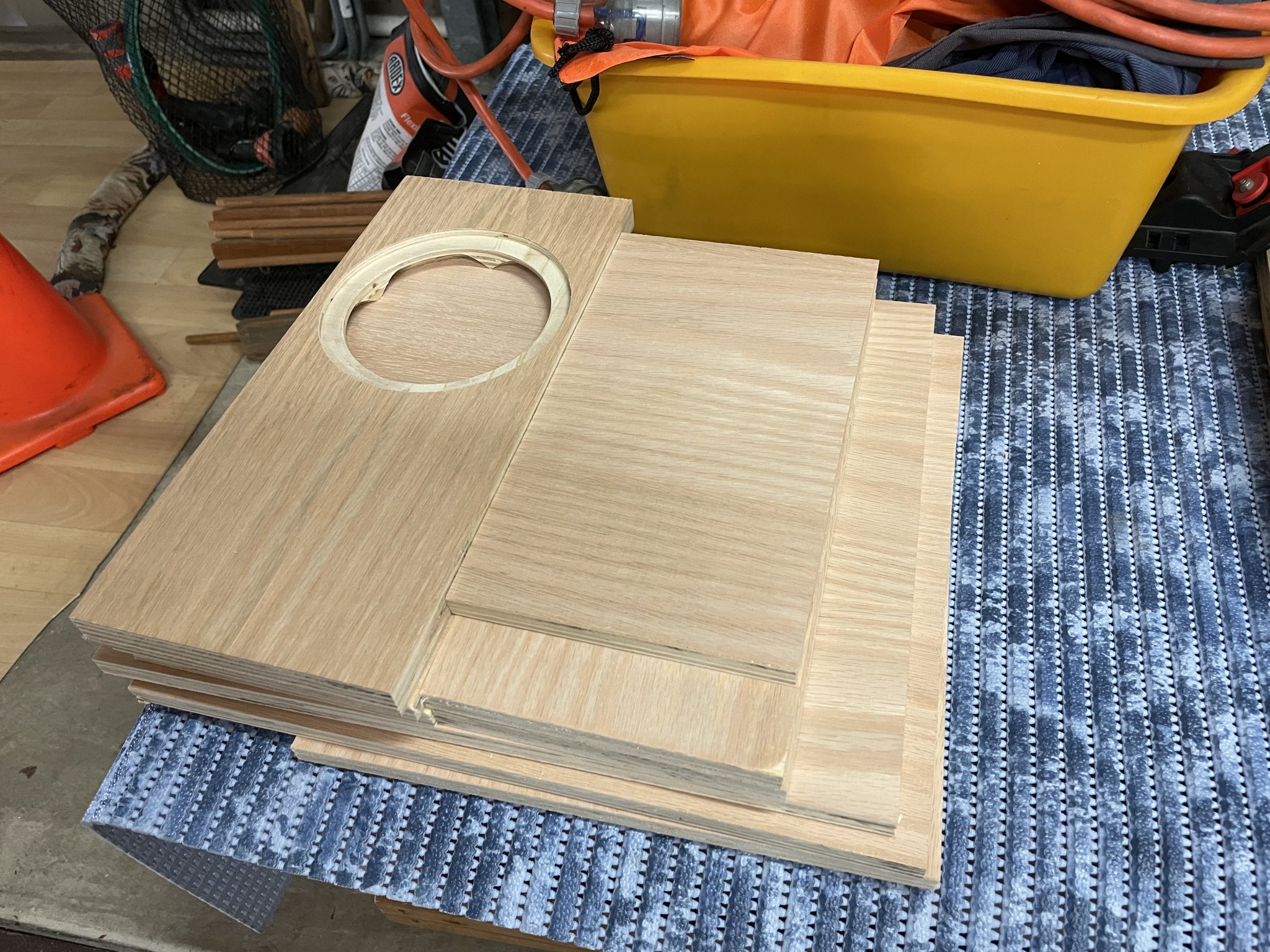

Right, so I’ve kicked off a Storm Shadow build, for the MAOP 7.2s. Have cut up a small sheet of 12mm Red Oak ply, and will be using some spare 18mm for the baffles (sides adjusted to suit). Only have 4 short clamps, so the glue up will be slow. Don’t have any 1/2 inch felt either, but do have some poly acoustic insulation, that I can cut down to the required thickness - do the experts see any flaws in this approach?
Here’s a few pics of progress so far. Getting the cut outs sorted with a diy circle gauge was the most nail biting part so far, but more than happy with the results.

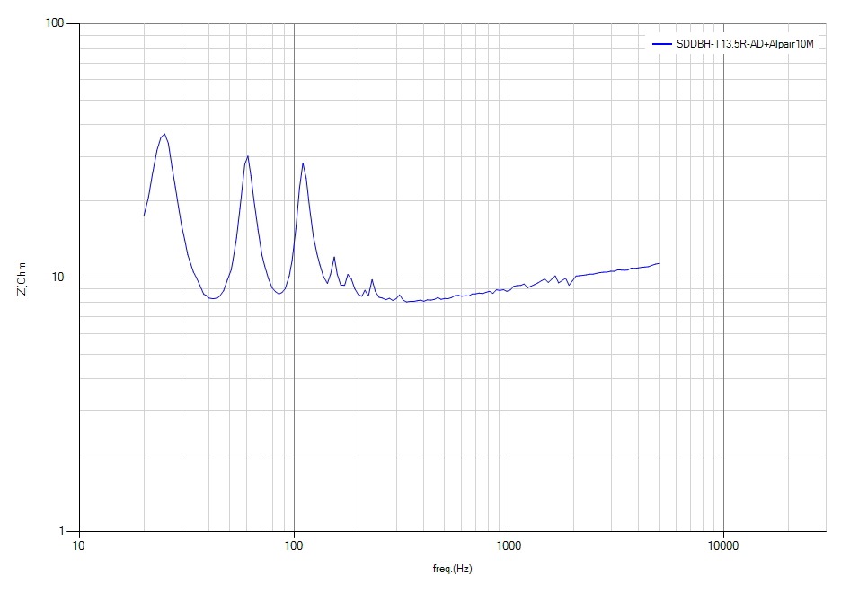

Damped Duct is better decribed as an ML-Voigt (a back loaded horn variation)
Hi Dave,
Based on the impedance characteristics, I believe it would be appropriate to refer to it as a "back-loaded horn."
In my listening experience, I mostly perceive it as a Back-Loaded Horn.
What are your thoughts on this?
Not your typical damped duct design… this one is just weird.
Could probably use some strategic damping to help clean up that impedance curve. Everything aboive the furst 2 peaks are likely audiable.
