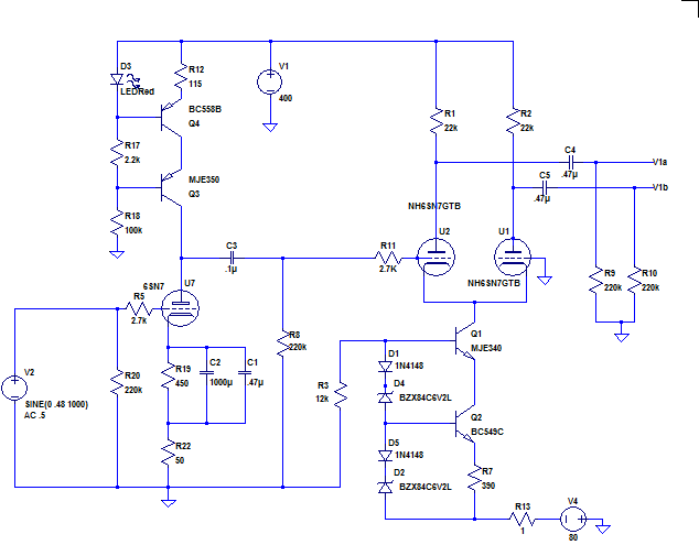

Here is the LTspice schematic. I'm still messing around with operating points. The left CCS is set at 8ma, the right one at 16ma (8ma per tube.) Vi = .35Vrms, which is what I figure Vgk will be after feedback. Vo=45Vrms, giving A=128.
I have breadboarded this circuit and get a little more gain than with LTspice.
I don't have the quad of kt90's included because I haven't figured out how to model an output transformer correctly.
Mike
Mike
Can you send the .asc of the circuit and the tube models you have used.
Then we could simulate too.
I made some modifications to your circuit. I replaced the CCS's with constant current sources because I did not have all the component models you used. But that does not make any essential difference.
I increased R8 to 470k, because there is no point to use CCS to get linear operation conditions and then ruin it with to heavy AC-load. Also 1 M could be used.
Now the THD of the voltage amplifier is some 0.29 % but the THD at phase inverter out put is only 0.16 %, so some distortion cancelling takes place.
The total gain is 43.4 dB and the gain of 1st 6SN7 is 26.3 dB.
Not a bad circuit at all, but I would use 6SL7 as the 1st tube to get some more gain. You can now fine tune it further.

Adequate for what? Reducing distortion? Reducing output impedance? Reducing hum? In each case, you need to know what the non-feedback value is and what value you would like to achieve.mskl99 said:is 12dB FB adequate?
I was planning to use no more than 12 db for this amp, because if I use more, I don't have the necessary amplification (with 6SN7's) to deliver the 44V RMS required by the kt90 grids at full volume. Assuming I plod through and end up with a pretty good design, is 12dB FB adequate? If I go higher, I need a different tube, or another stage.
Thanks,
Mike
It depends. For the Vixen design, 12dbv of NFB works just fine distributed between gNFB and lNFB. For the Le Renard, 6dbv is more like it. That design has variable gNFB only, and the full 13dbv of gNFB is definitely tending to a "solid statey" sound. Backing off helps bring Techno and Metal to life. 12dbv would be a good, general purpose, level of gNFB if you weren't adding variability.
As for how KT90s are, no idea. It depends on the harmonic distortion profile, what your preferences are, how the finals interact with the front end. It's basically a case of try, listen, evaluate, and adjust.
