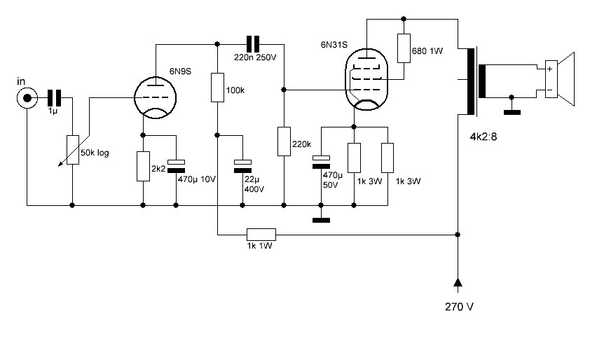

Maybe I am confusing the original topic, as but we earlier discussed about distortion cancelling, I dare to come back to this subject.
I am presently nibbling with a simple SE amplifier with soviet made 6F5P (ECL85) triode-pentode.
The best operating condition for the pentode halve alone I found was a UL-connected with +Ub = 200 V, Ia = 40 mA and Ug1 = 22 V. The opt is 5k2.
I can get 2 W with 4.5 % THD. The clipping takes place at 2.5 W.
When I add the triode halve of 6F5P as voltage amplifier and bias it to optimum by only observing the THD at the output, I can get the same 2 W, but now with less than 1 % THD. No NFB is used.
The circuit is basically equal to what I presented at the post 20 earlier, but with different resistor values.
At the triode, Ra = 47 k, Rk = 2.03k (adjusted to optimum), Ua = 147 V.
And all these results are with real circuits, no LTspice simulations.
I have to say that the amount of distortion cancelling is amazing in this case.
