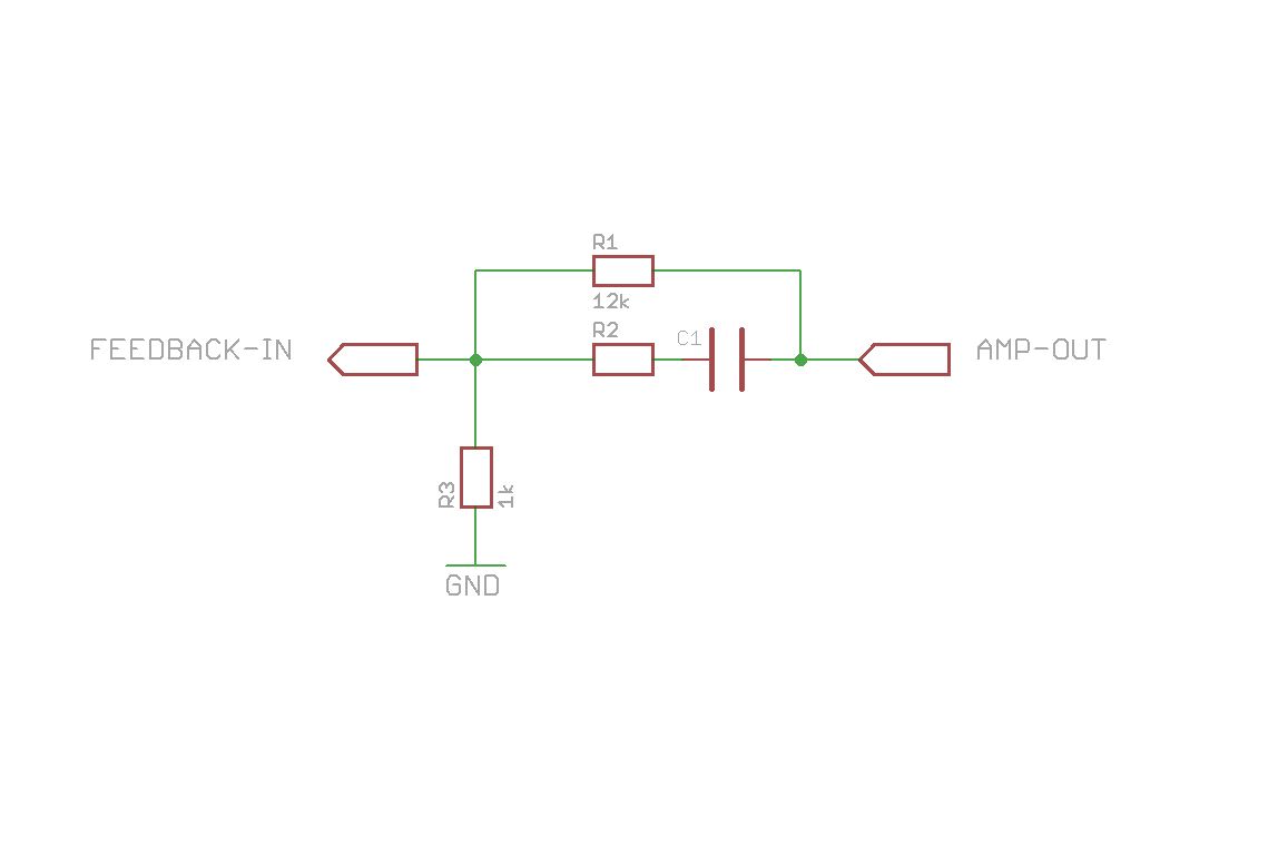

I have an amp simulated and as real device, but I've some problems to simulate it's open loop gain. Is there anything out as info that can you recommend to read ?
Next problem is the compensation of the amp....At the moment there's only the capacitor across B-C of the VAS transistor...but there I must put >300pF in to get the amp stable at any load (in the real world). What's about a second order pole in the feedback ? In the simulation that works fine...but in real world ?????
Thanks.....

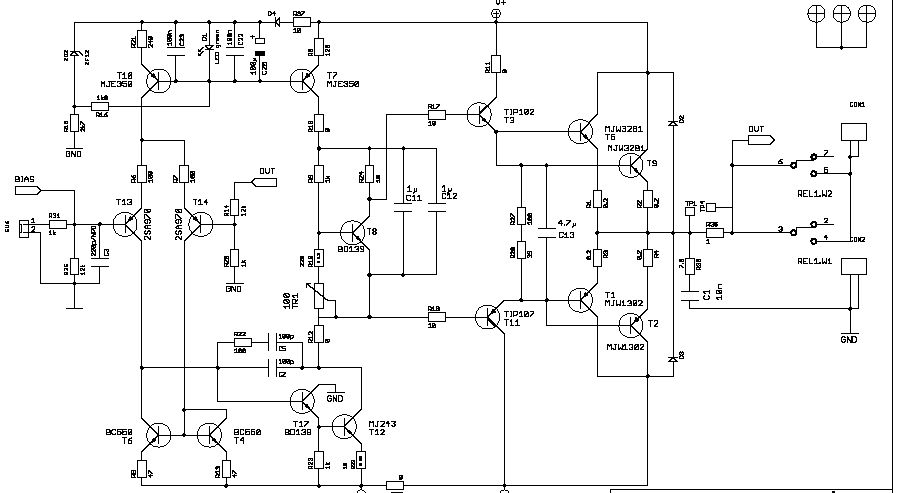

You have a supply rail filter D4 + R37 (10 Ohm)
I would rather put this before the VAS Constant current source.
So I should move them to the right of T7.
Current sources benefit from clean, constant voltage supply.
And this is what the filter D4 + R37 helps to give. su

So I've Open Loop gain... the compensation in the simulation works fine (just where I want it) and I also get best results in simulation... but bad results in real world :-(
One prototype (breadboard) is performing well... the PCB type seems to be instable.... mhhhh... can the emitter resistors make an amplifier unstable ? There where other types on the breadboard than on the PCB....
Why not darlingtons ? capacity too high ? They make unbelievable current gain 😎
Oscillation city... standard MJE15032/33 drivers will give 2k hfe in a standard EF2 output stage and will allow the "blameless" to run on a single 33/47pF Cdom rock solid. I don't lie , i'm building my 10th pair of your amp "ax" below.

It has a darlington VAS and this type is always difficult to tame, you need good layout, lot of compensation and some luck.Because of this I never use darlington VAS in amplifiers and if you look at commercial amplifiers you will see that it's also very seldom used.

I dont know if you have told your voltage supply.
I will assume clear below +/-40 Volt
Input stage.
Think it looks very good. The idea is absolutely right.
I am unsure how much current you have here.
You use a GREEN LED + MJE350 for current source.
My guess is above 2.5 mA per input transistor.
Now, almost nobody uses green LED.
Because RED LED + transistor gives more constant current. A better current source.
If we assume < 40V and 5 mA we can use BC560C in CCS (constant current source)
Because less than 200 mWatt is okay for a 500 mW device.
(I would say we should avoid to get above 250 mWatt for 500 mWatt devices.
That is, for small signal transistors do not use more than max 50% of the max power rating)
I be back with some thoughts on VAS, if you want.
But Ostripper has already given some good advices.
He is very clever and knows much. More than me 😀

You can use green led as current source , the only difference is 2.2v Vf instead of of 1.65-1.7V for red LED. A 150R Re for the red led might be a 180-200Re for the "greenie" , no biggie!!😀 Do the math . (or let the sim do it for you)
I use all 4 colors (blue/green/red/yellow) , even for CCS's. 🙂
