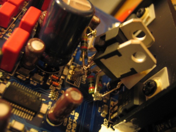

Is that resistor across pins 1 and 5? Is it worth doing?
You're not bored of it already?! 😉
You mean pin 4 or pin 8?
For an NE5532 or LM4562, it should be pin 4, but since the OPA1612 has a rail-rail output stage, I put the resistor across pins 1 and 8 (main amplifier output and V+). This is to make most of the current go through the NPN and less through the PNP.
My observation is that it helps. To be honest, I first connected the resistors accidentally to the V- supply and noticed the sound getting worse!
Next step should be to clean up the V+ supply. I already improved it a bit by using Panasonic FM instead of stock on the inside 1000uF caps C402/403 (on the outside caps C76/77, this is not possible, because the caps would hit the casing). Obviously, having all that supply ripple and noise fed to the output stage is not so great.
I'd be interested in the results after kicking out the LM7805/7815/7915. Even using two mass-produced LM317/337 in tracking-preregulator configuration should give a massive improvement.

Yes, sorry 1 & 8! My bad 😀

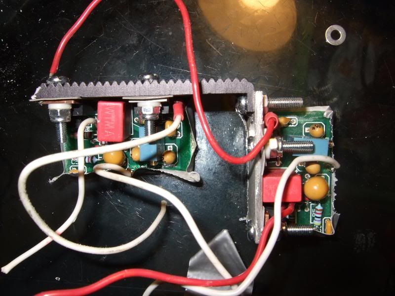

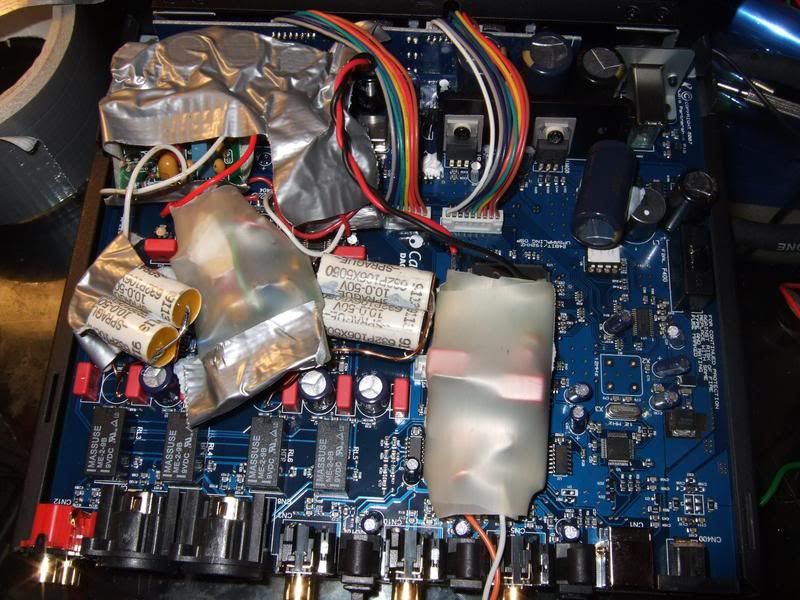

The +15/-15v Teddyregs are now fitted. I don't think i'd ever want to do that again, because they were a right pain in the bum to fit. I had to cut a piece of a aluminium and bolt it onto the side of the existing heatsink (I used some Arctic silver 5 thermal paste in the joint)
Here's a picture of the Teddyregs attached to the bodged heatsink:

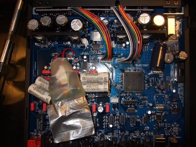

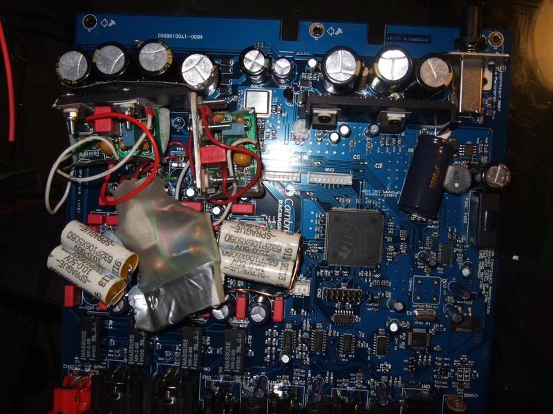

Here's a pic of the regs in the Dacmagic:

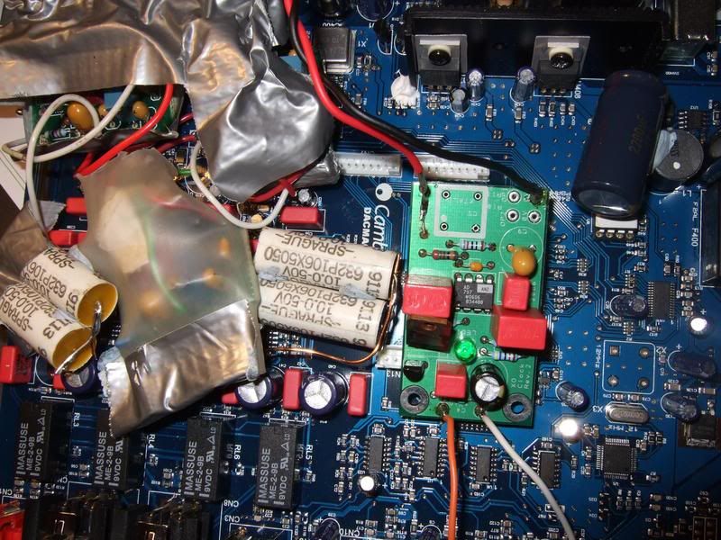

And this one is with just the one Teddyreg feeding the dacs:
yes, ferrite bead FB5 should be removed in order to supply crystal with clean power. Don't forget to remove FB4 in order to supply U14 with clean power. U14 is distributing MCLK to DSP and DAC chips 😀

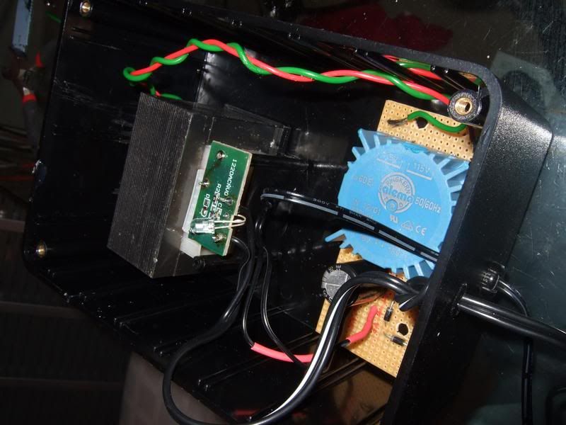

Puttering about the Dac Magic

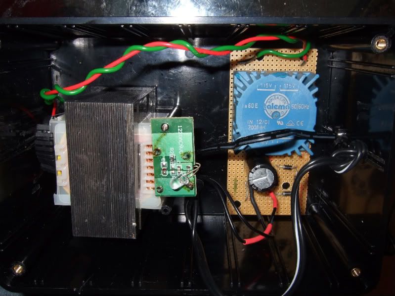

Actually I want to keep the DM as original as possible. I might throw the EI core away and use a toroid instead.
I was told that if I simply replace the regulator inside the DM, it would not make any difference. Since It is the construction of the power supply and not the regulator, that is the problem.
So i might stick with swapping capacitors and op-amps.
I also heard that a single channel op-amp sounds better than a dual op-amp. So I'm looking for a so called brown-dog converter. This should allow me to install two single channel op-amps, in each dual foot-print in the DM. But I'm still in the research fase 😱)

More Pictures

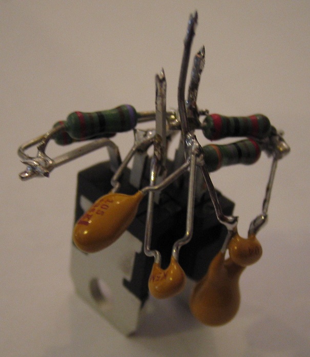

LM317s in pretracking configuration feeding the DACs, as on page 20 of National's LM317 datasheet (variable resistor fixed at 360 Ohms to give 5V output, ADJ pin of the output reg decoupled by 10u tantalum + 100n ceramic). They should be easier to fit than the TeddyReg and still give >100dB PSRR.
Also, I now put 20k resistors across pins 6 and 8 of the output (OP275 turned OPA1612) op-amps to give the coupling cap some DC bias. This will prevent the oxides from degrading and should give a considerable lifetime improvement. As an added bonus, the new bias setting should draw some current from the NE5532s, biasing also those little bastards more into class A 🙂
