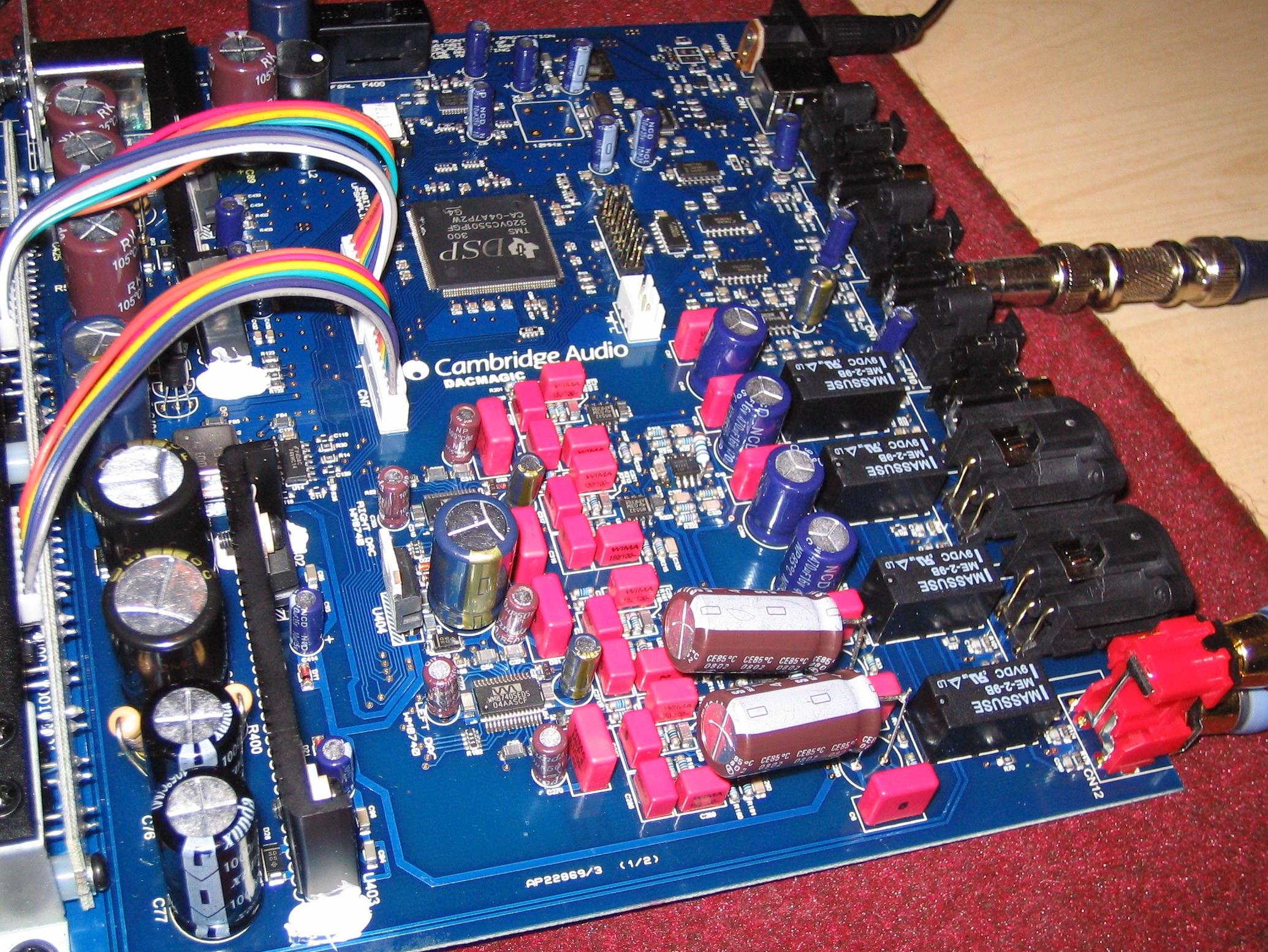

Yet Another Picture
Since the Elna caps have larger footprint than the stock NPs, a little creativity was required 🙂 . This could give trouble when trying to fit AD797s on Browndogs...
The observant viewer may notice an 11k class-A bias resistor across one of the OPA1612s.

Is that resistor across pins 1 and 5? Is it worth doing?
