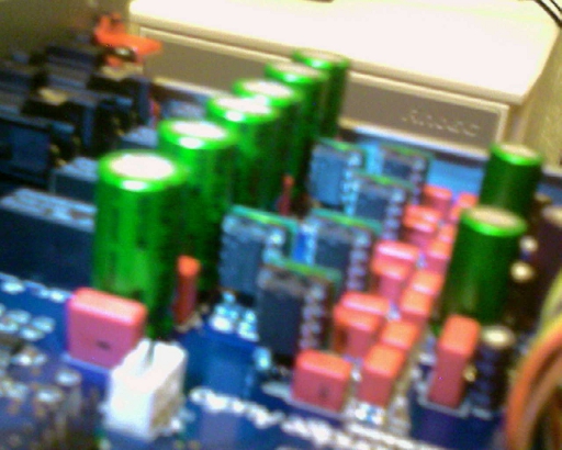

The SO8 op amps (U55/56/59/60) are 5532's, I have changed them for 4562MA's in SO8. Early days yet but they sound fine a day in and will probably get better as they burn in. If you haven't changed SMD IC's before they are tiny and the PCB tracks are thin and fragile so be careful. The first IC was hard work and the PCB track repairs took ages, the second IC was much easier and the tracks just needed a quick wipe with the iron tip!

I accidentally lifted two solder pads and melted some film caps when trying to desolder the opamp at U60. Somehow everything works fine, including the caps (though I'm going to replace them anyway; don't like the burned look). The Browndog I put in there seems to be held in place by the remaining pads.PCB tracks are thin and fragile so be careful.

Okay, now for the upgrade plans. I've noticed that Fidelity Audio is using polarized caps around the DAC chips in their upgrades:
Makes sense, considering they are power supply decoupling caps. I'm going to replace them with Panasonic FC/FM when they arrive, same with the 10uF caps near the regulators. I'm also going to install TO220 sockets in place of the regs so that I can easily swap them without soldering.
