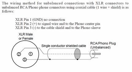

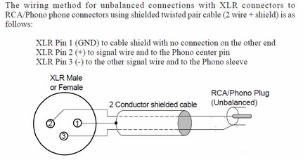

I have one of these. A few things:
Do 2) and 3) and it's a much better sounding unit, and it was already great.
First phase, few days ago: I've shorted all of the output caps and added the Maplin XLR -> RCA leads pictured above. As mentioned before, pin 3 in this ready made lead was going to the RCA ground. For neatness, I know have two wires going to pin 1 (ground).

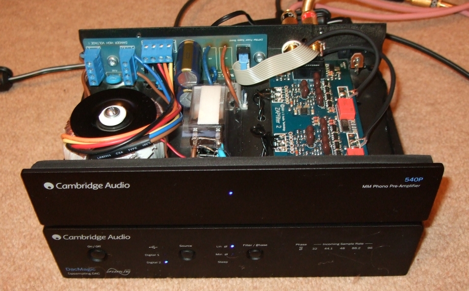

Second phase, tonight: Added two 5 Volt Audiocom super regs (MK1) that I had in my old CD player. They barely fit. Height is the issue but laying them diagonally works. If I had a second attempt I'm sure I could make them fit slightly better. I think the later Audiocom regs are shorter.
Next phase: Would like to try a Maplin power supply when they're back in stock. Upgrade caps for better quality. All of the caps in the Dacmagic are 105 °C.
I've got some pictures before the regs went in which I'll post soon. :)
