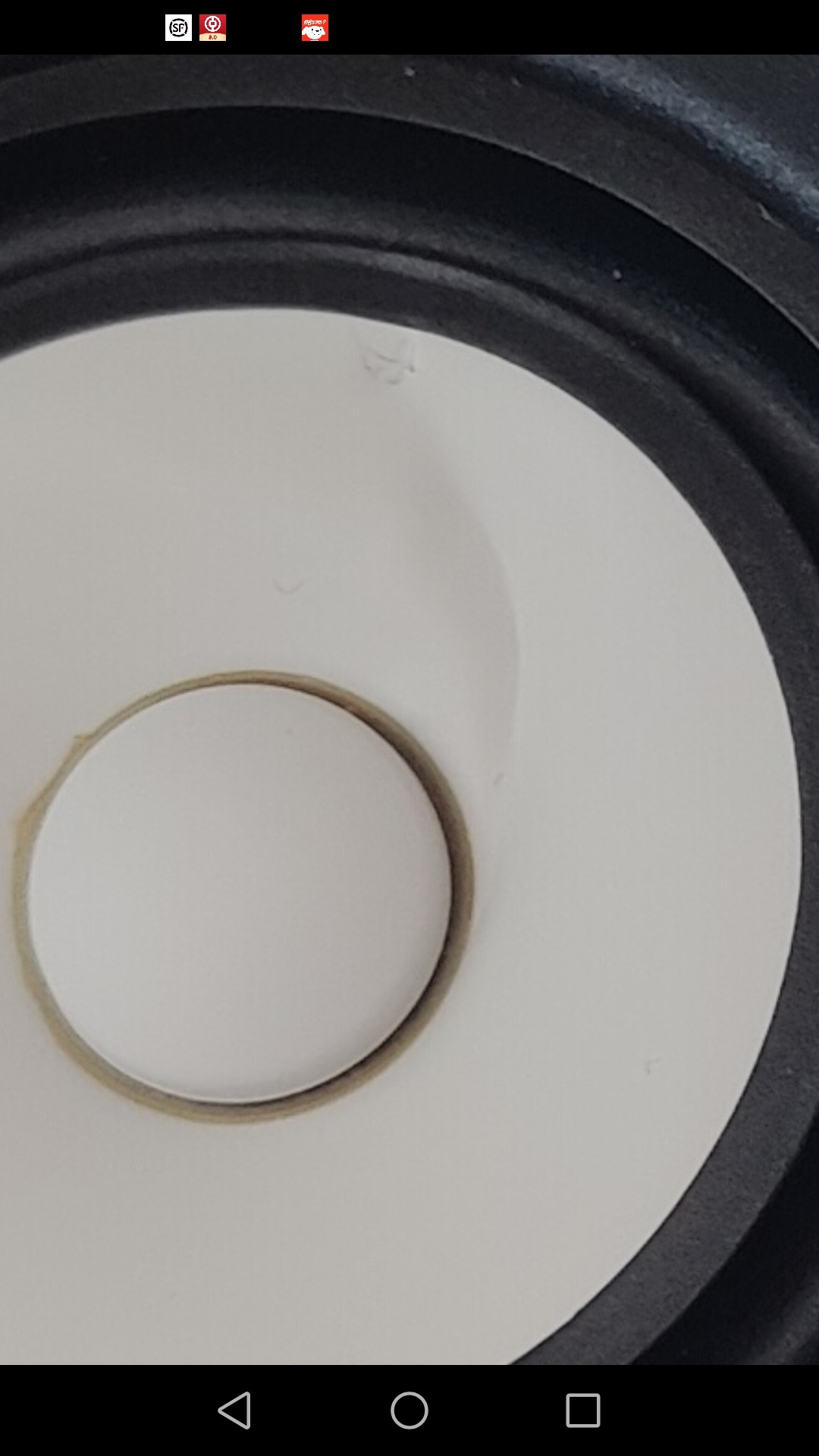

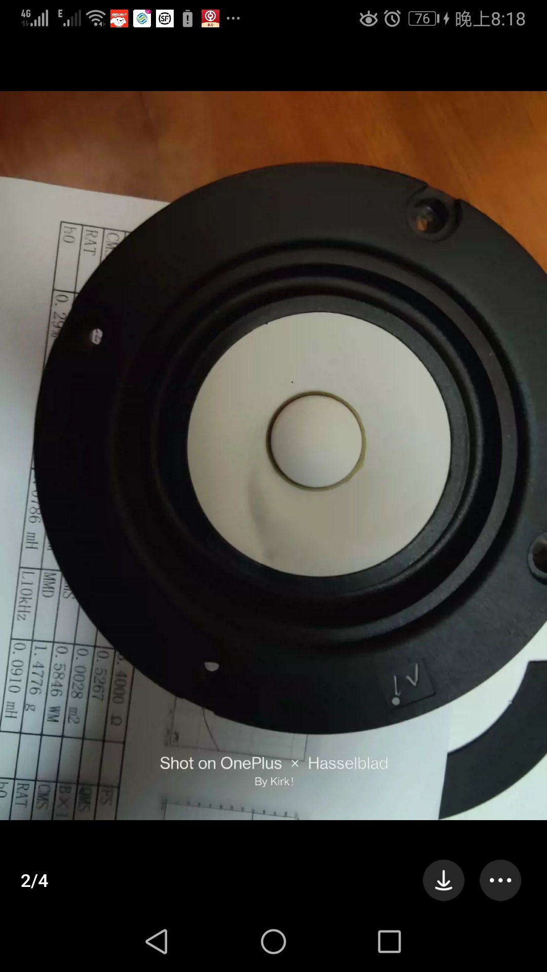

Yesterday I rescued someone's damaged-cone MAOP 5 (gen1) and just listened to it box-less (back of driver wrapped) assisted by the Alpair 10.3 firing sideways out of a simple 10L. (The 4ohm 5 and 8ohm 10 are connected in series to favor the bass.) The dipole-bipole's combined response is basically flat 100-10khz, only a very small residual hump ~7.8khz from the 10 (mentioned in msg #16).In my limited experience with Markaudio, Alpair 5.3 has better HF and Alpair 10.3 has better LF. So I would suggest three possible extensions to your OB: (1) add 10.3 low-passed and/or not facing front; (2) another 5.3 push-pull or sealed; or (3) add wings and stuffing to make OB-U.
My total cost of the "five-and-dime" was only half of the MAOP 10 whose chart also showed the peak and may be NLA. All I had to do was un-deform the cone a little bit to stop the rubbing; passed my tone sweep comp listening test. Next I will get a real cab for the 10, likely a small TLonken, although the combo sounds pretty jaw-dropping as-is.
