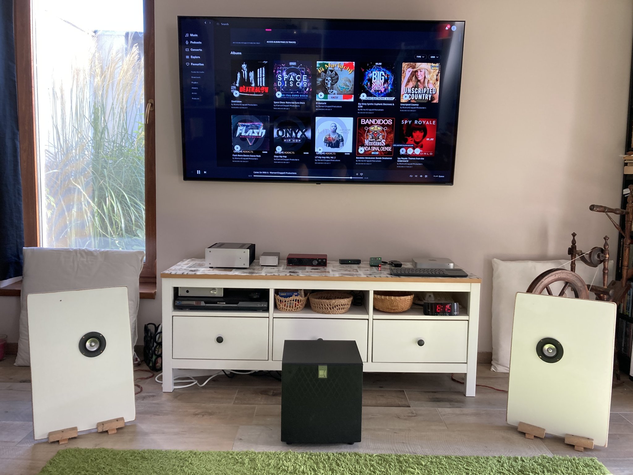

Hi there,
Currently I have an OpenBaffle system in WAW arangement with DSP corrected frequency response.
The used driver is an Alpair 5.3, crossed actively at 200Hz, and a KEF sub is working downsters.
I am really satisfied with the sound this system produces: Very clean sounds and good imaging, really good dynamics... The singer highly seems to be in the room.
My only problem is, that the 200Hz crossover frequency is a bit too high for the sub and too low for these drivers. It would be much better to lower the frequency to 150Hz, or further below.
My question is:
Which MarkAudio driver would be the best choice to replace the current one? Paper or alu cone?
The cone material is less important as far as LF crossover frequency goes than size. Strictly speaking, things start becoming more obviously directional > 70Hz, so you really need a pair of subs / woofers, one for each channel, if you're crossing above that. Assuming that's not viable due to cost, space etc. considerations, then the largest driver option you can manage is really going to be your best policy to ensure power-handling / headroom stays as high as possible, especially since you're equalising it.

Strictly speaking, things start becoming more obviously directional > 70Hz, so you really need a pair of subs / woofers, one for each channel if you're crossing above that.
I did not felt any drawbacks on bass directions. My main motivation for driver improvement is a huge sound level fallback at crossover point and a slight rise of distortion of the drivers.
In my limited experience with Markaudio, Alpair 5.3 has better HF and Alpair 10.3 has better LF. So I would suggest three possible extensions to your OB: (1) add 10.3 low-passed and/or not facing front; (2) another 5.3 push-pull or sealed; or (3) add wings and stuffing to make OB-U.
My 5.2 TLonken goes down near 40hz. The driver by itself has a natural rise around 110-120hz so your XO region should be fine if OB cancellation is controlled a bit.
...then the largest driver option you can manage is really going to be your best policy to ensure power-handling / headroom stays as high as possible, especially since you're equalising it.
The main 'power region' for music (especially orchestral, which is generally the most demanding in this sense, so a good 'conservative' guideline) is < 500Hz, with a lot being concentrated in particular between 100Hz - 300Hz, so a bit of cone acreage handling this BW is no bad thing. How much will depend on your average SPL at the listening position & how much headroom you want from that, but since you say you need more output & lower HD (i.e. shift more air), then all other things being equal, a bigger driver is your friend.

The Alpair 12PW is discontinued, so unless you could find a pair still sitting on a dealer's shelf, that unit is something of a moot point. ;) The manufacturer as far as this goes is immaterial: if you want more dynamic range, all other things being equal, you need a larger driver that can shift more air. That could be an MA unit, it could be from another manufacturer, be it Fostex, SB, Lowther, Tang Band, Dayton or whoever you favour. That's just a law of physics unfortunately -you can't beat displacement. To a point, increased excursion helps, so you can get away with something a bit smaller, but the price is usually efficiency so this only gets you so far. In your case, that would mean something larger than the nominal 3in category the Alpair 5.3 resides in -how much larger & what being up to you of course. There are plenty of drivers out there to choose from.
Joined 2008
How much high frequency extension do you require? Alpair 10s or 11s (I’m no expert on the MA models) would be able to go lower, but even so, the OB roll off starts way above 100Hz unless you have BIG drivers. I doubt a slightly bigger full range will make the gap to your subwoofer, though you may be able to get there with your DSP EQ.
With OB, you may find you need at least a simple 2-way crossover between the A5.3 and a bigger driver on the baffle, plus the sub(s).

Most OBs require helper bass drivers.
Unless signifcantly more levels are required the only MA driver that likely beats out the A5.3 midTop is the MAOP 5 variation.
Rather than swapping the midTweeter i would first consider improving the bottom end.
You should read thru Martin King’s p[assive OB article it has some significant clues to getting the XO right. Your 200 Hz XO is likely too low.
