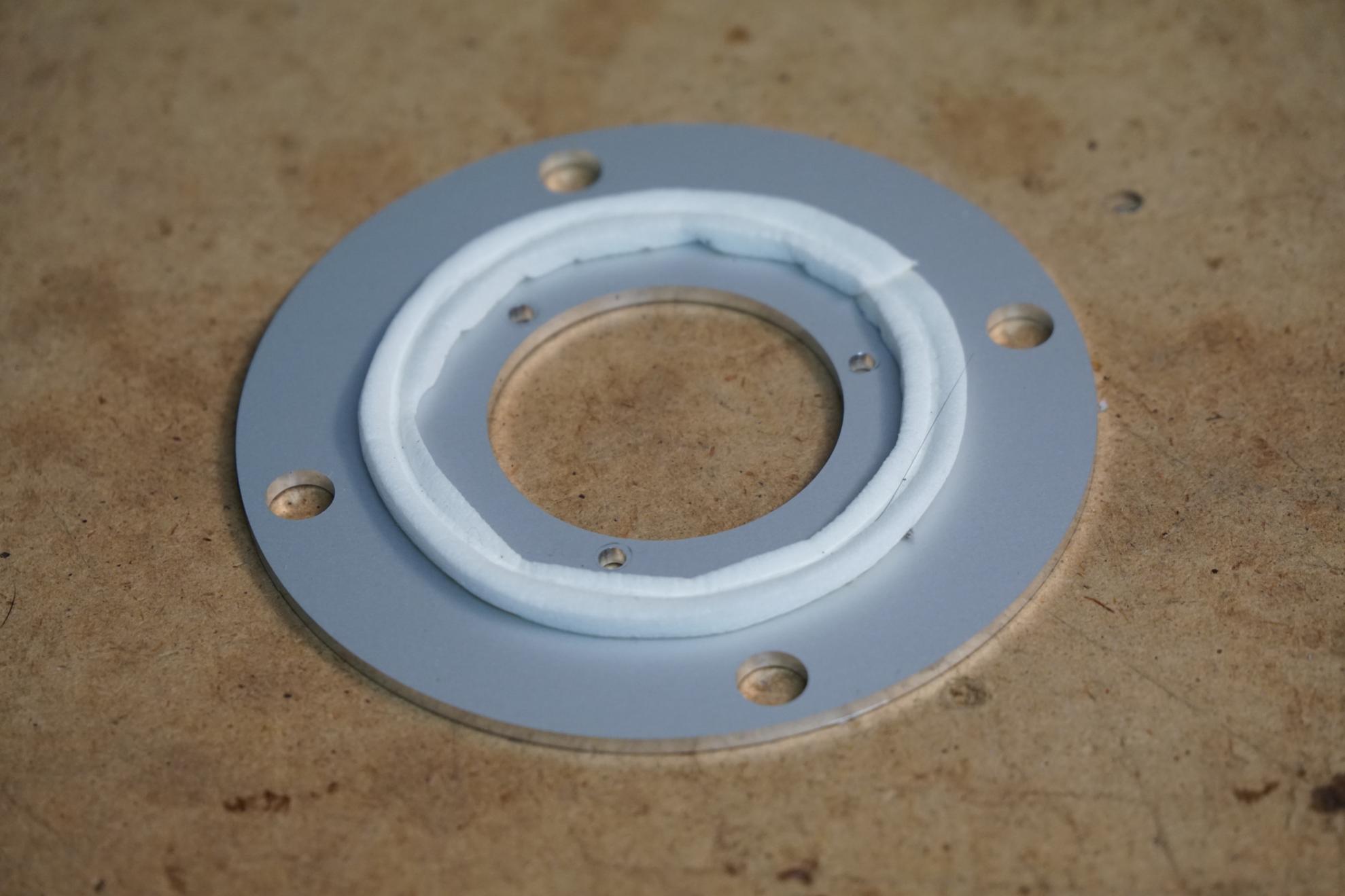

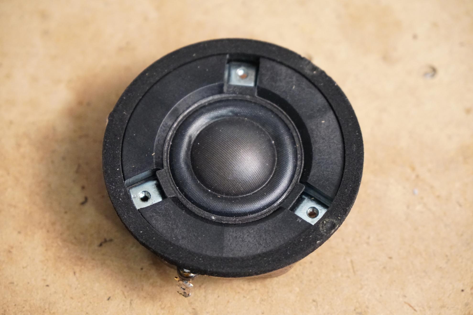

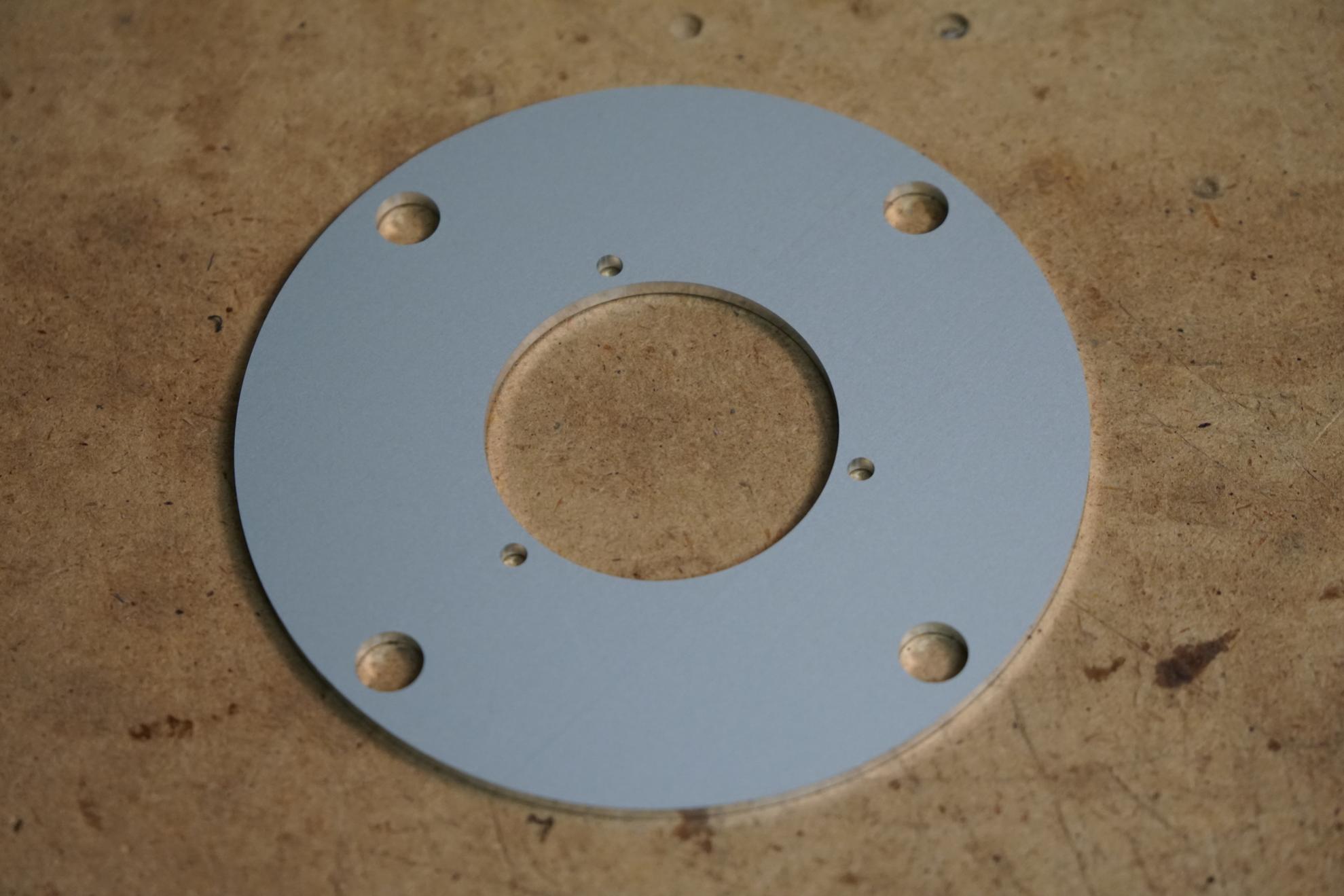

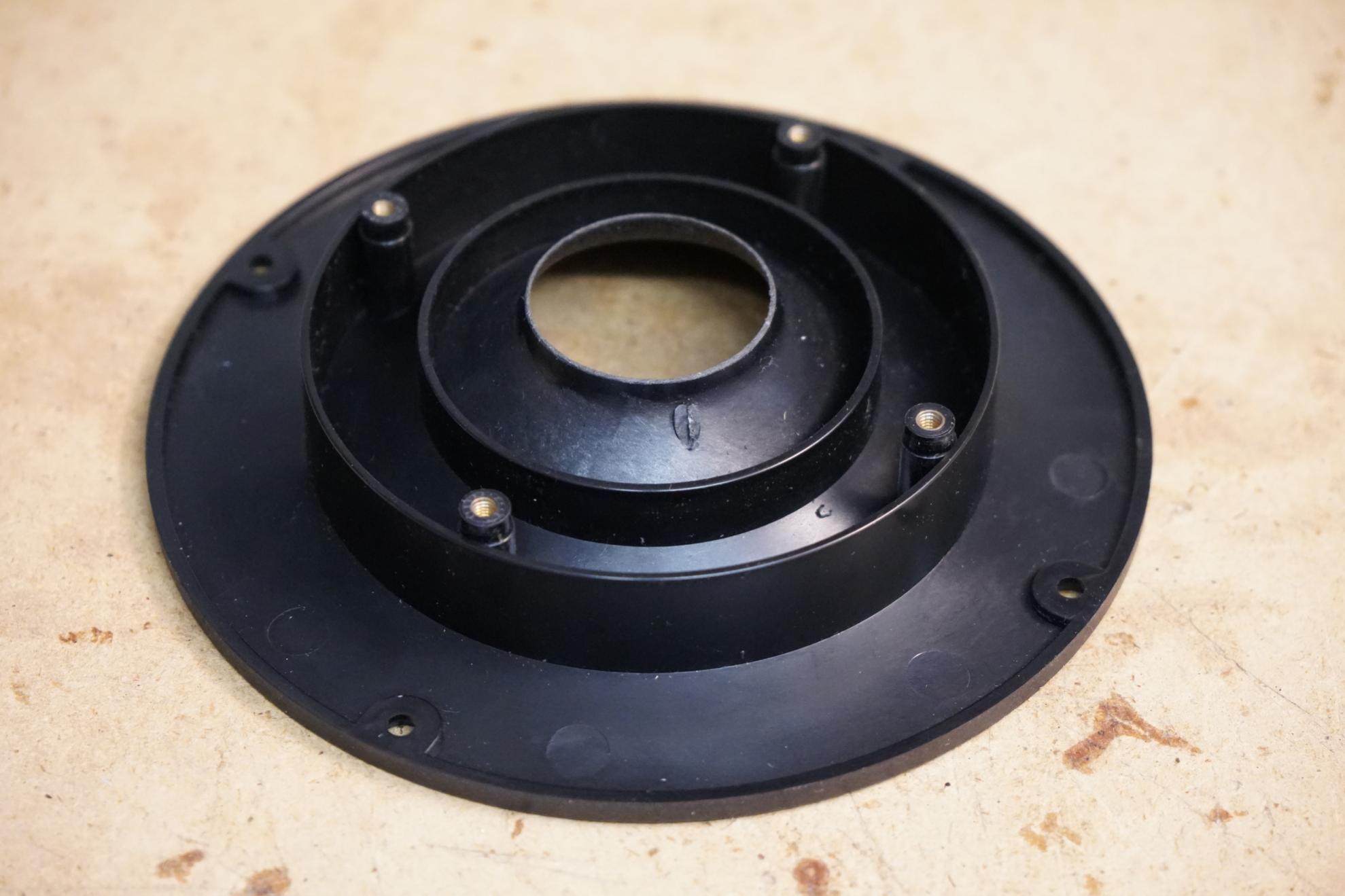

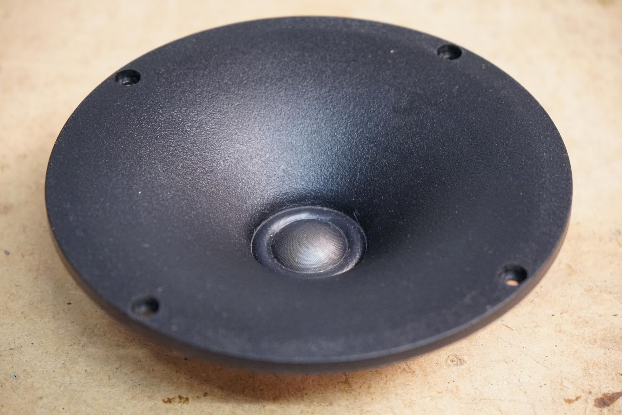

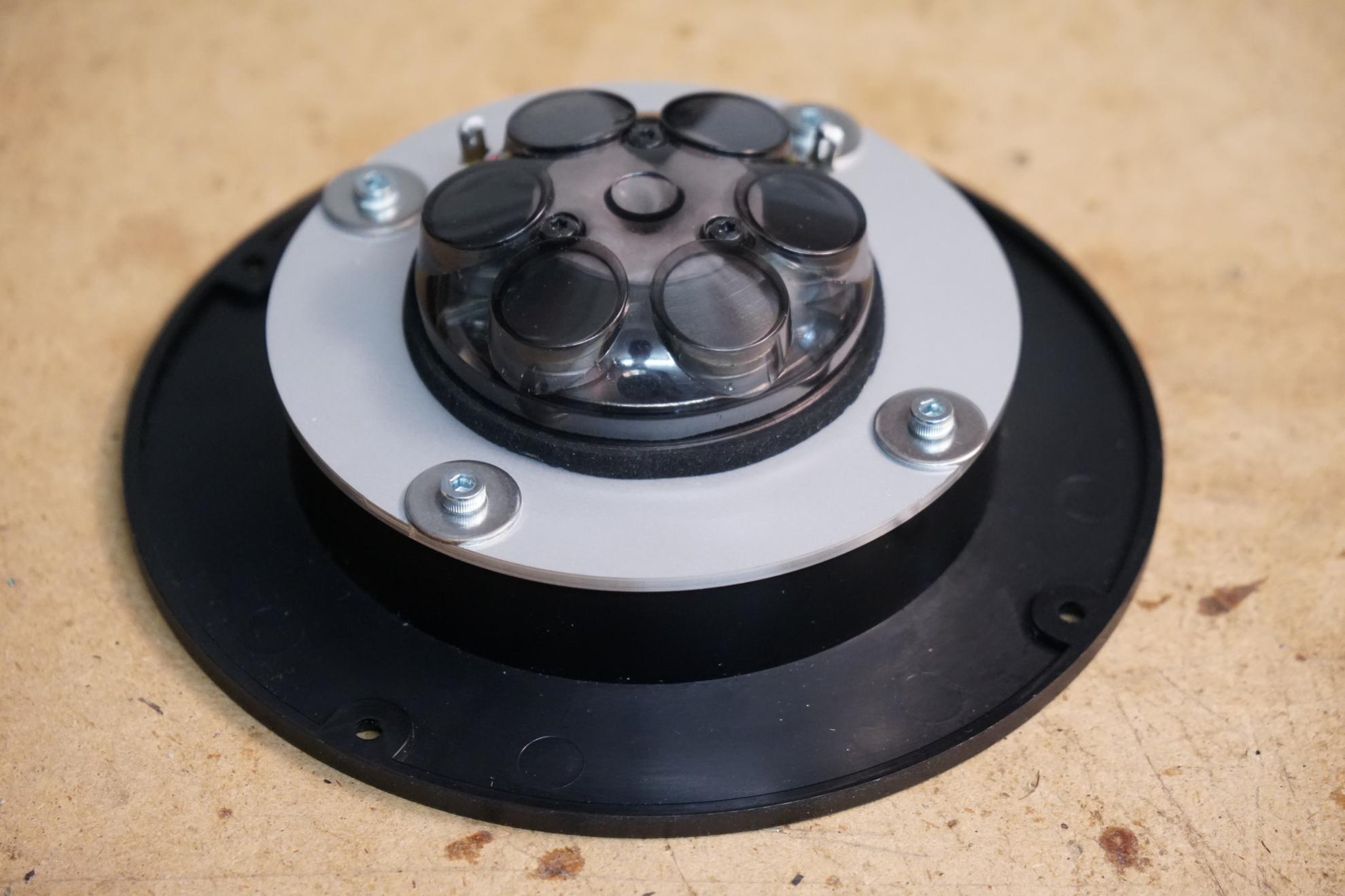

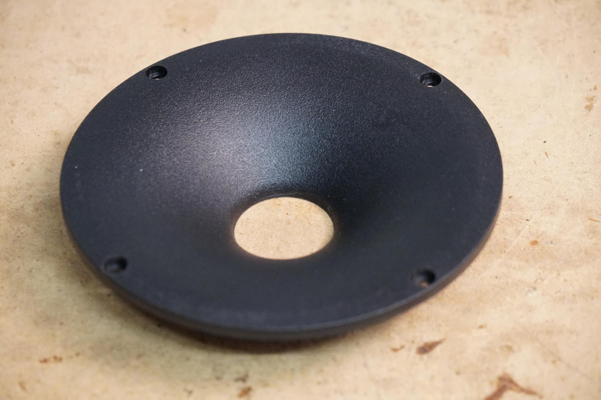

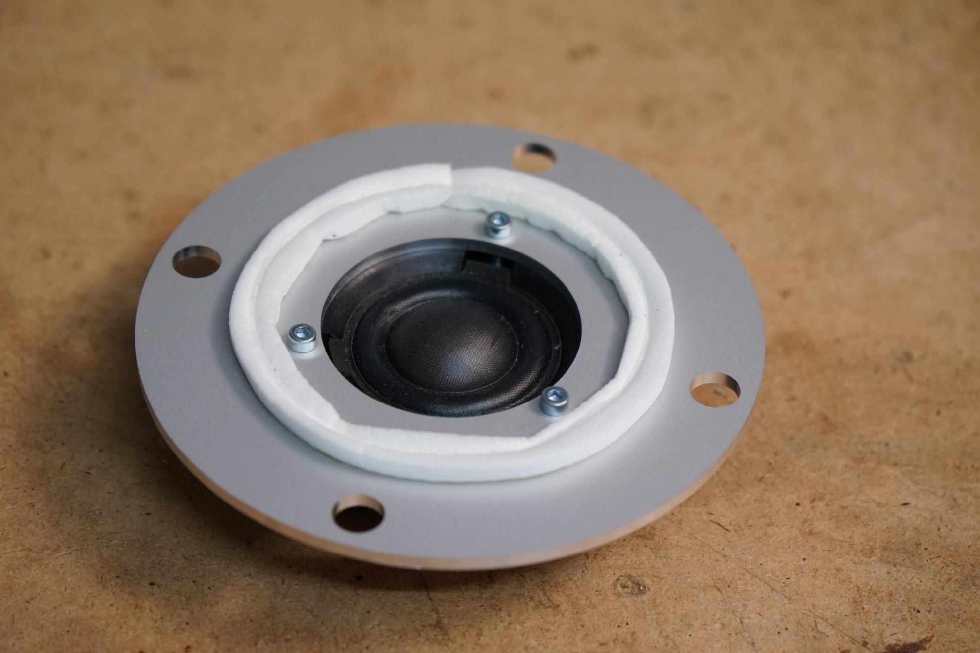

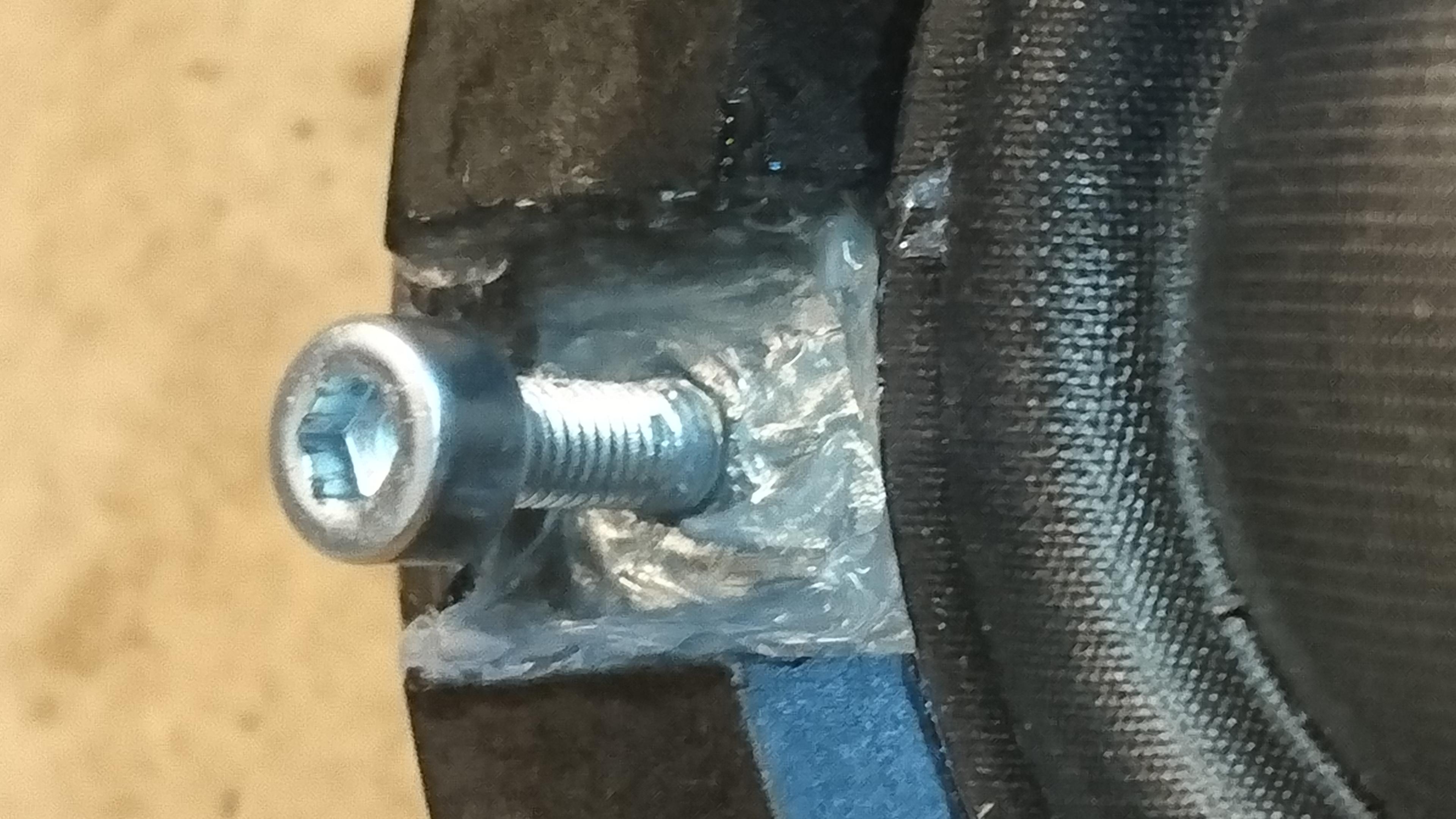

So I got my adapter plates ready and put the Monacor WG300 waveguides on my ScanSpeak 6600 tweeters. I machined the WG300 to make it a few millimeters shorter so I would fit the diameter of the 6600. See photos.

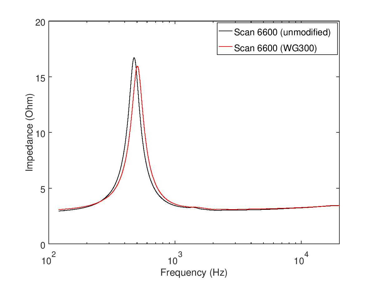

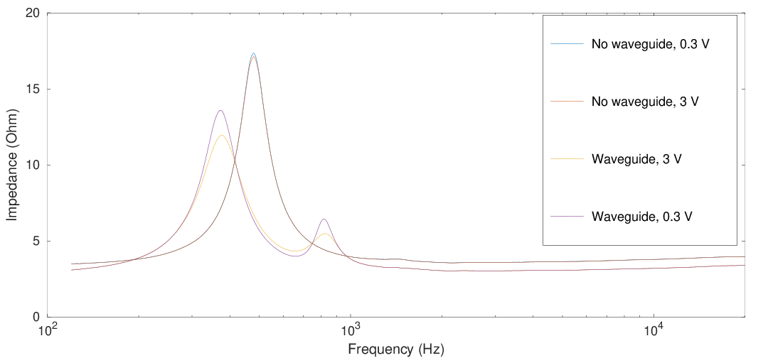

I have taken a few quick impedance measurements, which look a bit strange (no acoustic measurements yet). The curves show TWO impedance peaks (a bit like a bass-reflex system), and the size of these peaks changes a lot with different drive voltages (see attached impedance plots).
Any ideas what's going on?
Edit: note that the "no waveguide" measurements were taken from my second 6600 tweeter with the original ScanSpeak front plate installed.

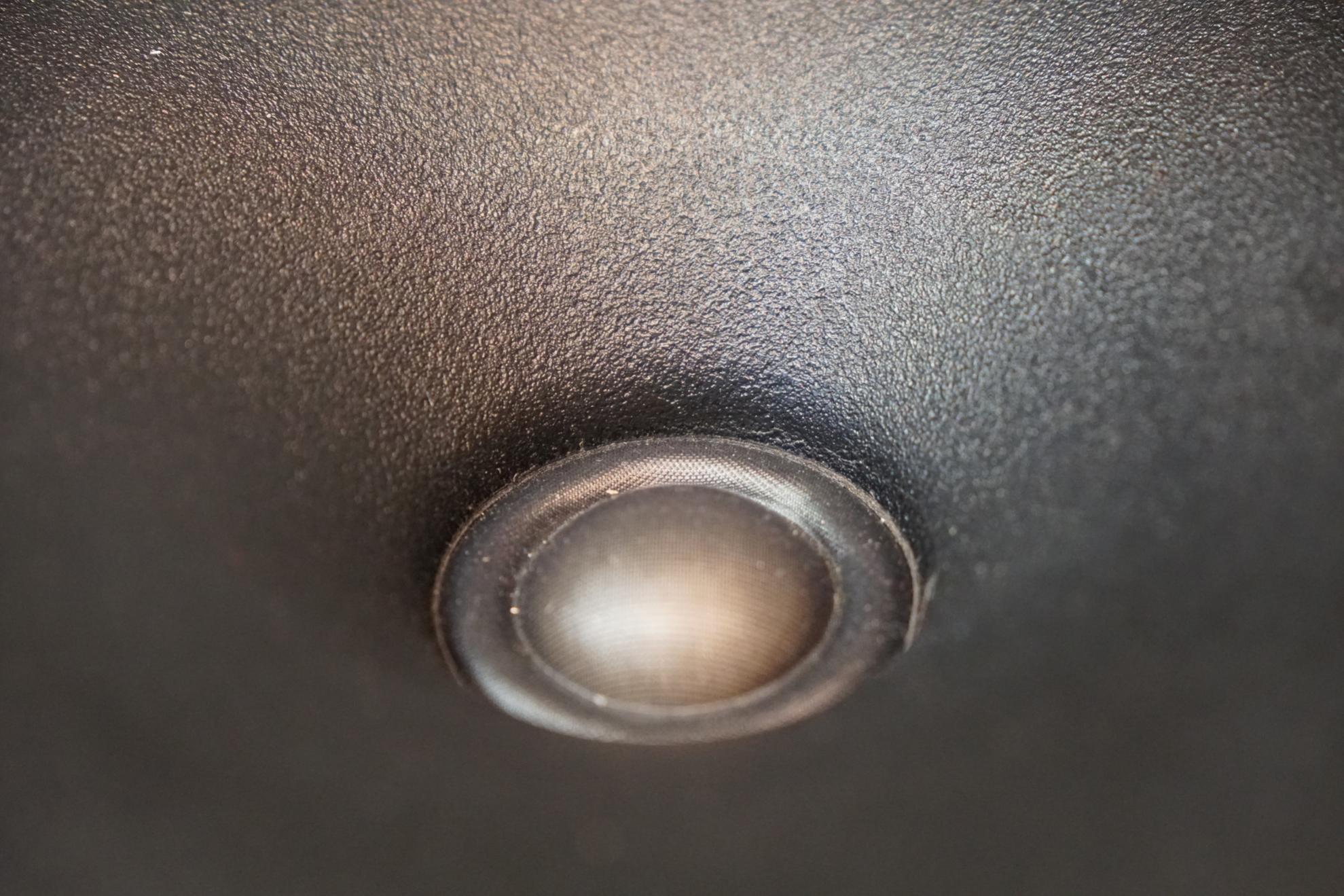

Problem solved. The original ScanSpeak front plate seals the three screw holes that are used to fix the plate to the tweeter, wheres the adapter plate does not. This causes air leaks from the rear chamber, resulting in the "bass reflex" behaviour. Sealing the screw holes with silicone fixed the problem.
ScanSpeak 6600 in Monacor WG-300

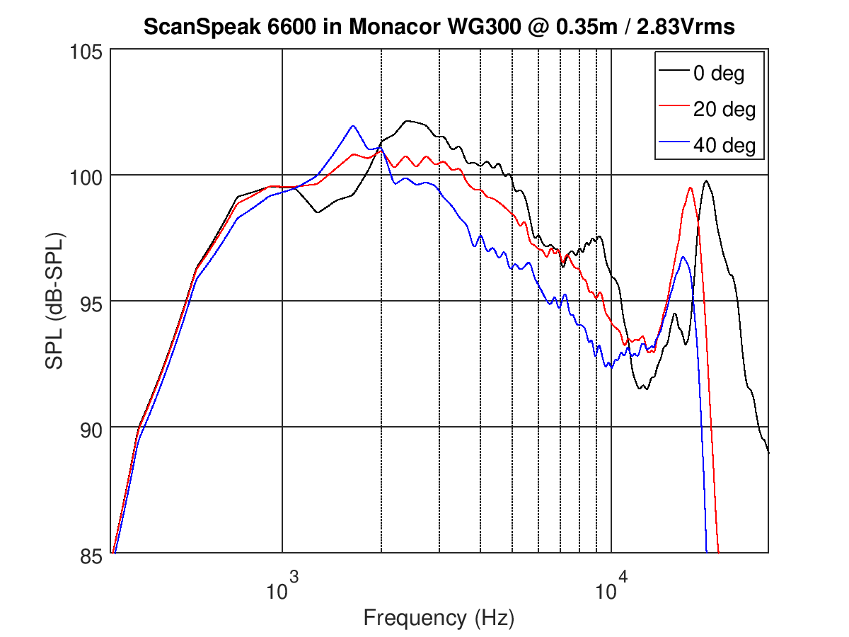

Here's a few acoustic measurements of the ScanSpeak 6600 in the WG-300 waveguide recorded at different angles. The baffle was 32cm wide, with the tweeter in the middle, 16cm from the top. The on-axis measurement shows a few wiggles, which I think are due to the baffle diffraction (note the poor tweeter position on the baffle). The off-axis response is pretty smooth up to about 15 kHz.
What are the peaks/dips at 15 kHz and above?
Why do they move to the left with increasing angle?

I've never had much luck using larger domes on waveguides. 16khz is 2cm long; because of this, if the 'tip' of a radiator is more than about 5-7mm closer than the rest of the radiator, you get a dip in the response.
The dip in the response that I describe, it happens because the tip of the diaphragm is 90-180 degrees out-of-phase with the rest.
There's two ways to fix this:
1) Use a smaller dome
or
2) Use a phase plug to flatten the wavefront that's radiated off of the dome

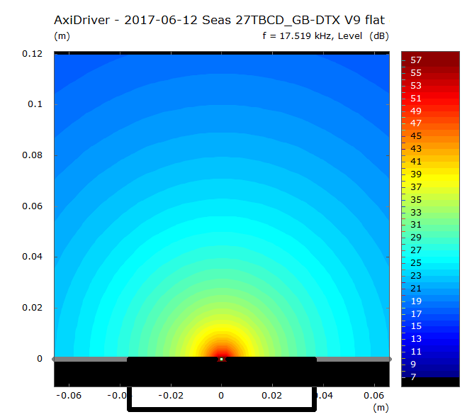

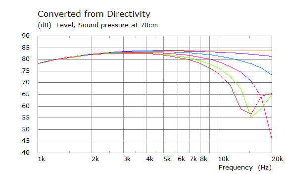

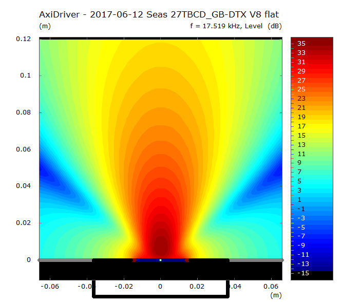

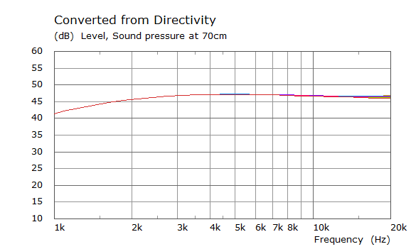

These dips are caused by the diameter of the tweeter membrane. Thy shift to lower frequencies with increasing angle because the distance from the closer edge of the membrane to the distant edge increases with increasing angle.
See these examples taken from the WG-Thread on the German forum.
A 1mm diameter membrane at 17.5kHz:
The respective off-axis response:
Same for a 28mm membrane (simple flat membrane here):
Off-axis response:
You see the typical dips shifting to lower frequencies with higher angles...
