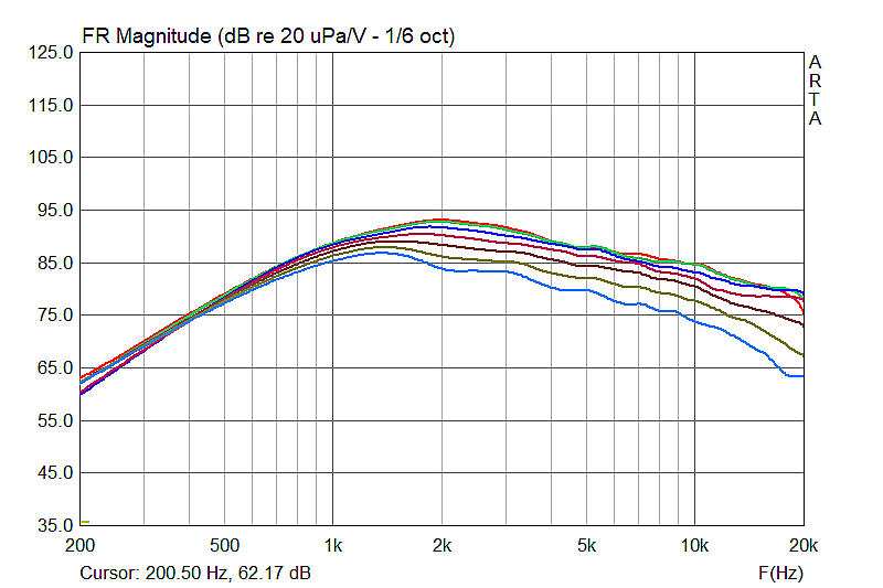

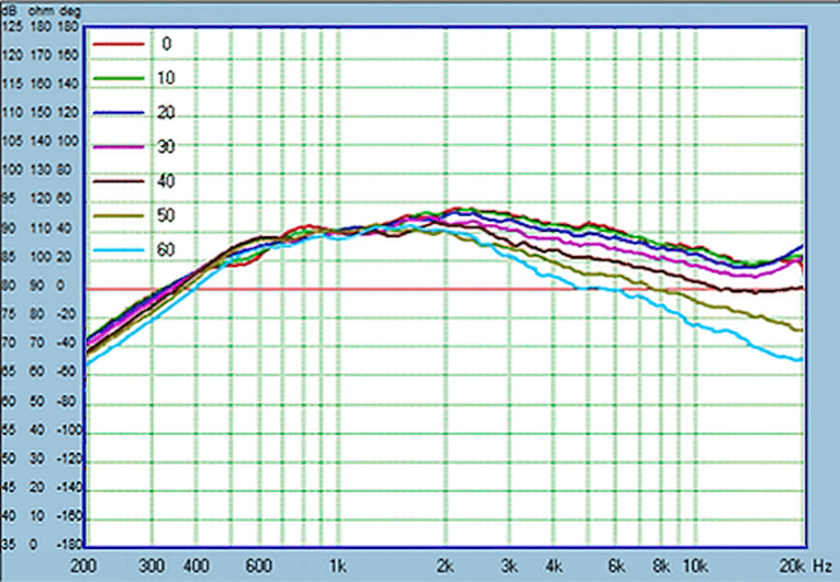

Add.: comparing the measurements in line chart form, the data from the Somasonus website doesn't quite match with what I've measured.
Comparison horizontal directivity for the 6,5" elliptical version w/ PS, SB26ADC-C000-4; scales, SPL and overylay colors matched; left Somasonus, right myself:
The Somasonus measurements show a broader beamwidth at the lower, and a narrower beamwidth at the top end of the frequency spectrum.
My measurements were done in free air, on stand / platform, 1m height, 1m distance DUT <-> mic, 2 ms gate, Class 1 FR mic with frequency & SPL calibration, graph 1/6 oct smoothed. Can you, @augerpro , name your measurement methodics, environment, variables, so we can diagnose the source of the differences?
