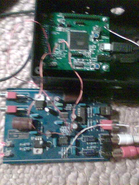

Open-source USB interface: Audio Widget
I am using a TDA1541A DAC in NOS mode (Non Over Samling)
It may not work in DACs relying on the i2s clocks for conversion instead of a master clock. i dont know 1541A enough to say whether it will work or not.
so my second question is - does this DSP make some kind of processing to the signal like oversampling or upsampling?
No processing。
my 3-rd and last question is - will I be able to use a custom made 11.2896 clock and slave the "transport" (the PC in this case) with it without using the XO's that are on-board? and if the answer is yes, which pin of the DSP accepts external clock input?
The.XOs are NOT on.the.usb-i2s module. They.are supplied by the analog board (ie the DAC.board).

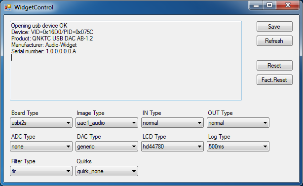

I've just updated to the 1.2 firmware on a 1.1 widget. Initially the WidgetControl.py complained because of vendorid and productid it didn't recognise but seemed fine when I added them.
It showed uac1_dg8saq when it first started and there is a green led showing on the widget. I could change the setting to uac2_dg8saq before pushing 'Start USB' but the led remains green.
I'm right in assuming it is still in uac1 mode?
Have you installed the new PC drivers as well? I don't know if the .py version of WidgetControl is 100% updated with new PIDs. On Windows the .exe version looks like the attachment.
Please make your settings align with what is shown in the screenshot. On Windows you should start it out as UAC1 and then change it to UAC2. On other OSes that shouldn't matter. A red front light means UAC2, green=UAC1.
Børge

TDA1543 works
I tested the audio-widget (sdr-widget) with a TDA1543 DAC and it works. Although this chip was run at 5V, the Atmel 3.3V logic levels were enough to drive it. The shift registers ignore the rest of the 32 bits after the first high-order 16 bits are loaded. Sound was pleasant NOS. There was some digital harshness, probably due to my poor wiring. The DAC would run up to 96 kHz but not 192 kHz. The bitrate at 192kHz 32 bit is 12.288MHz which exceeds the rated 9MHz of the TDA1543. A true 16 bit endpoint would halve the bitrate and then it might work at 192kHz.
Still, the builtin ESS9023 sounds better and smoother to me. Just want to encourage everyone to try these old chips with the great analog-widget.
Bob
