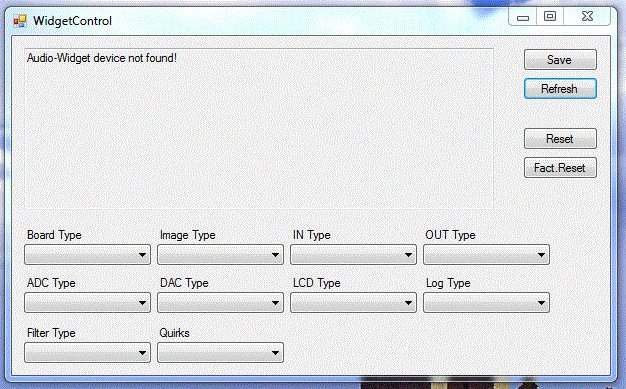

Hi Alex.
Apologies for the delay in getting around to trying this out.
Have gone through the latest readme file, and followed it to the letter. Firmware flashed OK with no error messages. Uninstalled the original AWSetup drivers. Installed the AWlatestexperimental software instead.
In UAC1 mode, Window7 seems fine. However when switching to UAC2 (manually, on the rear of the DAC unit) the Widget Control now says 'device not found!'. When I switch back to UAC1 manually, all the information is in there and displayed correctly again. Obviously I have done something wrong somewhere, but I do not know what and it's driving me nuts. Again.

The new Widget Control will work in both uac1 and uac2 modes. However, you need to remove the old libusb drivers.
The old widget control uses libusb drivers. The new experimental widget control uses libusbk drivers. You must be having your libusb drivers still installed, thus the libusbk driver cannot connect to the widget in uac2 mode (as the widget has already been captured by the libusb driver).
To completely remove old drivers:
Uninstall Hidden Devices, Drivers, and Services | a Tech-Recipes Tutorial
You need to remove all libusb drivers related to the widget.
This is (one of the) problems with Windows 🙂

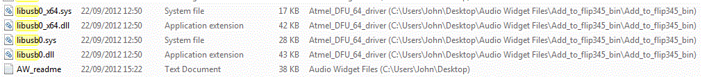

Alex, have just seen this stage mentioned in the 'add_to_flip345_bin' folder:
"3 - Download a signed driver Atmel DFU driver from: AVR Freaks Atmel_DFU_64_driver"
This stage isn't mentioned anywhere in the main readme file, and I haven't done it. Could this be the reason? Also I am using Atmel flip 3.4.7...
DAC is working fine with UAC1 and 2, but with a blank Widget Control screen when in UAC2 mode.
- John
P.S. I'm using the 'win7' version of 'add_to_flip345_bin' dated Dec2011, and not the slightly more modern 'windows' version posted a little later dated Jan2012.
Should I be using the generic 'windows' version, even though I am using Windows7?

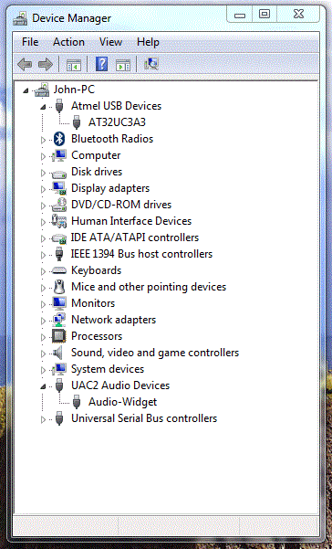

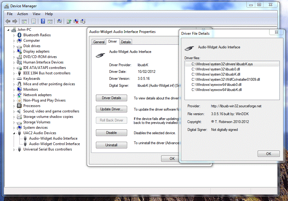

This is what mine shows. Note that under libusbK USB devices there is one audio interface and two control interfaces (one for uac1 and one for uac2).
If you still cannot get WidgetControl to work under both uac1 and uac2, may be you need to set up a Teamviewer session with Borge or myself to help you to set it up correctly.
Note also in my Device Manager display there are "greyed" entries. These entries show the "hidden" device drivers - ie the drivers are installed and ready but the actual devices are not plugged in. So you can see that as my audio-widget is now in uac2 mode, the libusbK audio control device for uac1 mode is greyed. The sound device DG8SAQ-I2C is also greyed (this is the device when the audio-widget in uac1 mode).

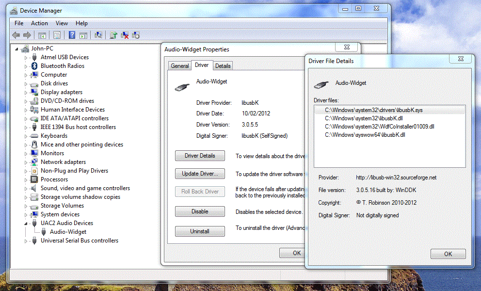

Cheers Alex. Didn't bother with any ATMEL stuff this time around (as firmware is already flashed to the latest version from a few days back).
The only thing I installed was AWsetupexperimental. So any drivers installed are via that - I didn't download any USB drivers (I didn't last time for that matter). All working now I am pleased to say! All details appearing in Widget Control in UAC1 or UAC2 modes. Great!
If you look at my screen-grab, you can see it displays libusb0 as well as usbk. As I said above, I didn't install any usb drivers - left it all to AWsetupexperimental, so I assume this is all now correct.
It still doesn't look like your screen - I haven't a clue why. But it's working 🙂
Thanks for your help!
- John
