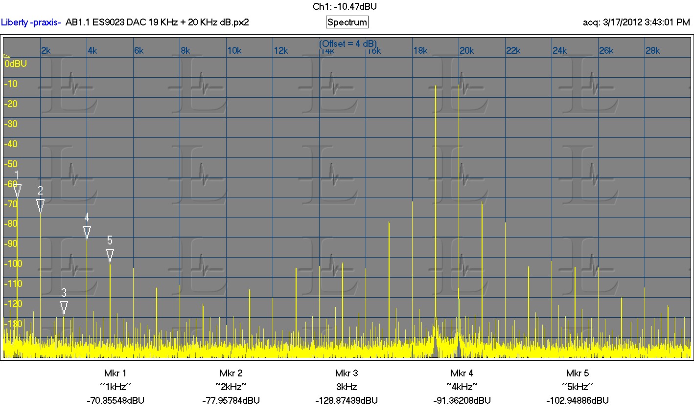

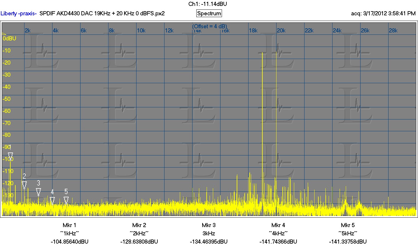

Would I have suggested it without listening? Remember this is not the last word in DAC's and you can still invest hours into making the DAC chip of your dreams work. Of course I have listened to the eval board. I have also measured it. I can't say its on par with a $50 ESS9018 but its very good. I found it preferable to a Proton in my listening, and this is via SPDIF and a $3 wall wart unregulated primary supply to run the eval board.
I have also measured it at length as well as the AB1.1. There is too much data to wade through here so I will highlight it.
The AK4430 has 2nd harmonc distortion but very little above the second. At -6 dBFS the 2nd is -90 and everything else is -110. The ESS9023 same conditions in the AB1.1 is -60 for the 2nd with 3,4,5 etc. at -65 to -67.
But these two pictures should show the real strength of the AK4430:

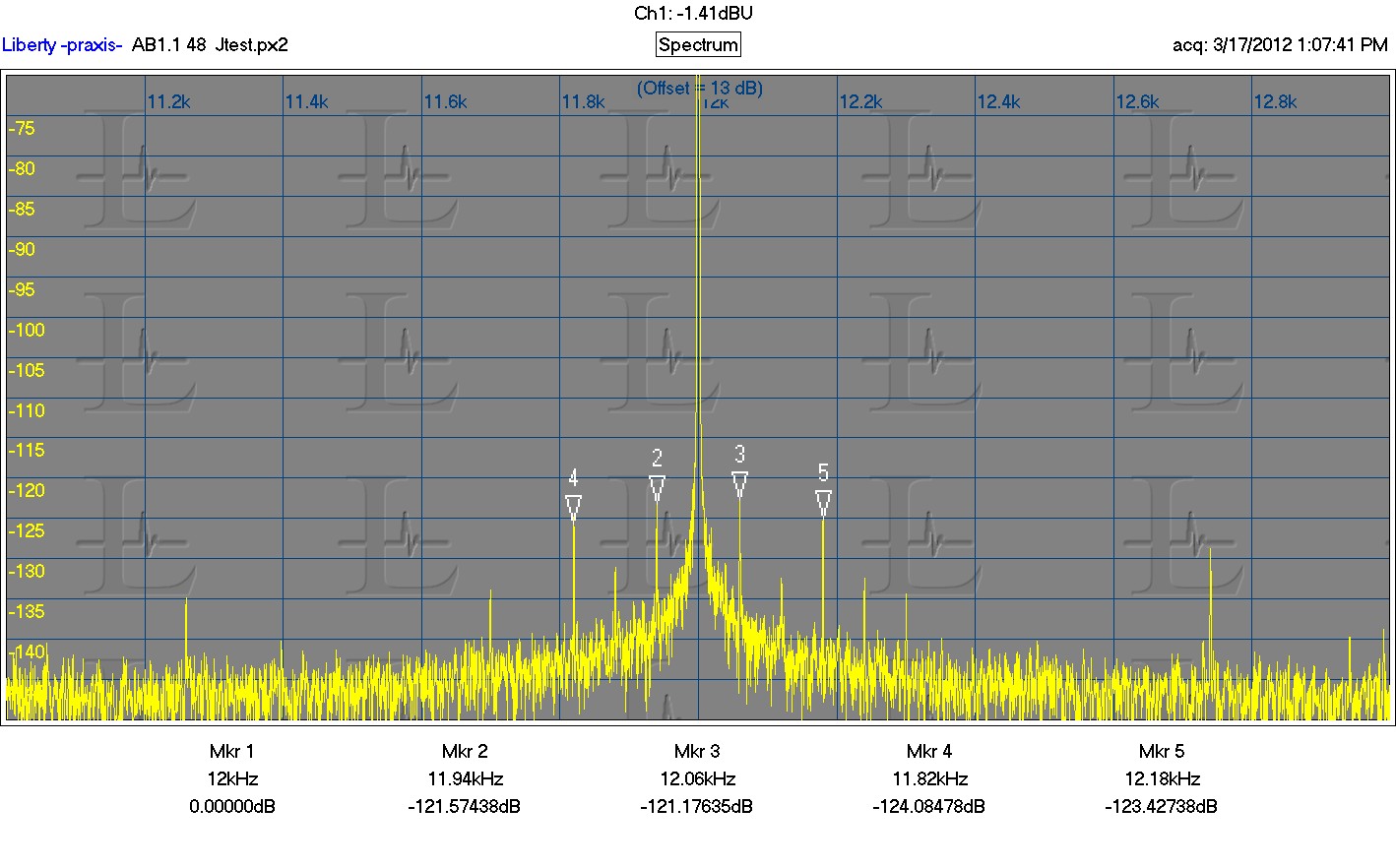

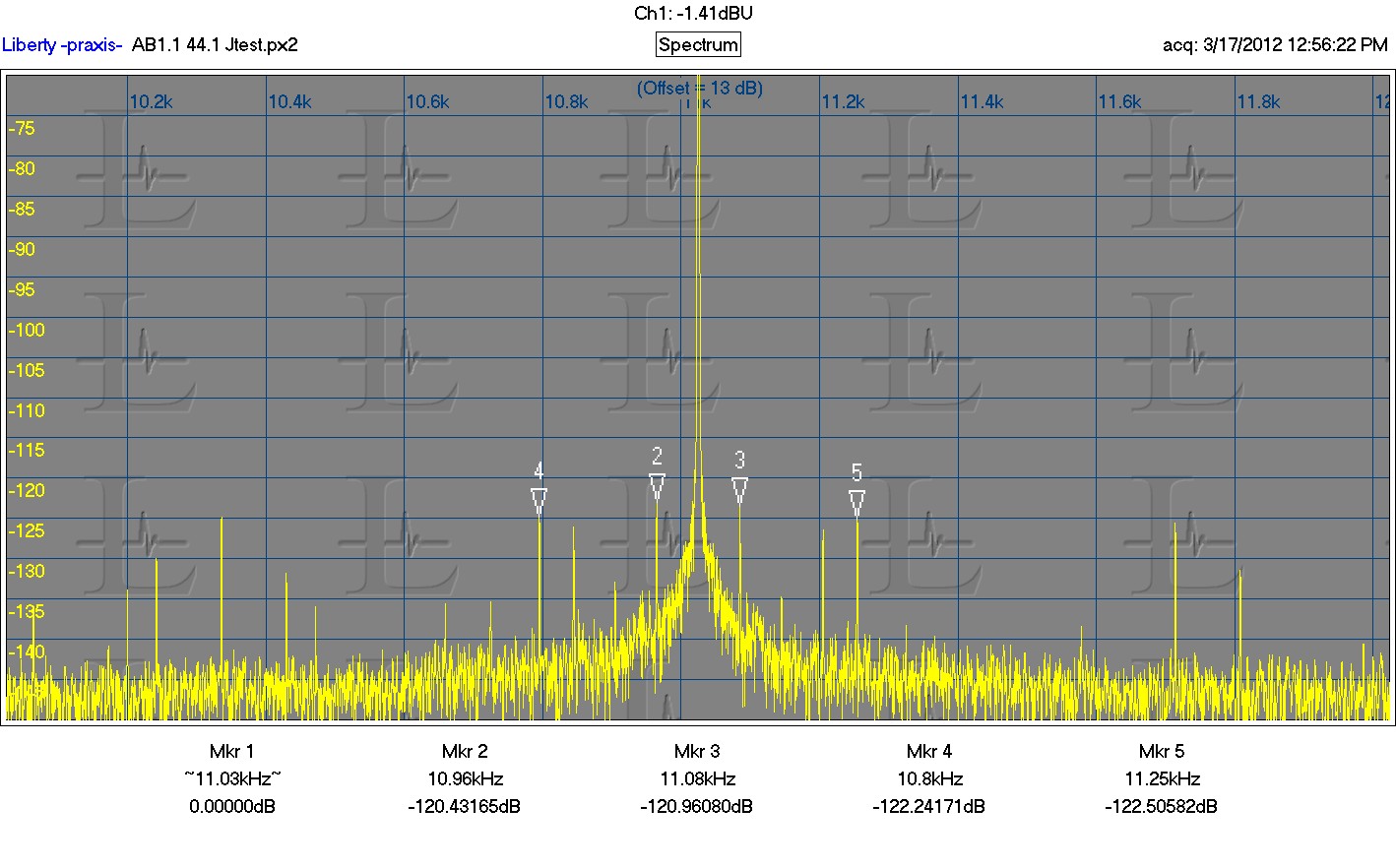

I may have spoke too soon. I have upgraded my test capability with the addition of an AKD5394 eval board. Adding a high performance external oscillator I now have a really low noise floor (-160 dB+) and good extra low distortion capture. I remeasured the AB1.1 with a 44.1KHz and a 48KHz JTest. The 44.1 has a few more spurs but the peaks are pretty similar. These plots are formatted as close as I can to the Stereophile format. Figure that -120 dB is approx 20 pS (I think).
