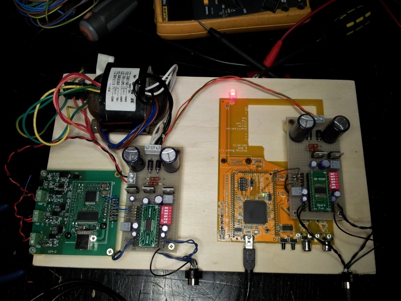

AB-1.12 Easer Egg
Hi guys,
inspired by Demian I have made two last-minute changes to the AB-1.12.
The first is to add synchronous binary counters to divide down MCLK from the XOs. Divisions from /2 to /256 are now available on SOIC packages. More relevant divisions are available on 100mil headers. These may find a role in synchronous power supplies, alternative XOs etc.
The other addition is the most significant one 🙂 I decided to put in a whole 'nother prototype board, the AB-1.13. It is identical to the AB-1.12 except for the primary audio DAC being AKM's AK4430. Demian likes the sound of it. And I'm pretty happy with the way the layout turned out. This DAC has a charge pump like the PCM5102 and ES9023. But the pinout lends itself beautifully to star-gnd / star-power.
AB-1.12 and AB-1.13 will be sold as two naked boards in one bundle. One front plate and one back plate will also be part of it.
As it stands right now, the $50-60 price I guessed at first seems to stand. That price includes shipping and ONE of each of XOs at 22.5792 and 24.576MHz. It is easy to throw in TWO of each XOs, but that will jack up the price a little bit.

excellent! actually thats quite interesting and i might even populate it before the ESS =) i have 3 ESS dacs already and you have just given me a reason to feel justified in my purchase =P thanks! my audio affliction monster (but possibly not my bank account) thanks you
Isolation is nice but doing it well is not easy.
Passing I2C across a barrier may be harder since its bidirectional. The I2S is pretty straightforward, but the clocks should be on the isolated side so you need a tag line to communicate which clock to pass across the barrier (another opto). Transformer isolation of the clock and optos for everything else would be pretty simple. You do need the supply on the far side. You may need some software smarts in the widget to prevent lockup if the isolated side power is missing, meaning no master clock. I would use a latch in the isolated side for the data lines clock from the master clock to ensure they all will meet the appropriate setup times. If the DAC were on a separate pcb (better for isolation from the USB connected junk) I'm not sure where the isolation circuit should reside. Instinctively I would put it on the DAC board actually. That would keep the timing sensitive lines shortest.
http://www.silabs.com/Support%20Documents/TechnicalDocs/Si840x.pdf is a one chip I2C isolator that may work. If so this whole thing could be pretty easy. I'll look at the other silabs isolatiors as an alternative to optos. The clock will need transformers. Should the divider live on the isolated side (nothing on that side actually needs it) or on the USB side? We can use a fast divider so the clock could be up to the 98.304 MHz needed for the ESS stuff. Transformers are easy.
Clearly this is not for a mobile application. I could use it to convert some of the DAC stuff I have to USB.
Would this cover all the requirements?
