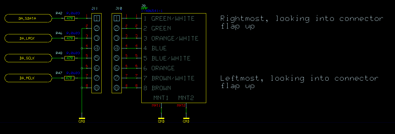

Here is my suggested pinout for I2S over CAT5. One thought has struck me: Anyone who is capable of patching this on the PCB is also capable of making a custom CAT5 cable.
So what I will do is fix the CAT5 pinout on the AB-1.12 and leave people to build their own custom cables. That means out goes the "patch panel" of this schematic.

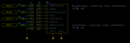

Why not use the EIA/TIA pairing for the CAT5 connection? I know its screwy but it is reall common. You can get 10G ethernet through it so it must work OK. If we could use the magnetics we would have isolation as well. I don't know if we can get word clock and data over the magnetic interfaces but it would be a worthwhile experiment.
