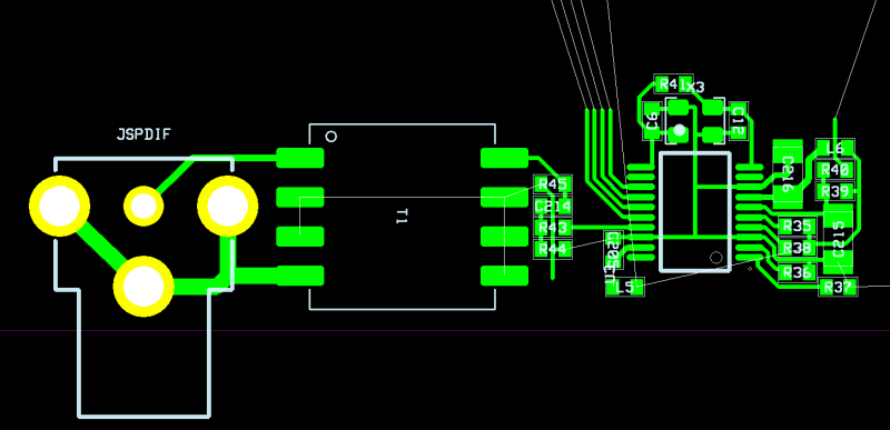

Hi guys,
here is an updated AB-1.12 schematic. As you see, WM8804 is now in. Any comments on the HW setup? I've added an optional reset by MCU. The output is trafo coupled. The WM sees a DC load while the AC coupling cap does not see a purely inductive load.
For CAT5 output I plan to use something like:
- Digi-Key - CAT5 con
- 74125 permanently enabled, NO D-flip-flop clocked by MCLK, 3.3V
- Header to patch from driver to connector
For the power I have changed the transistors to SOT223 packages MMBT4403 and MMBT3904. Available at DigiKey and capable of burning a bit more power.

You can use the 3 pin version of the TL431 to save some more real estate. The SPDIF transmitter looks good. Linuxworks and I verified that it works for all sample rates.
