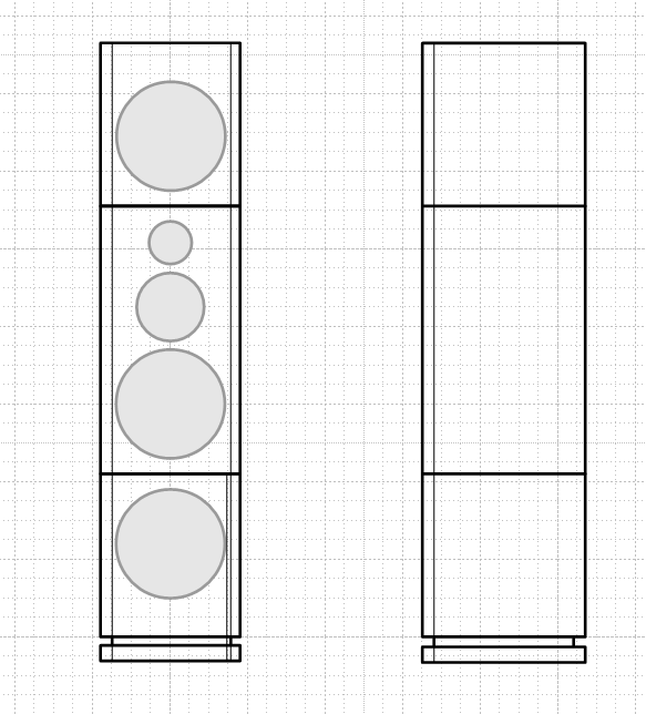

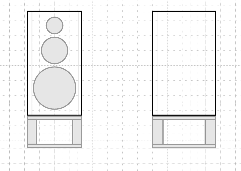

There is also the option the make the speaker 4-way (or call it a 3-way with sub) by adding 2 woofer cabinets. The picture below makes it clear.
classic 3-way front and side view
classic 4-way front and side view
The project was started as a 3-way, but after the demand to add a subwoofer to the system, the 4-way option has been created.
So the 4-way consists of 3 cabinets, to make it all not too heavy as a total.
The size of the 3-way with foot: W x H x D = 36 x 90 x 42 cm.
The size of the 4-way with foot: W x H x D = 36 x 159 x 42 cm.
Just as an info, the drivers, and crossover chosen for my project are:
woofers: 2 x Eton 11-212 parallel
midwoofer: 1 x Eton 11-212
midrange: 1 x Accuton C173-6-096E
tweeter: Seas Be E0058-06
Crossover design wiil be done digital using miniDSP.
4 filter types will be designed: LR4, B3 and elliptical 5th and 3rd order.
Drivers for the 3-way and the miniDSP are already at home.
I will built as first the 4-way on short term.
I am prepared to fully support a DIY forum version, with cabinet dimensions, driver types, crossover implementation to be chosen.
I voted for the 3-way classic low budget, because there might be the more interest for it than a high end version.
The speaker I currently design can be equipped also with low budget drivers.
