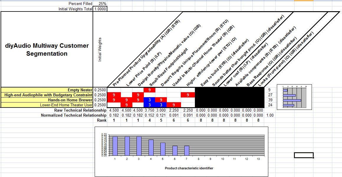

Perhaps something that creates a visual of the "customer demand space"...
You see some customer needs blacked out in the customer demand matrix at top, and that's because everyone wants those product characteristics, so there really isn't much to gain in terms of arguing over those areas--"just do it" but "keep the overall product and development costs as low as possible in those areas" since those are in the realm of customers saying "this is something that I shouldn't have to tell you".
I think that there could easily be more than one solution based on the customer segments shown (and more customer segments might be yet to be identified with their own unique needs). Note that the four axes (lower cost, easy to buy, easy to use, and greater benefits) usually are the most significant indicators of ultimate product success--the bigger the polar plot shaded area, the higher the probability of product success as measured in sales or units produced/consumed.
I'd recommend looking at the possibility of serving only a couple of customer segments with a really good product (your choice of which customer segments you're going to serve and which ones that you're not going to), and let another product configuration that would serve other customer segments. I'd recommend breaking those two/three designs into separate threads.
Maybe a poll of these 7 characteristics would be timely to help define what the readership is most interested in.
It would be better if we could rank each characteristic rather than choosing only one, but any statistic would be better than assumptions.

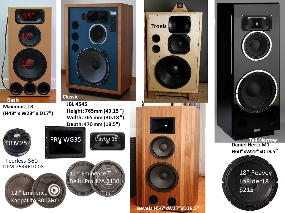

A low cost BIG Classic studio monitor
Classic studio monitors are BIG.
18" woofer + (10" -12") midwoofer + 1' CD_horn.
Troels Gavensen now loves BIG. @ $2500 in drivers
Carefull selection can find 3 good quality drivers for ~$400.
Passive and DSP crossover options.
To aid cabinet construction, a CNC file and a table saw cutsheet would be available.
