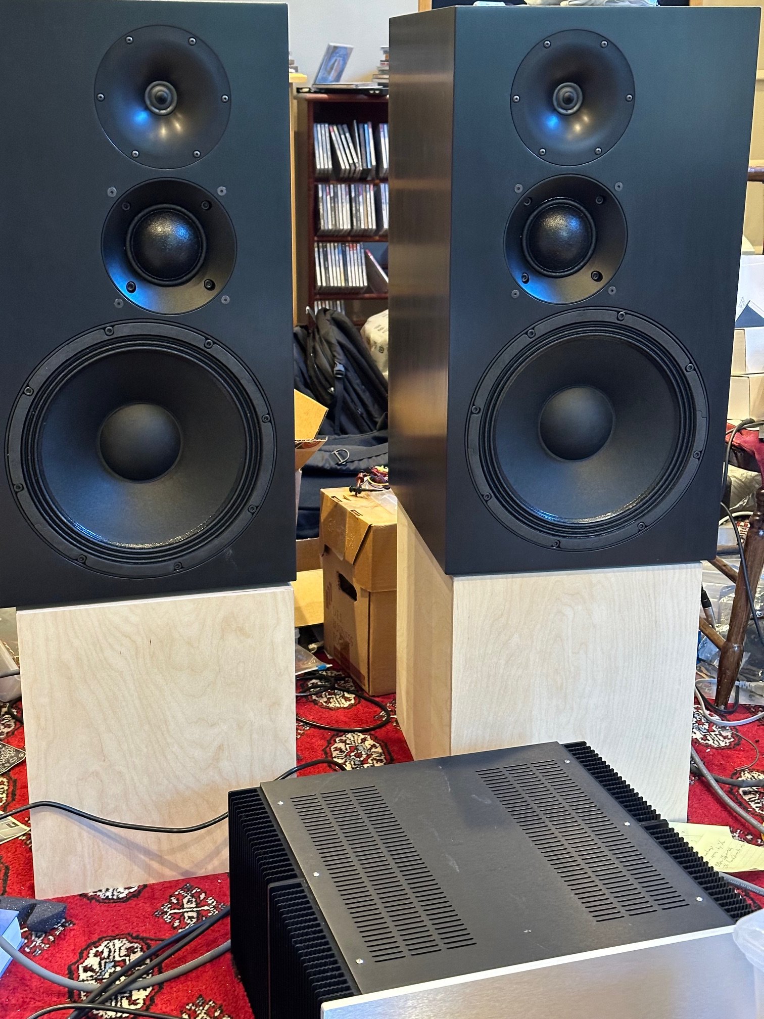

Dampening - I was originally going to use some fiberglass sound panels. It was too friable and I changed direction.
I found some egg-crate foam with similar NRC ratings (below 500Hz) as the Basotect. I followed Matthias' guidelines and only covered half of the rear with dampening material.
I then covered the whole back inside and added some AngelHair in the bottom behind the woofer. Stopped the slight boominess that I heard. I did use the AngelHair in the top instead of the wool because I already had it. (100g per speaker at this point.)
The amp - clone of the Aleph J.
