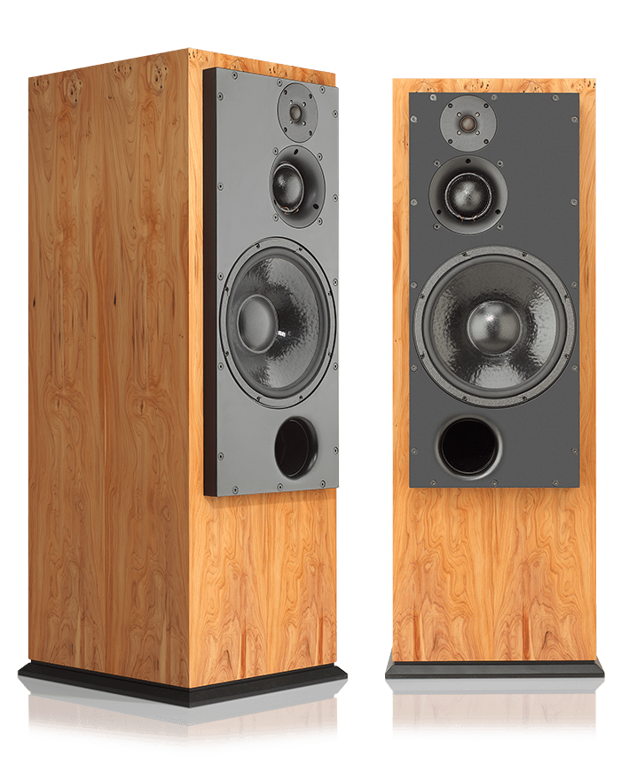

I can see the appeal in easy access. For a tower version, a plexiglass covered crossover compartment, accessibly from the back, could be possible - a little component jewelry and easy access. I would love to go for the ATC look, but my wood working skills may not extend that far. From a brief exchange with Matthias it seems a front port is feasible but I don't know if that type of front baffle would mess with the dispersion?
I think the slight step in such a front panel wouldn't do very much to the acoustics.
I'd guesstimate the size of the step to about 4 cm, and they will be irrelevant for frequencies with wavelengths larger than this (frequencies well below 8.5 kHz). In other words, anything coming from the woofer and the midrange will not be affected much by the steps. For higher frequencies, most of the sound is kept away from the edges/steps by the wave guide of the tweeter (and the same could be said for the upper midrange).

It would change it slightly. The ATC in the picture have a stepped baffle which is not a desirable feature in general. The stepped baffle is there to have a place for the chamfered dustgrille, that can reduce baffle edge diffraction.I don't know if that type of front baffle would mess with the dispersion?

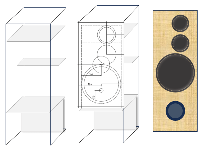

Hi, again –
As mentioned above, I have been thinking about a tower version of the OSMC. To fit into our living space, and not be larger than the current speakers, 100cm would be a good height. Keeping the width and depth of the OSMC, I sketched the following and wonder if I am missing anything or making silly mistakes? Assuming 18 mm nominal thickness for the 3/4" Baltic birch available here in the US, the volume would be about 106l.
The two upper braces would be identical to the OSMC ones, and a third brace (or more) could be placed below the woofer. This brace could also be the top or bottom of a small crossover compartment. Any issues with the third brace or crossover compartment?
I would love to make this front ported to not have the speakers too far into our living room. Port placement/height could be centered between the woofer and the bottom, or closer to the woofer. Any insights on port placement on the front? Port dimensions is another question.
Unless I can find Baltic birch thicker than ¾” (18mm nominal), I would likely put a layer of MDF on the back of the front/baffle to accommodate the min depth of 20 mm for the Volt752. Would it be beneficial to add an MDF ‘lining’ this to the rest of the cabinet if using 18mm Baltic birch? This would further reduce the volume and add some heft to the cabinet.
Any insights and suggestions will be greatly appreciated!

Yeah, if at all possible make a "prototype" version to test out your build "issues" you have in mind, like the mdf double front you are wondering. It is a chance to test your building ideas/methods but also about how the enclosure works acoustically.
As the enclosure has long internal dimension it's highly likely the port outputs some unwanted midrange sound, either schuffing sounds or it could resonate, or leak some sound from inside. It would be advantageous to you to be able to play with the port size and also position (inside the box) in order to check there is not severe issues with it. If you do not do this, it's left for luck and you might get it nice, or not. Worst case unwanted mids are louder than the Helmholtz resonance itself, which pegs question why use a port at all.
Another thing you can test with prototype is that how much the box gives coloration in general, whether your bracing / damping / stuffing scheme is fine enough. Area of panels is much greater than area of the woofer, and any vibration of the panels could be quite loud so this might be another critical thing to be able to tune.
Prototype is quite much extra work and money, but you'll learn a ton and it is pretty much quaranteed a prototype gives you better end result by many counts. You might be able to "fix" at least one thing from construction side for better looks as well and you already have that much better end result even if the audio was fine, but you could have spotted multiple things that result in so much more better end result. And learnt thing or two. Of course everything relates to how interesting this stuff is to you, most important thing is to be motivated the whole way through to get some end result so do what feels relevant to you Have fun!

Hi Guys,
Thanks for the input!
@tmuikku your suggestions make good sense but seem a little daunting for a first time speaker builder I can imagine a few approaches that would enable me to tweak the cabinet along the way, even if not fully reversible. MDF is inexpensive in the context of this build - are there downsides to making the cabinet from two layer/sandwich walls, other than weight?
If a volume of about 100l is too large, I suppose it may be possible to close off the upper part of the cabinet, or part of it, above the woofer? One could also make the crossover compartment in a 'bottom' compartment. Both would shorten the effective cabinet space if this is desirable.
If I think too much about it, I will end up building the OSMC as designed ...

I wouldn't bee too worried about midrange leakage. The x-over filter cutoff for the woofer is about 300 Hz, and the taller box will not introduce any new resonances above this frequency.As the enclosure has long internal dimension it's highly likely the port outputs some unwanted midrange sound, either schuffing sounds or it could resonate, or leak some sound from inside. It would be advantageous to you to be able to play with the port size and also position (inside the box) in order to check there is not severe issues with it. If you do not do this, it's left for luck and you might get it nice, or not. Worst case unwanted mids are louder than the Helmholtz resonance itself, which pegs question why use a port at all.
Hi, yeah, I've had problems with my ports but it doesn't mean everyone would, just that I'd want to prototype or plan for tweakable port if not sure it's not a problem. Same with "box sound".
Example simple estimations if someone is interested. If 100cm was the longest internal dimension, first three modes would be ~171Hz, ~343Hz, ~514Hz. These could all be audible worst case. Third one is likely already attenuated by damping material inside the box, the lowest one is perhaps non-existent due to the woofer being midway of the long dimension, the second one is fully excited woofer being at a pressure node, luckily the port is roughly at velocity node of that one. Worst place for port inlet would be at the end of the long dimension as it's all pressure node there ready to leak. Perhaps the current location is just fine, perhaps it would be better bit closer to the driver further from the end of the cab. It's possible that there is a leak or not, move 5cm one direction and situation reverses, can be quite fiddly. Could be tweaked with damping material and so on, so perhaps not necessary to make extra prototype box. I'd still opt in some tweakability and measure before finishing, and so on
