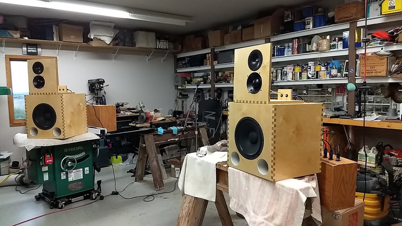

Latex—Benjamin Moore Regal Select eggshell. Might be a bit surprising, but it's how you lay it down... I did 3 coats of any latex primer—sanding between each coat. Every coat was thinned at least 50% with water...except for the final 3 coats of satin clear water-based poly—Varathane Ultimate, which is an excellent product—no thinning—steel wool or scotchbrite between each layer. All in it was about 12 coats. The final coat I tweaked with quad odd steel wool. There will certainly be a difference in thinning interior latex 50% depending on brand. I know that paint really really well—and you can work it on a vertical quite thinned without runs—but you have to have really good lighting—and watch it closely—and less is more—but it won't pull too quickly when thinned—if you get me—multiple passes are possible to catch any runs before set. I also don't like my wood corners freakishly sharp—slightly eased—may up to 1/16", helps with paint too.
Suffice it to say—there was entirely too much drama potential regarding "color" in this "designer" heavy house and I just decided to experiment with interior latex brushed on since there were at least 15-20 paint swatches on our walls at one point trying to determine which "white" was "the white" for the house....and I made the speaks the same color as the walls to avoid any conflicts .
Honestly the finish is freakishly good. I'm not saying that's my skills, though my brushes are broken in. I'm saying that the paint has visual depth when applied like this—I don't think I would have or should have sprayed it—now, if high gloss is your thing... well.. spraying is the way.... White is pretty forgiving too. My brush skills, which are mature, would have been seriously more taxed with a dark color. There are strokes upon close inspection—but they are more like purposeful texture than "bad skills on display". We baby them—but it's not like they haven't been knocked occasionally—finish seems quite durable. Oil would have been smoother for sure applied like this—but would have yellowed over time—and been considerably more toxic during application.

We want all to know: how good are finally the front ports?
haha, well they are awesome! But the box is totally redesigned from the actual OSMC project, as is some of the crossover to accommodate the changes. But with a bigger bass box and a few design changes, the low end is extended a few HZ and sounds really great.
These will eventually be soffit mounted, so it was imperative that the ports be on the front. The final install will also change the baffle since it will be flush mounted, so we may go to DSP crossovers and multi-amp at that point. Or tweak the crossover some more, not sure just yet.

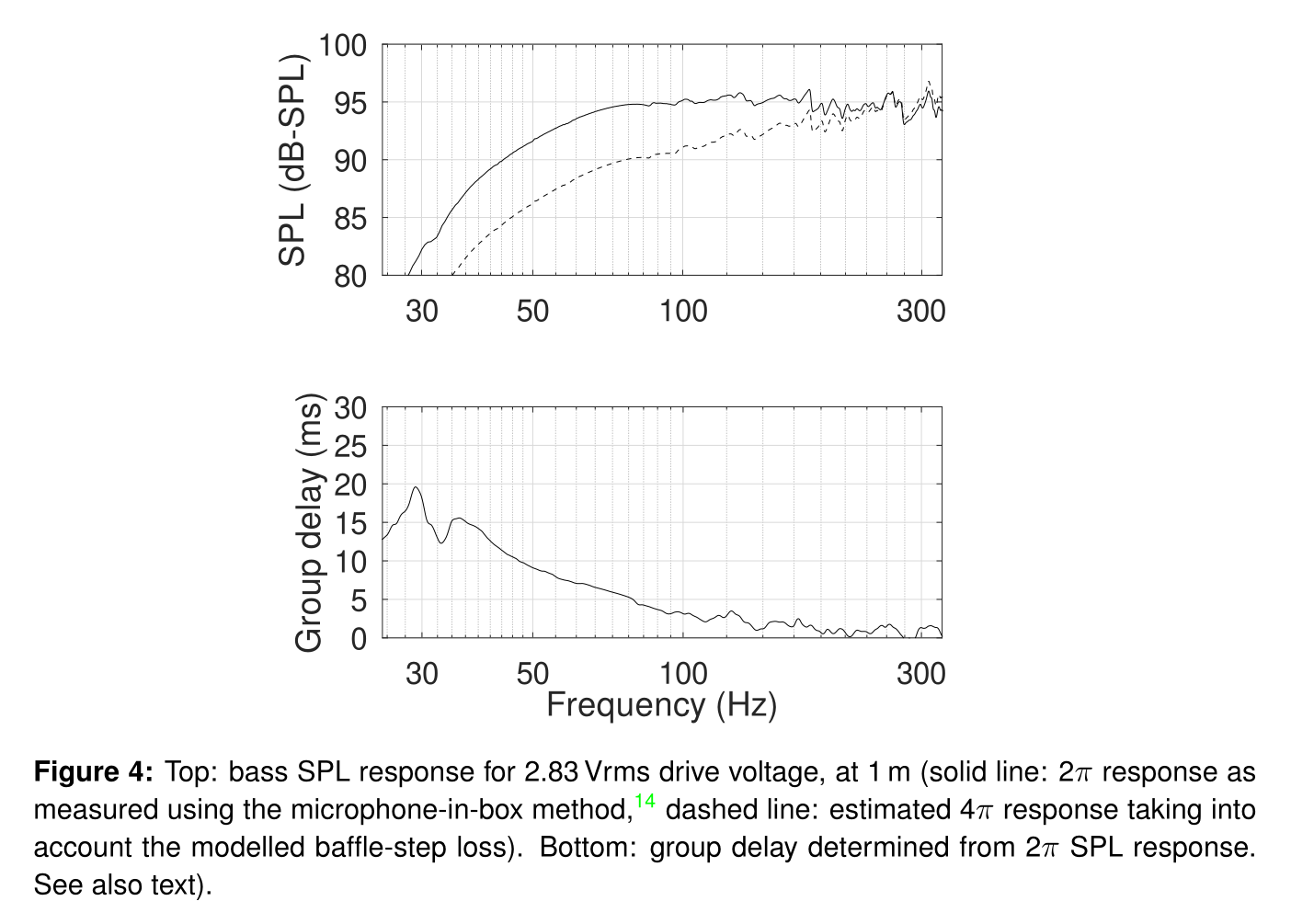

Take a look at Fig. 4 in the OSMC paper (also attached below). The measured SPL at 2.83V / 1m is approx. 95 dB-SPL for a 2 pi environment, which most people assume for in-room operation of a loudspeaker. In a 4 pi environment, it's closer to 90-91 dB-SPL (depending on which frequency you look at).
As far as I can tell, most manufacturers (or their marketing departments) tend to specify the 2 pi number because it's higher and therefore (and therefore "better").
