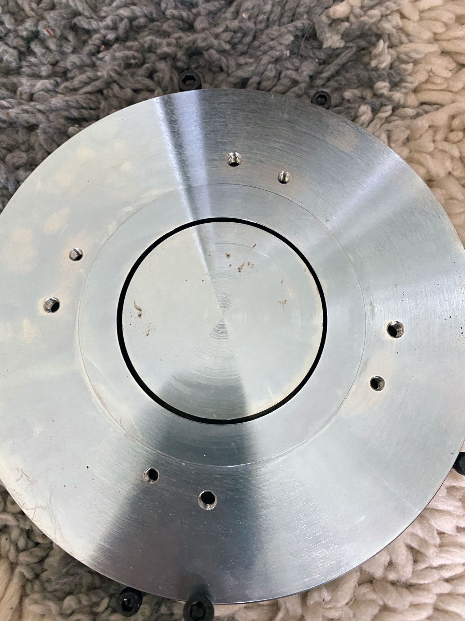

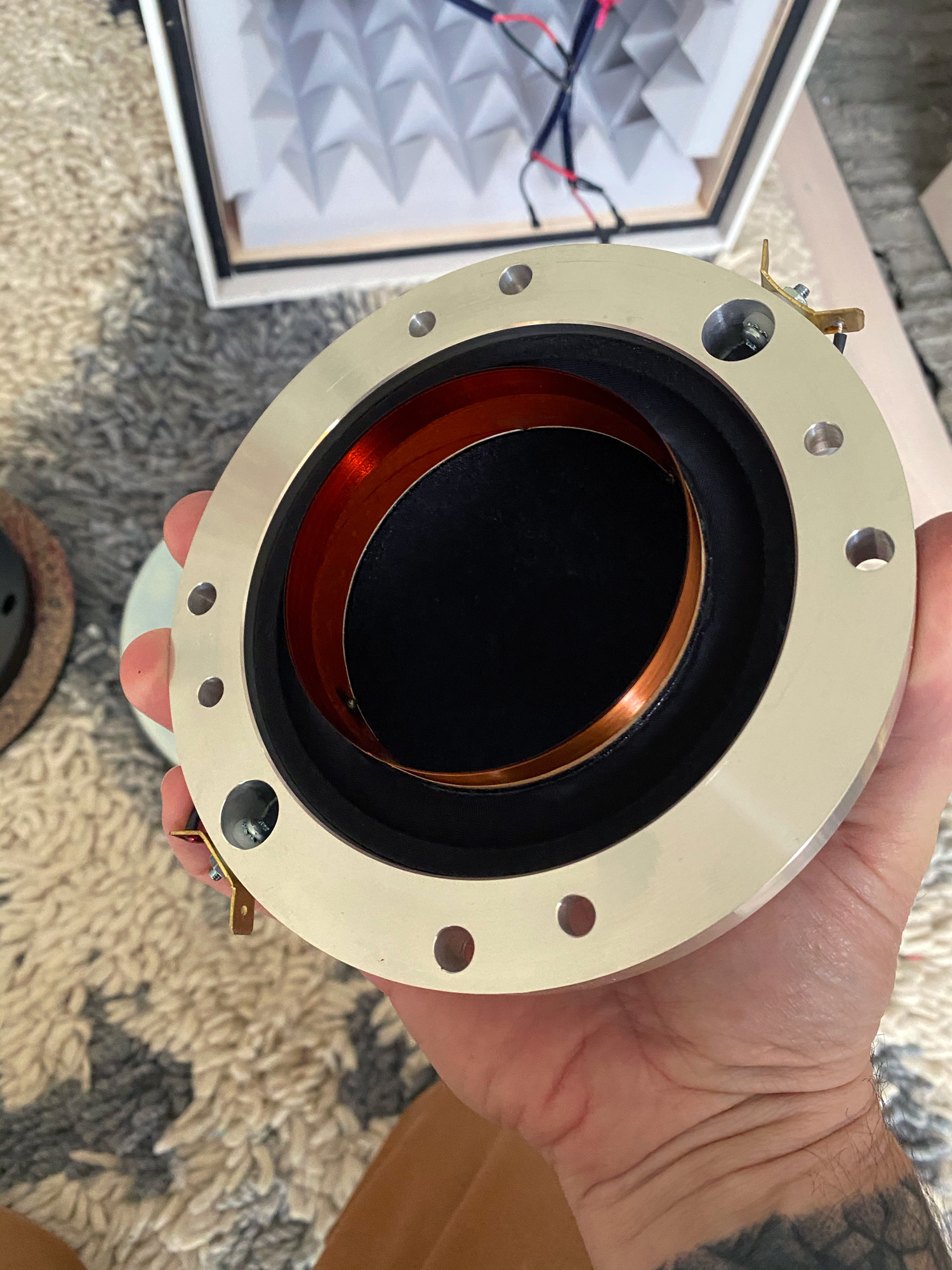

One night we became aware of some odd tonal vibration stuff in the speak we are using on the right channel. I was able to find a piece of music that really highlighted the issue—and tracked it down to the Volt mid. Basically at certain frequencies—say long horn or string notes—there would be a mechanical vibration that I could "fix" by finger muting the outside of the dome. Definitely only on one of the mids—and VERY noticeable and even in a low res video I made. Matthias and 6L6 said it was the voicecoil rubbing...
Sent the vid to Volt and Solen, their NA distributor where I bought them (outside Montreal). Volt passed the issue to Solen—who were very responsive and within about a week I had a new voicecoil assembly in my hands—self-aligning no less. Fixed the issue. I was in major music withdrawal about all of this! No serious music was making me nuts!
Everyone agreed that visually the "old" coil didn't look perfectly round. Not sure why we didn't notice it immediately—took the right music it seems at the right volume? You can see in the pics the tolerances.
