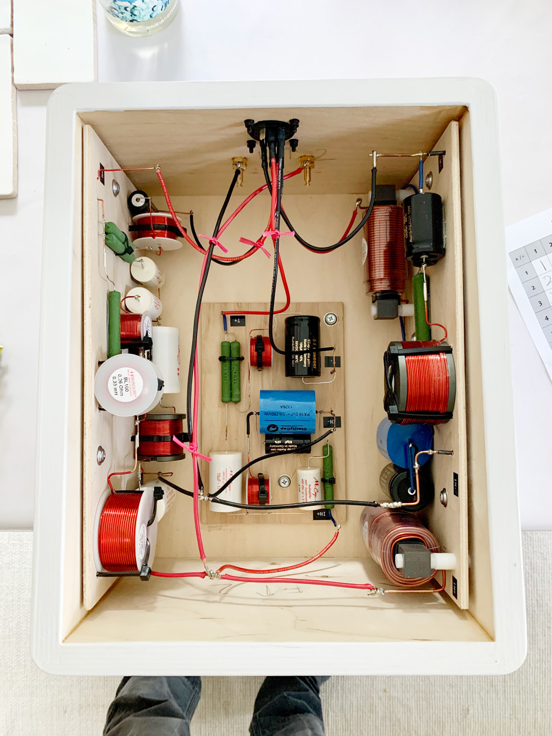

Well... progress at least. 😀 (SpeakON is sooo cool.) I didn't get a second pair of Input jacks. Not ready to bi-amp yet—so that would be a future experiment/upgrade(?). I did kinda keep the wiring locations prepped in that direction. (Still HIGHLY motivated to get these playing!)

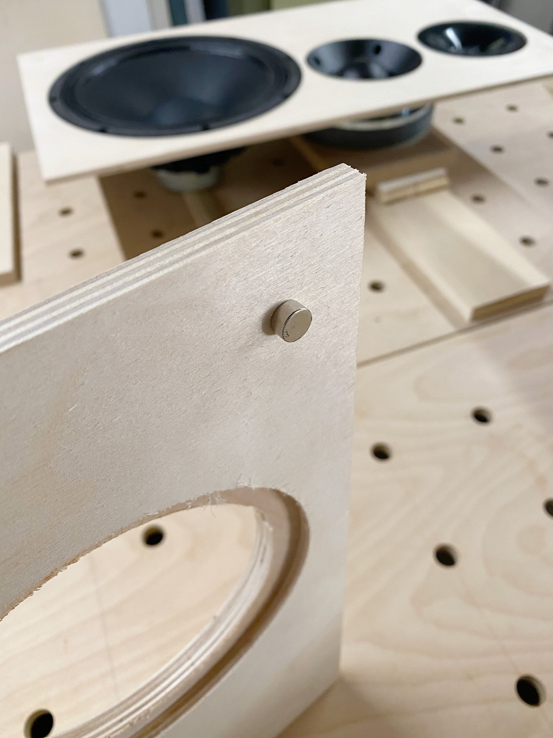

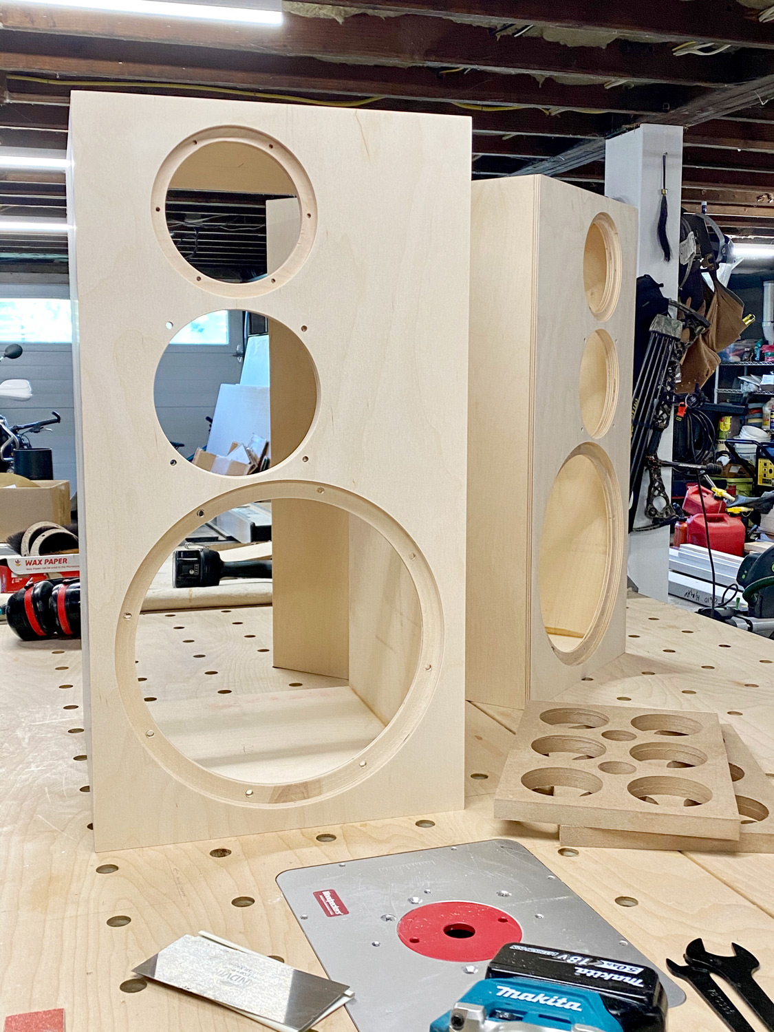

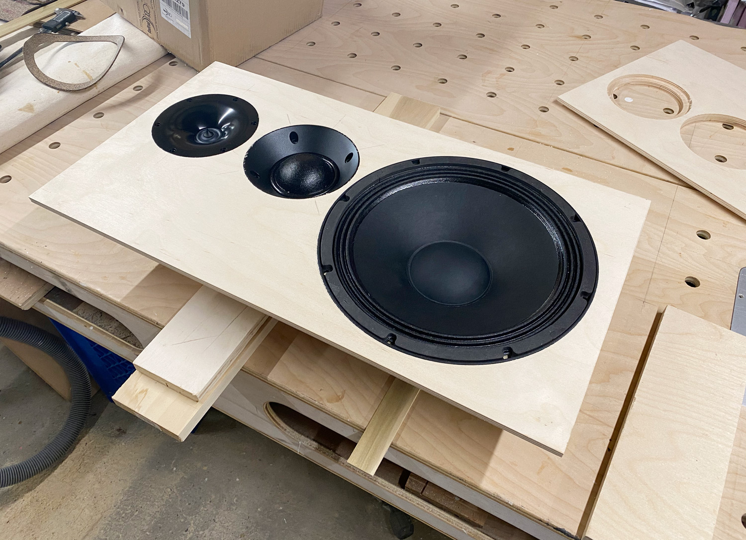

Baffles cut—drilling all the holes on the drill press before I attach them to the cabinets. I don't think I'm going to use a countersunk head/bolt for the Volts, not that fun to drill a clean no tearout countersink in ply—really needs a router—and I don't have that bit on hand. Going to use a cap head bolt. Won't be flush... but I think it will still look great. Speakers will be white... So it will all pop.

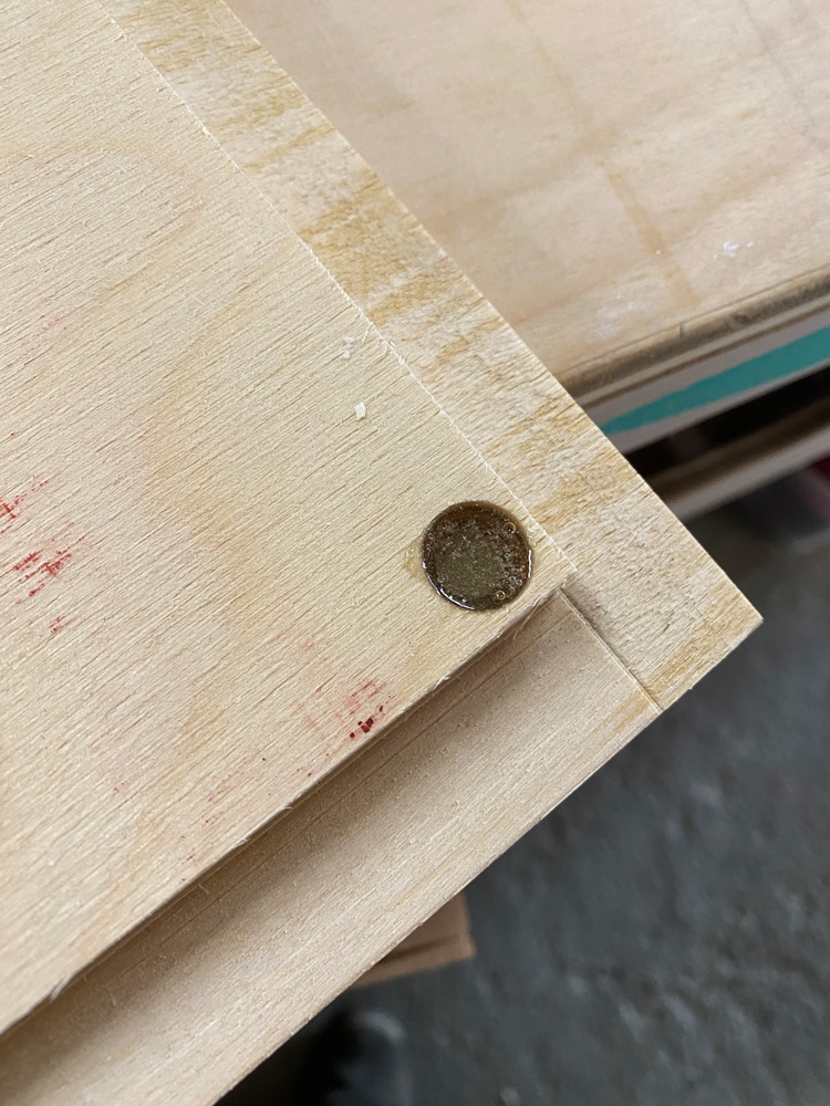

Also, magnets for grills.

I ended up drilling the bolt holes for the woofers off-axis from the cabinets—it seemed like due to the absolutely impressive massiveness of the Volt mid that it would be in the way of woofer attachment at the top when I mocked it all up, it looks like from Matthias's pics though that it would have fit "aligned"... hmmm... oh well. Call it a little wabi-sabi moment. In truth the woofers look to be designed for rear or front mount, or at least to have some sort of bezzle. They don't have the most "finished" appearance—only in contrast to the complete awesomeness of the tweeter waveguide....
Yes, the woofer holes can be aligned to the axis as shown on my drawings and photos. However, your way of alignment makes life a bit easier to install the drivers / screws.
Regarding the cardboard ring of the woofer, I was thinking of replacing it with something that looks better. Black anodized aluminium maybe? Shouldn't be a big deal to remove the cardboard ring. But then I got used to it as it is...
