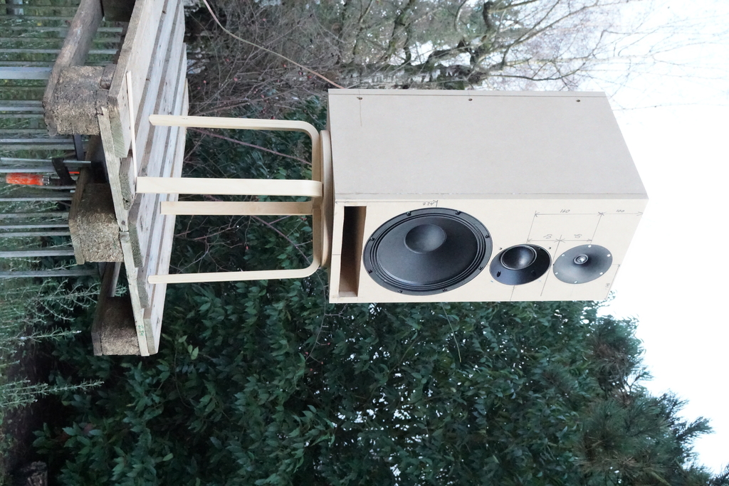

What about the bear containers...?
Just a quick flashback regarding my beloved beer crates.
I wanted to understand the cause for the large dips/peaks around 400 Hz. I replaced the beer crates by a stool (see attached photo) and repeated the outdoor measurements of the woofer (spoiler alert: there was no 400 Hz artefact with the midrange driver!). Indeed, the effect was less without the crates -- but it was not gone (black curves in attached figure).
Maybe a resonance between the bottom of the box and the palette (i.e., "inside the stool")? I kicked out the stool, which meant the box and microphone were now closer to the floor. With the mic at 200cm above the floor and 50cm from the baffle, I got a 10.3 ms long anechoic impulse response. This gives a frequency resolution of better than 100 Hz, which is still useful. The dip/peak was still there, no change (blue curves).
Maybe internal resonances in the Monkey Coffin box? I stuffed the port with a scarf (red curves) and voila, MUCH better! We'll have to deal with this resonance somehow. Hopefully, some damping material is all we need.
Ok, now that we understand the acoustics of my beer crates, let's go back to the discussion of the x-over for the Monkey Coffin!

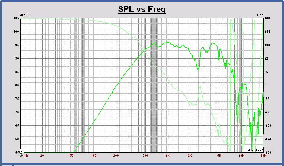

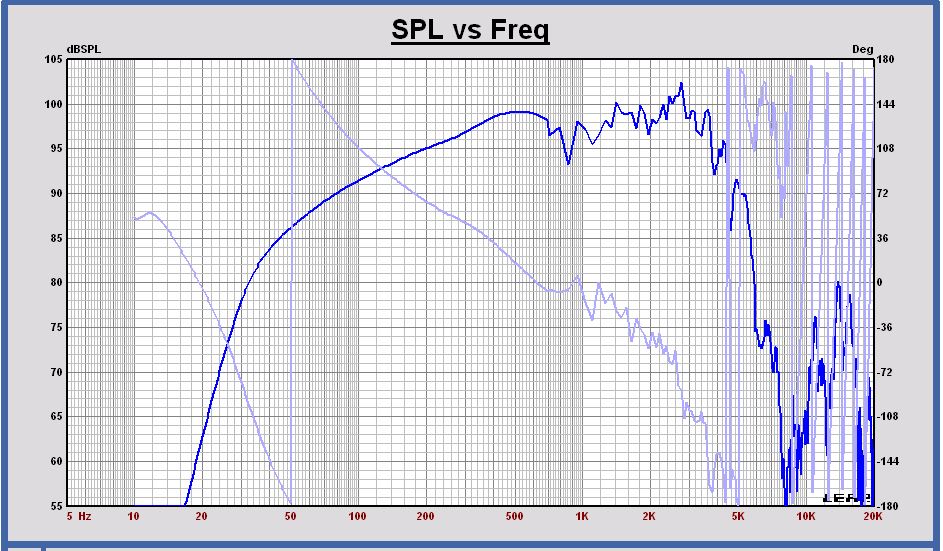

Here the update of the SPL frd's.
I have done a data splice now with the outdoor measurements of Matthias.
woofer spliced at 700 Hz
midrange spliced at 350 Hz
tweeter spliced at 500 Hz

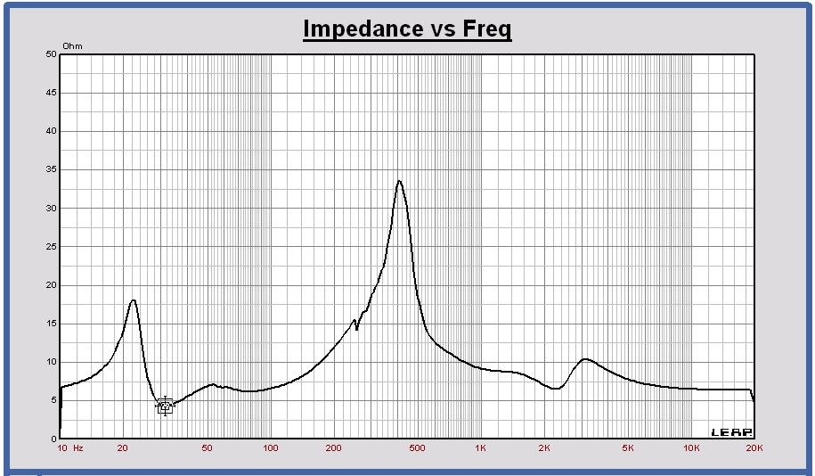

In attach plots and SPL frd. Impedance frd's can be found in post 479.
20181228 ScanR2904+WG148 MonkeyBox SPL 1m 0deg 2.83V.txt20.7 KB · Views: 72
20181228 Faital Pro 12PR320 MonkeyBox SPL 1m 0deg 2.83V.txt24.2 KB · Views: 79
20181228 Monkey Box SPL tweeter - splicing meas outdoors.JPG147.1 KB · Views: 428
20181228 Monkey Box SPL midrange - splicing meas outdoors.JPG141.8 KB · Views: 445
20181228 Monkey Box SPL woofer - splicing meas outdoors.JPG154.5 KB · Views: 442
Ok, now that we understand the acoustics of my beer crates ...
Good to know the reason of the 400 Hz resonance, that it is not caused by the beer crates ( and not the bear containers like I wrote 🙂 )

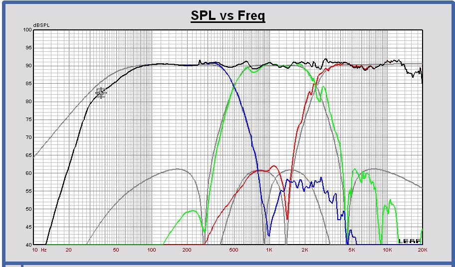

The less complex higher order filter is a 3rd order Butterworth filter.
For a third order elliptical filter for both xo points, 2 extra coils are needed (2 big and 1 small) and an extra cap in the tweeter filter.

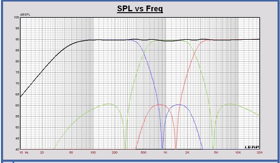

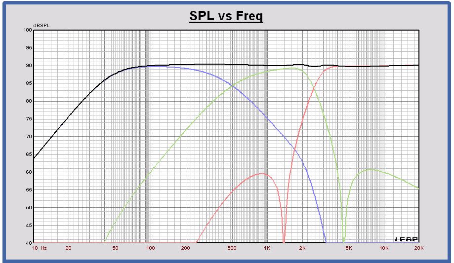

The combination 2nd order Bessel at 500 Hz and 3rd order elliptical at 2500 Hz (Kaffimann proposal) has IMO the disadvantage that the midrange SPL passband is not flat.
Comparing with elliptical 3rd order at both 500 Hz and 2500 Hz, the midrange is flat in the passband. Also the overlap zones are much smaller with the elliptical version.
In attach the targets of both concepts. As low frequency target, it is a 2nd order high pass filter at 45 Hz, Q = 0.7, just to have some reference in the target.

The less complex higher order filter is a 3rd order Butterworth filter ... The combination 2nd order Bessel at 500 Hz and 3rd order elliptical at 2500 Hz (Kaffimann proposal) ... Comparing with elliptical 3rd order at both 500 Hz and 2500 Hz
Just looking at the curves, I like how the elliptic+elliptic concept (second plot) squeezes out most of the VM752 dome goodness, with less overlap to the woofer. The sharp cutoff of the dome towards the tweeter may also help dealing with the baffle diffraction dip of the midrange at 2.4 kHz.

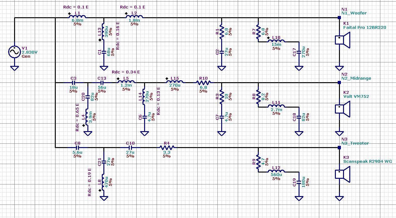

I am not so much into filter theory, and it would be useful for me to see a sketch of the respective filter schematics to understand how complex the respective circuits would be.

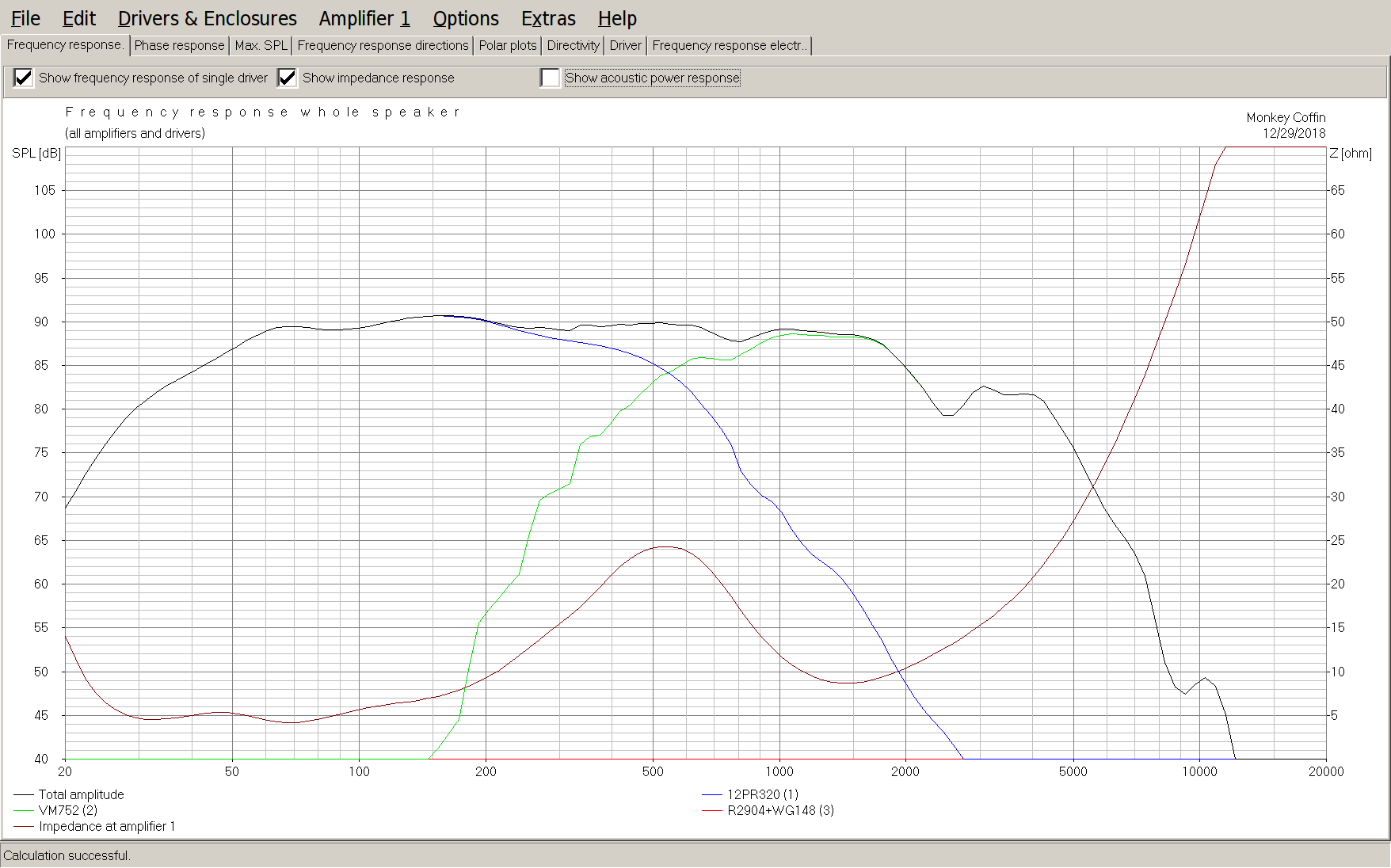

In the meantime I just impelemented the filter circuit of post 119 with no modification using the spliced SPL curves of post 511 using Visaton BoxSim (an older program which I found a while back, and it's simple enough for me to work with). Woofer and midrange only for now. The result is surprisingly good, given that this circuit was based on modelled SPL curves only.
I will prepare some practical schematics of Butterworth 3rd order (B3) and elliptical 3rd order (EL3). Then the complexity of both can be compared.

The EL3 targets I have created myself. I have tried to make SPL as flat as possible with an overlap zone as small as possible. There are also other EL3 versions, but these are my own. There is a little xo frequency offset on the low and high frequency part to make SPL flat together with that small overlap zone. The phase difference at xo is 20 degrees in this way. For the polar diagram it is a little worse than LR but better than the odd Butterworth.
EL3 has the same sound color as B3, but it plays with faster dynamics in the music, which gives a better life experience. Fast attacks in the music.
Exaggerating a little, B3 plays a little more lazy and enthusiastic than the EL3. Elliptic is much more fascinating. I don't want anything else anymore.
A friend of me plays now EL5, implemented digital. It is the same sound as EL3, but even more refined.
I did the same test with the LR4 filter of post 119 using the last frd's. Surprising good yes and the SPL curves were based only on the datasheet info.
Here we are, elliptical 3rd order xo at 500 and 2500 Hz.
Just a first design to show concept and complexity, not optimized, but already very good behaving. Not looked in detail to phase, off axis,...
Minimum impedance is 4.36 Ohm at 31 Hz.
This filter cannot be made less complex.
For a B3: L13 in woofer filter, C20 and L14 in midrange filter and C21 in tweeter filter can be removed.
Chosen air core coils with DC resistances for 1.4mm2 wire. The serial coils of woofer filter with core.
DC resistances of coils for impedance compensation can be higher of course.
In attach schematic, SPL and impedance response.
Ok, this has only a few more parts than the one in post 119, and most of them are in the parallel branches "only". I can hear some people complain about too much complexity, but it does seem okay to me. Let's look into this a bit more!
The on-axis SPL looks phantastic! I wonder what it does off axis...
Can the 31 Hz impedance dip be improved to get closer to the "8 Ohm" rating (6.4 Ohm min.)? How about making the impedance compensation of the upper bass-reflex peak a bit more narrow (higher Q of the LCR), and use a larger R in the LCR?
Why not using air core coils in the woofer filter with about 1.5 Ohm extra serial resistance and the air core coils are much better. But the SPL in passband will be 1 dB lower. Minimum impedance will become 6 Ohm. Maybe doing it like that, IMO the best solution. Changing LCR will affect SPL response.
In the final filter also a parallel LCR should be added at the input, to decrease the impedance peak at 400 Hz. For the tube amps with high output impedance. It can be optional.
