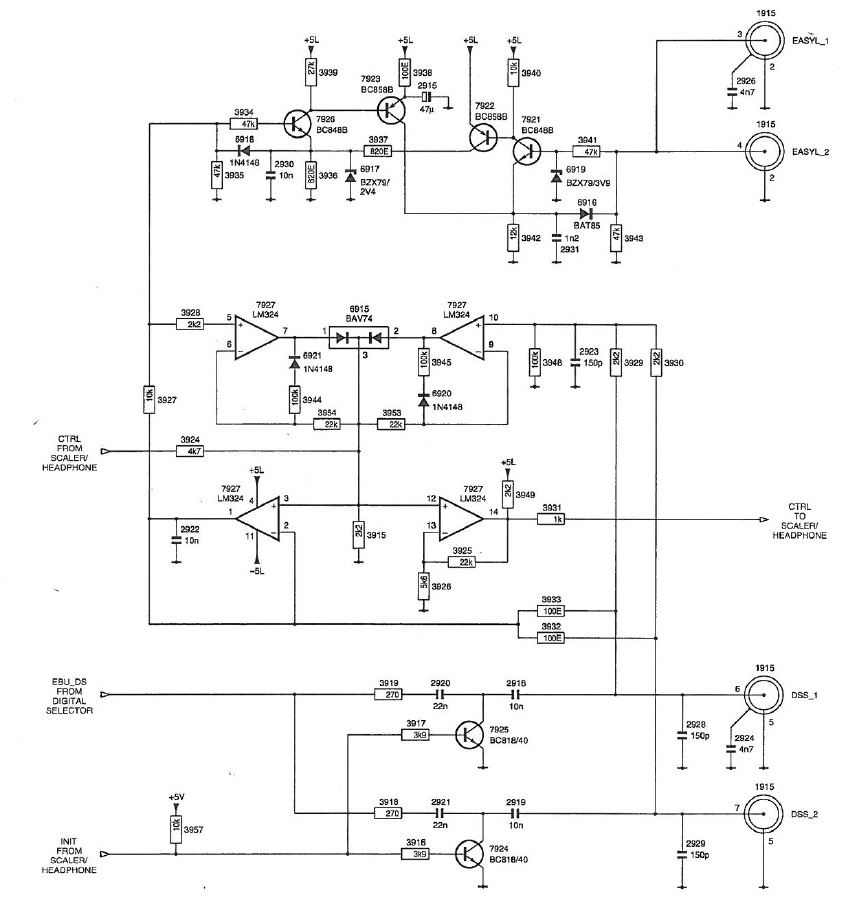

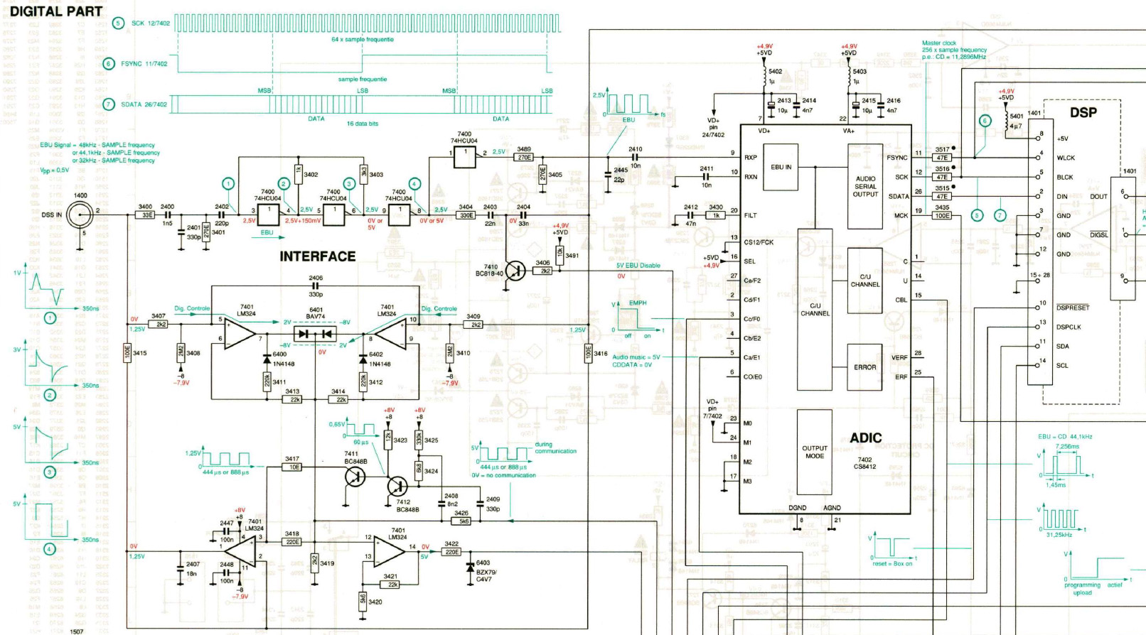

Is there a patent on the trick Philips used in 1994 in the DSC/DSS for superimposing a low bitrate serial channel on the SPDIF datastream ? This was needed for conveying the listening volume setting. See the attached pictures.
