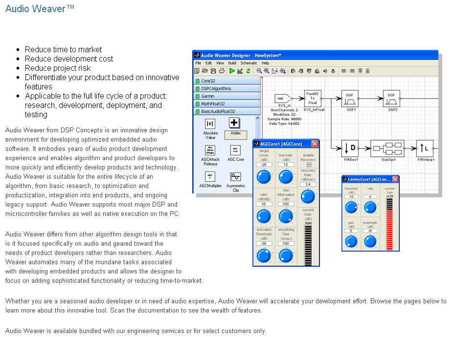

This present thread is about Open Source. You may want a kind of poor man's DSP Concepts Audio Weaver, in Open Source.
Audio Weaver? | DSP Concepts

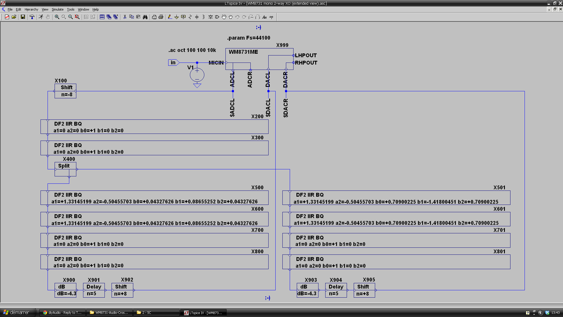

Look the screenshot. You see those blocks and those interconnections ?
Generate the schematic using LTspice. Create parts using LTspice. Interconnect them.
Relying on LTspice, there can't be bells and whistles like user-friendly configuration panels. As example, you'll need to edit the AGC or Limiter parameters using plain text, double-clicking on the part.
Grab the netlist from LTspice, in text format.
Deliver such netlist to a DSP board.
You are done.
Of course you need some DSP bootloader, operating system and scheduler running inside the DSP board. Such is the difficulty.
You are done.

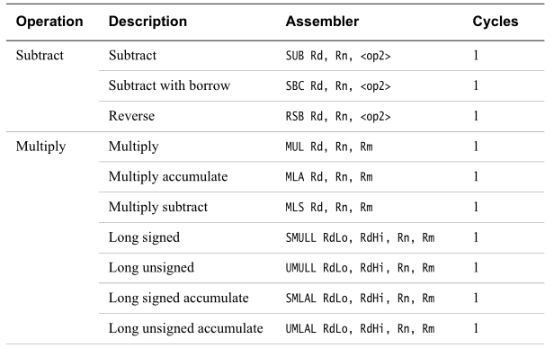

Don't both parts use 16 bit multipliers and SIMD to execute a 32 bit multiply ? Neither execute a 32 bit multiply in one clock cycle.
From ARM's Technical Reference Manual for the M4 :
Is that for a 16 bit multiply or 32 bit ? Apparently its floating point performance apparently is not that good,
DSP operations can use either floating point or fixed point format. The Cortex M4 core has optional hardware support for 32 bit floating point, but is not optimized for DSP algorithms and too slow for most DSP applications.
Trevor, arm_biquad_cascade_df1_q31 and arm_biquad_cas_df1_32x64_q31 are built around SMLAL. You can find specifics in the links and a bit more context on the DSP requirements in this post, though the questions you're asking would be best answered by spending some time with the instruction set and DSP library documentation for the respective processors.
32bit which can generate either a 32bit or 64bit result. There's no 16bit multiply though from memory there might be a dual (i.e. in parallel) 16bit multiply instruction.
Where did you get your quote?
